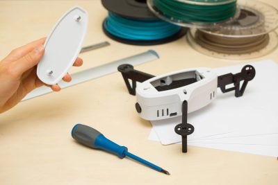

Highlighting cost, prototyping FDM is the cheapest way to produce proof of concept components. FDM is ideal in most cases if you want to see a basic physical manifestation of your product in the real world. However, it’s not ideal if you care about surface finishes or need moving parts.
Prototyping SLA is a bit more geometrically flexible than FDM and it comes at a similar price point for smaller batches of prototypes. SLA is good at producing organic shapes, and designs that work well with SLA tend to scale to injection molding.
Both of these 3D printing technologies work really well for producing plastic models that not only give you a clearer picture of what the product may look like several iterations from now, but also provide your sales teams something to show early clients. How you use the initial prototype is up to you, but it’s good to remember that you can take the first prints out of the R&D labs and put them into clients’ hands.
Choosing between FDM and SLA comes down to what kinds of geometries you’re going for, as both will net a cost-effective price tag. Definitely avoid metal 3D printing (DMLS), as it’s only really good at making parts that can’t be made any other way. So you’ll struggle when it comes time to start machining or molding designs previously produced by DMLS.

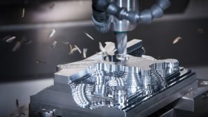

Functional prototyping is more demanding when it comes to part sourcing. A functional prototype should prove whether the design solves the issue your product is intended for, and give you a good indication of the future return on investment of the design. What you assemble has to function almost as well as the final product should.
So for functional prototyping, you still want to get parts made fast and mostly from the same materials, but using higher caliber processes and technologies. SLS and MJF become more viable at this stage, as does CNC machining—unless your final product is polymer-based, this is when you start using metal components.
For functional prototyping, we recommend using Protolabs Network's fast, local offering, leveraging CNC machine shops within your custom clearance zone. Parts may be a little more expensive than those sourced overseas, but you need far fewer of them at this stage and the time saved will quickly balance out any extra euros spent on local speed.
