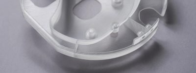

Transparent |
Glass-like appearance
Can be post processed to 100% clear
