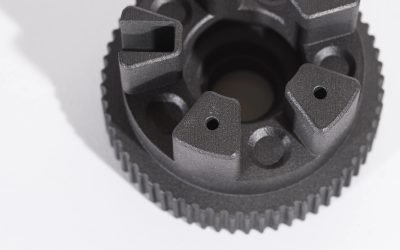

An SLS part, printed in nylon

Similar to SLS, the printed parts are embedded in powder and need to cool down before they can be removed for further processing. For more detail on MJF, read our breakdown of the technology in What is Multi Jet Fusion (MJF)? Explained by Protolabs Network.
An MJF part, printed in nylon

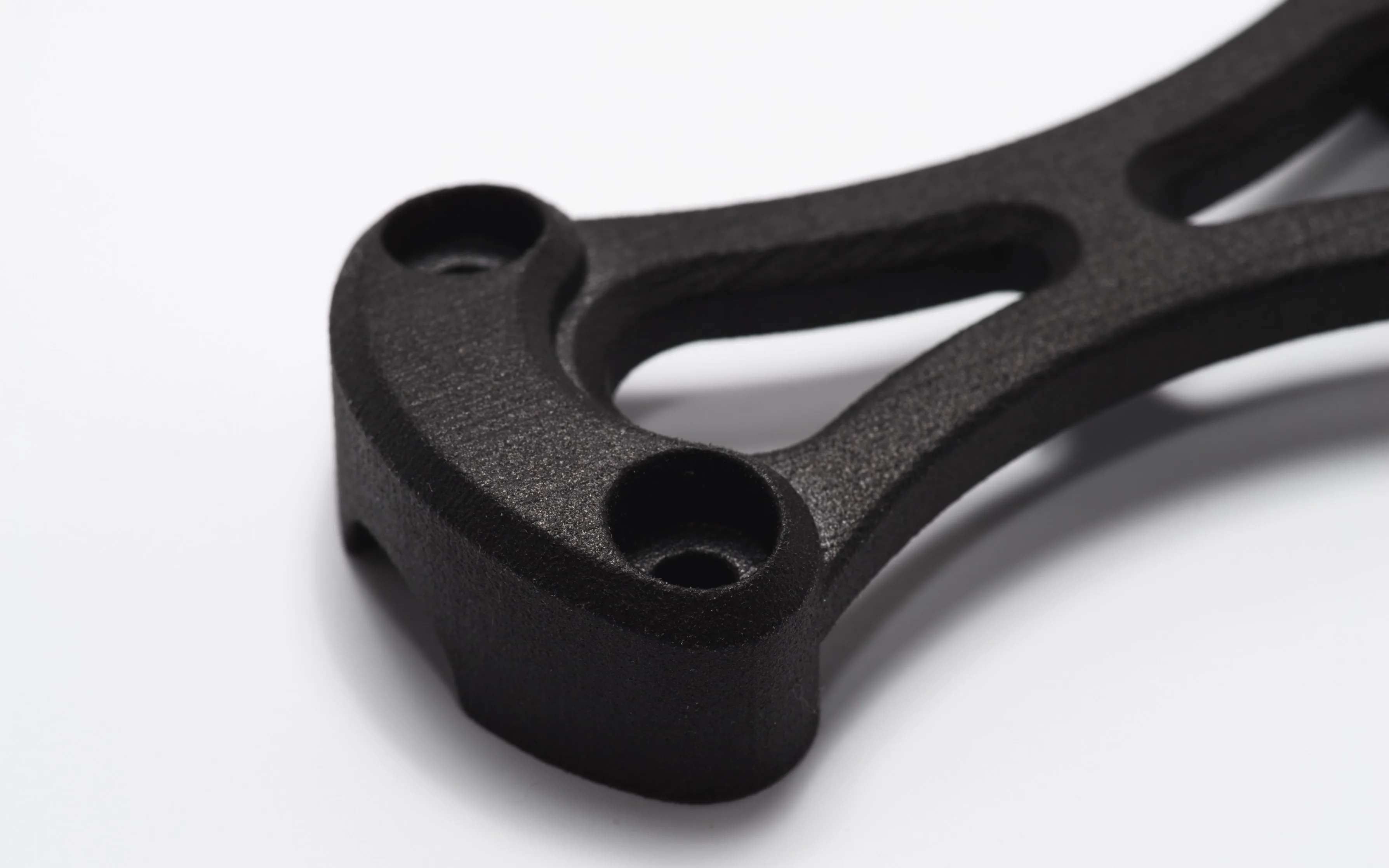

An MJF part, as printed
An MJF part, after dyeing black
