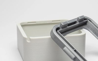

3D printed part with a cantilever snap-fit
A cantilever snap-fit on a 3D-printed enclosure
