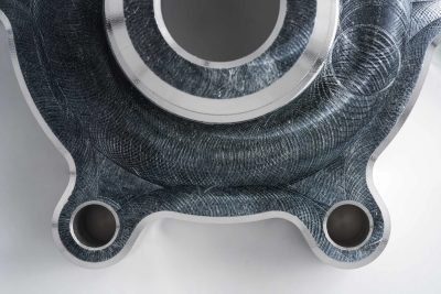

What degree of roughness do parts left “as machined” have?
Ra 3.2μm / Ra 126μin. Find out more.
