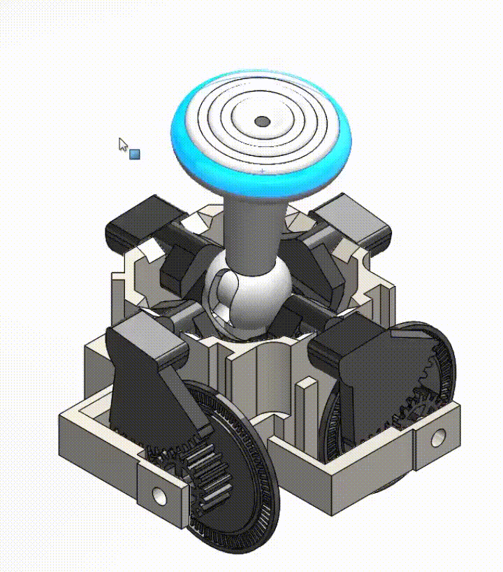

This entire process from measuring to CAD files took around 3 months to complete, an especially impressive feat since Nam had only taken a basic introduction class to 3D modeling prior.

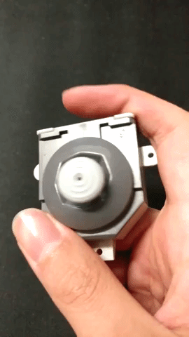

Whilst simulating the components working in Solidworks Nam found that the main manufacturing flaw in the controller was that the entire joystick assembly would wear down, causing failure. Nam breaks down the assembly:

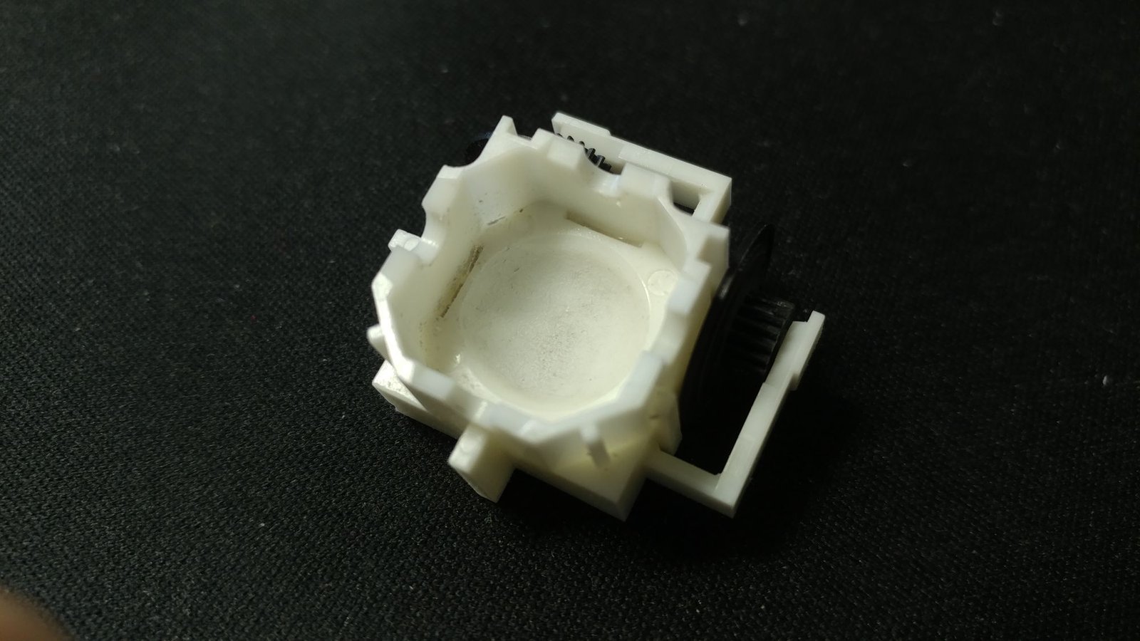

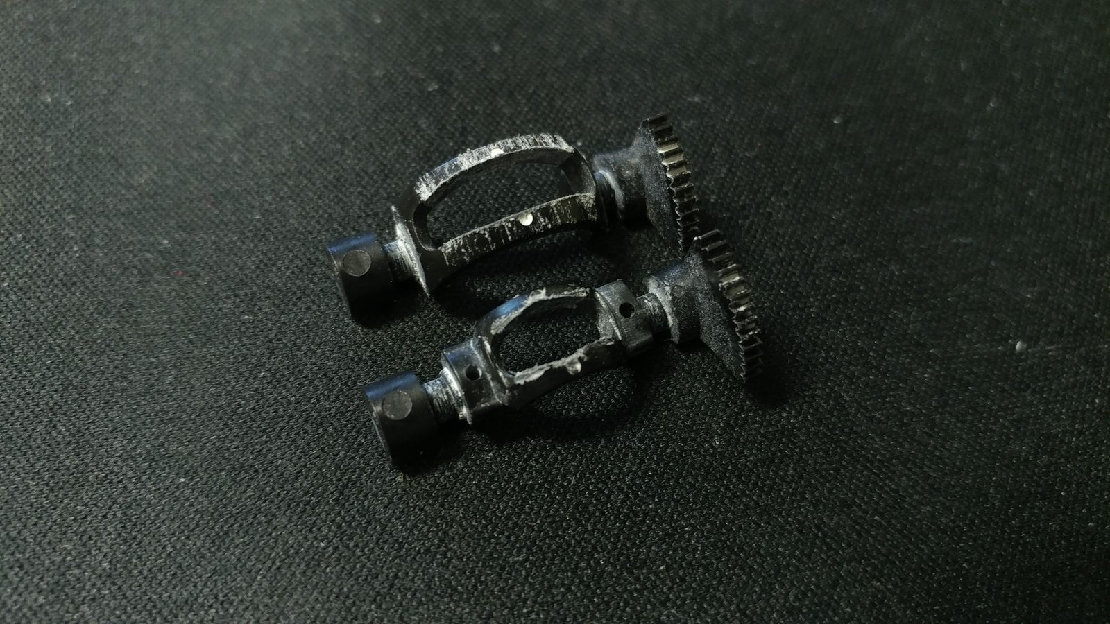

This assembly was made of three key components the gears, stick, and bowl. The gears wore down from the mating surface of the stick, the bowl wore down making the joystick offset from its main axis and the stick itself would wear due to abrasive dust.

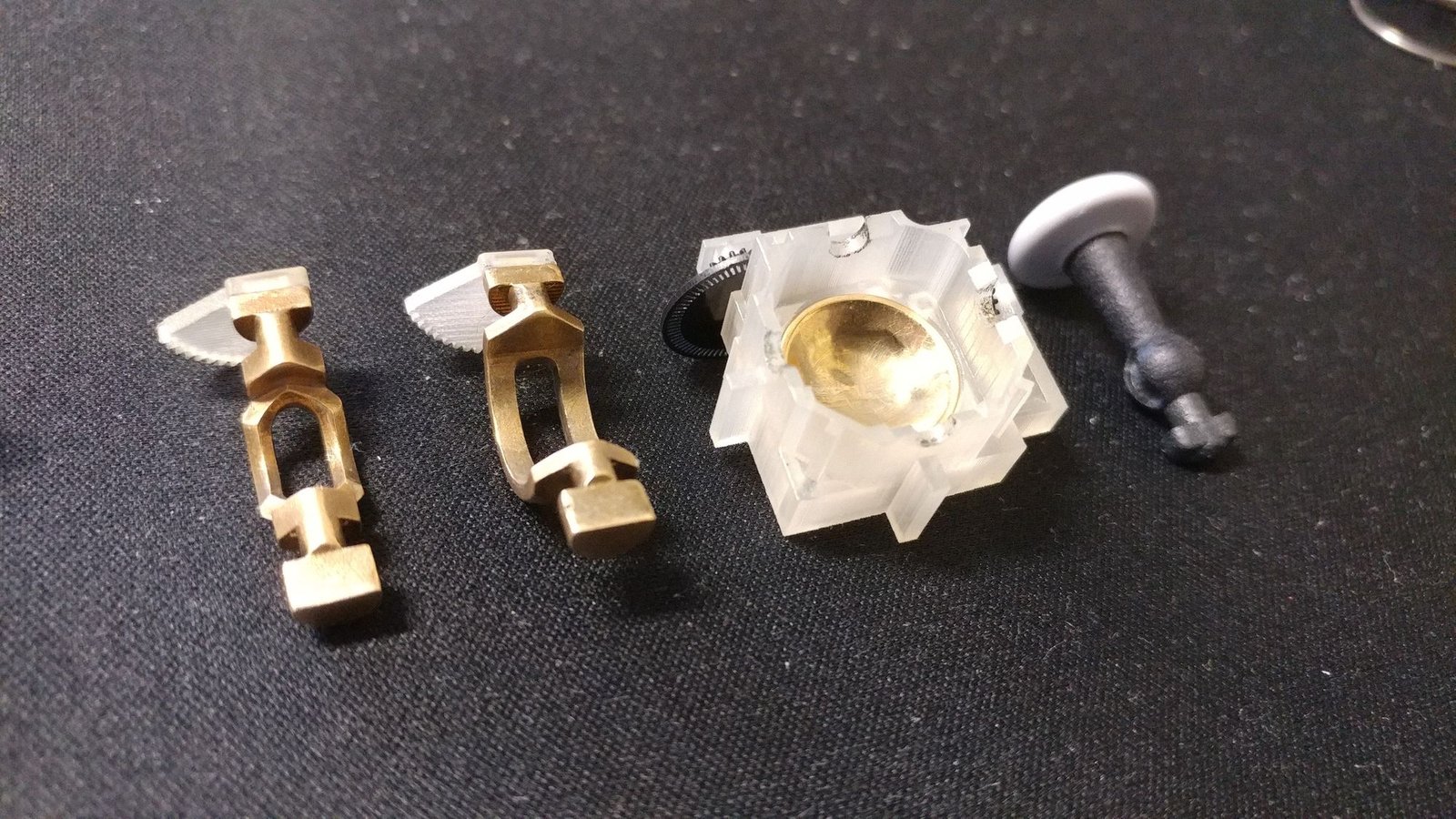

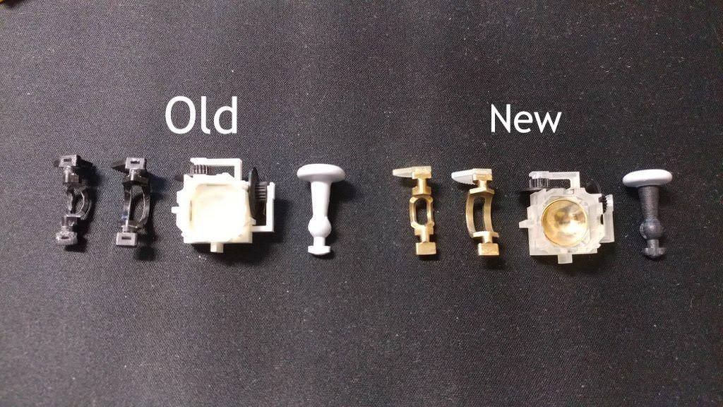

With this in mind, Nam focused his attention on making the new components as sturdy as possible with an option to easily replace the joystick (the central point causing the other components to break). The next step was the material selection and finding a manufacturing process for custom production.
3D printing was the obvious choice for manufacturing. Its the only method that allowed Nam to develop the idea iteratively whilst being affordable. The materials and processes available also allowed for the creation of small highly detailed components and components with high hardness.

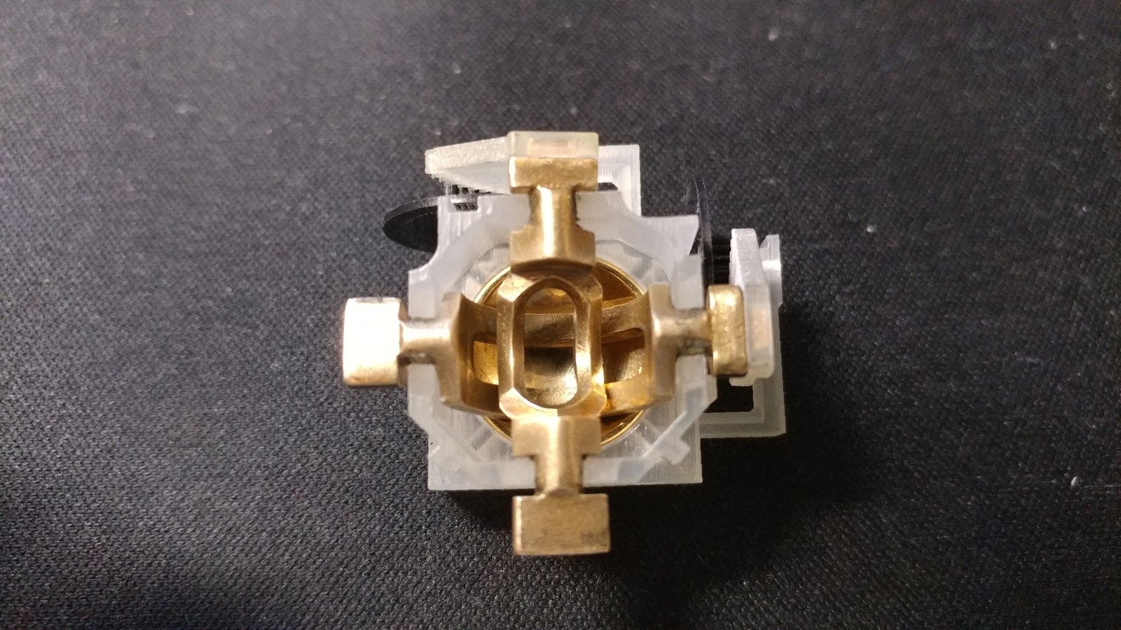

The gear teeth were made from Visijet M3 Crystal material thanks to the high detail that could be achieved. The main body of the gear was made of brass using the lost wax casting method using 3D printing. Like the gear teeth, the Visijet M3 Crystal material was used for the housing since it would have been too difficult to cast the whole bowl by itself. Again the main bowl is made of brass like the gear body.

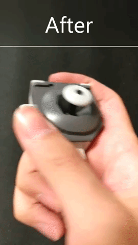

The redesigned stick was made of nylon (PA12) using SLS technology. Nylon was used since it is not as hard as the other brass parts. Nam explains his material choice further:
Generally, harder materials won't be worn by materials of a lower hardness. The result is having only one part wear compared to every old component wearing. Every once in a while the stick will have to be replaced, but it takes a longer time to wear and is a better cheap alternative than buying a new controller.

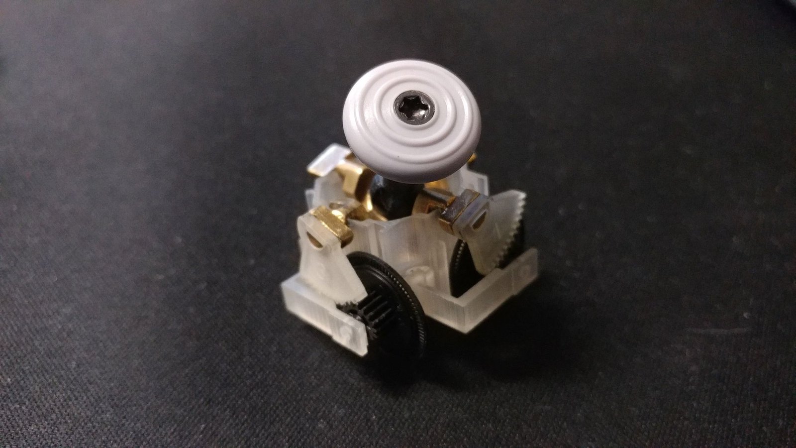

Nam’s current prototype has already last 100% longer than the original Nintendo controller, with 6 months already through with no signs of breaking. The gaming community at large has taken to his idea with pro Super Smash Bros players wanting to test it and the controller being deemed tournament legal.
