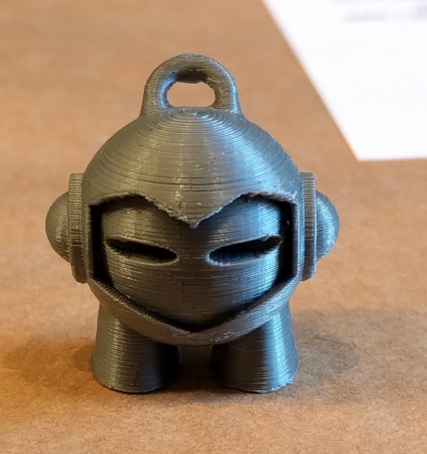

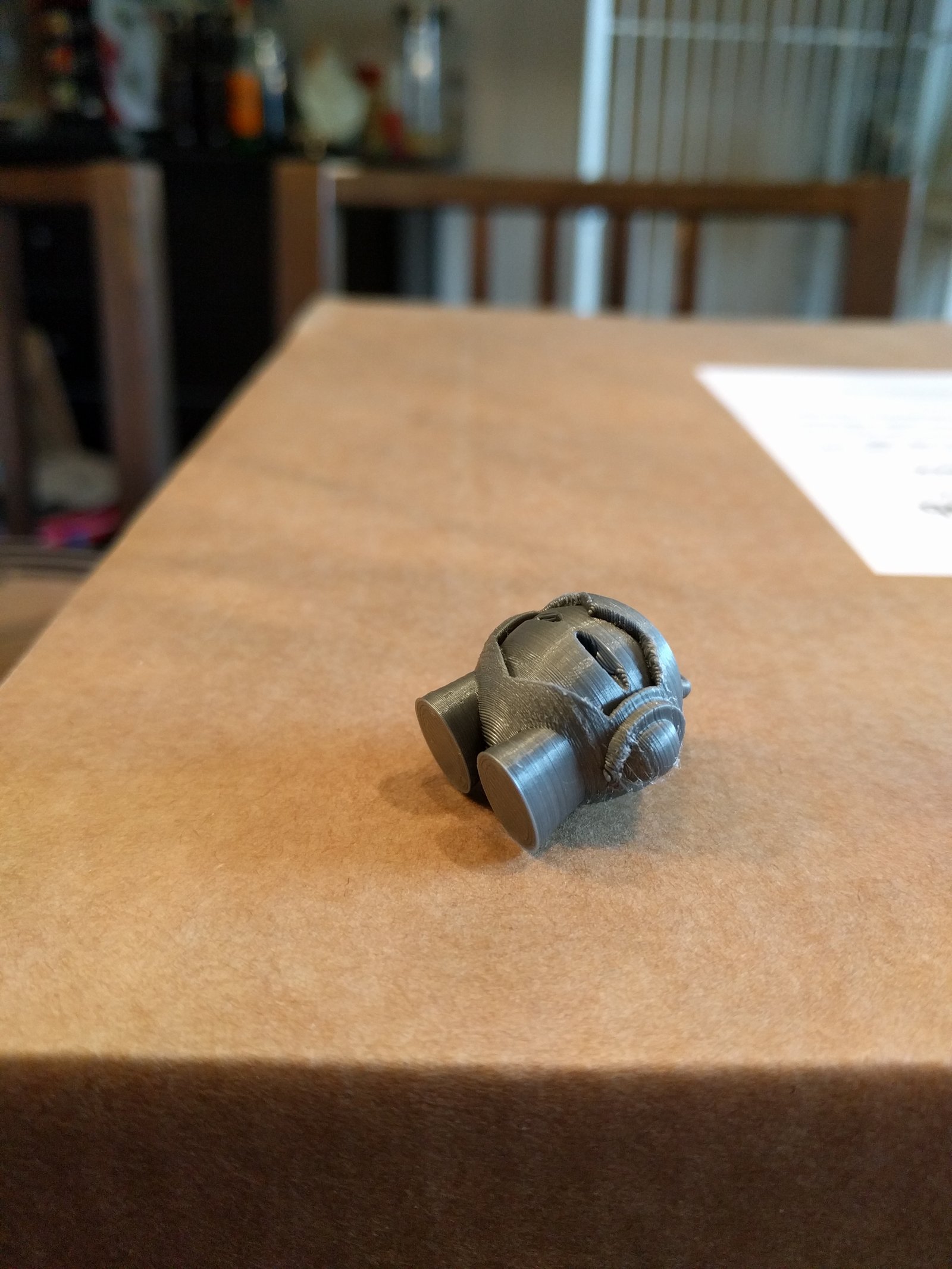

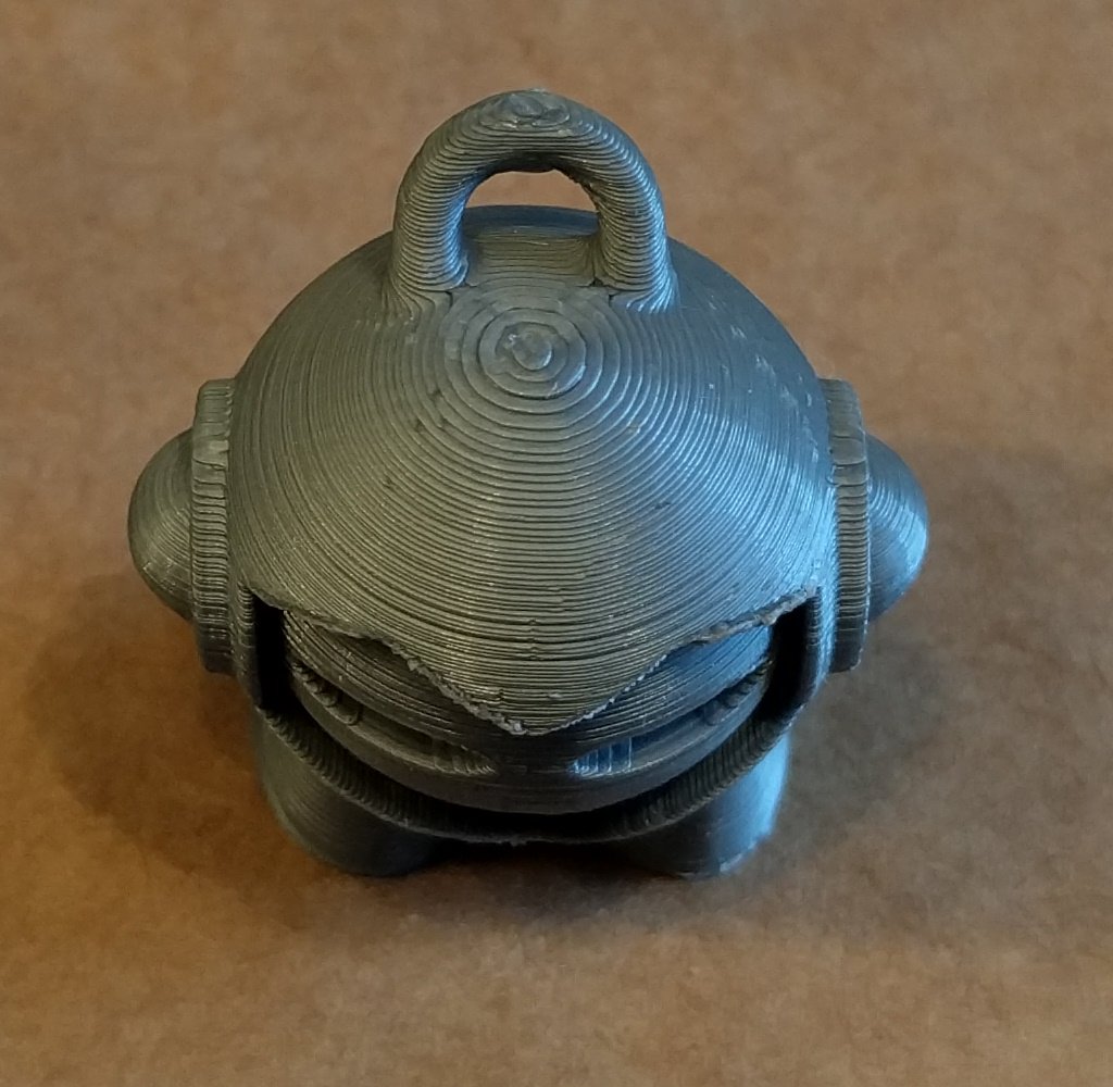

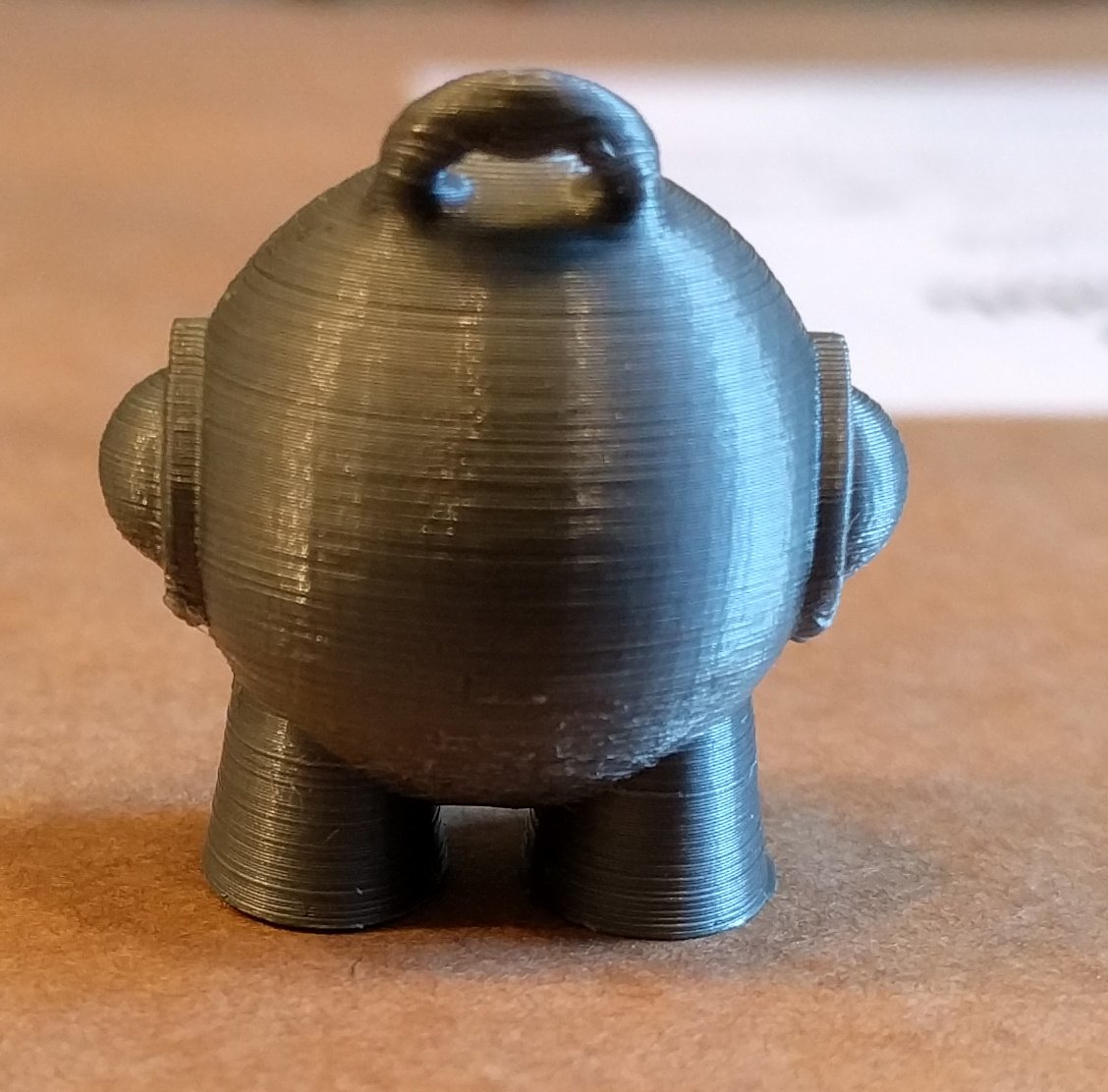

Ok so I tried printing Marvin that came on the SD Card. It still not as good as it should be…
Printed with 100 microns
Hi Bavilo, I also had those issues and what I ended up doing was buying the silicone socks from e3d and did the PID tuning with the sock on. After that it came out perfect :slight_smile: It has to do with the temperature deviation being to big… Here is a link to a video explaining how you can do it: E3D Silicone Sock on Original Prusa i3 MK2 + PID Tuning - YouTube
Try is with the silver prusa filament and like wirlybird said, play with the temperature. Printing speed for a marlin should be around 20-30 mm/s :wink:

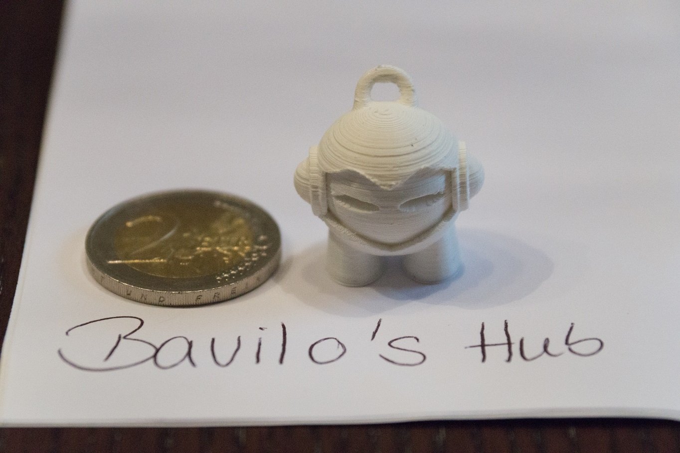

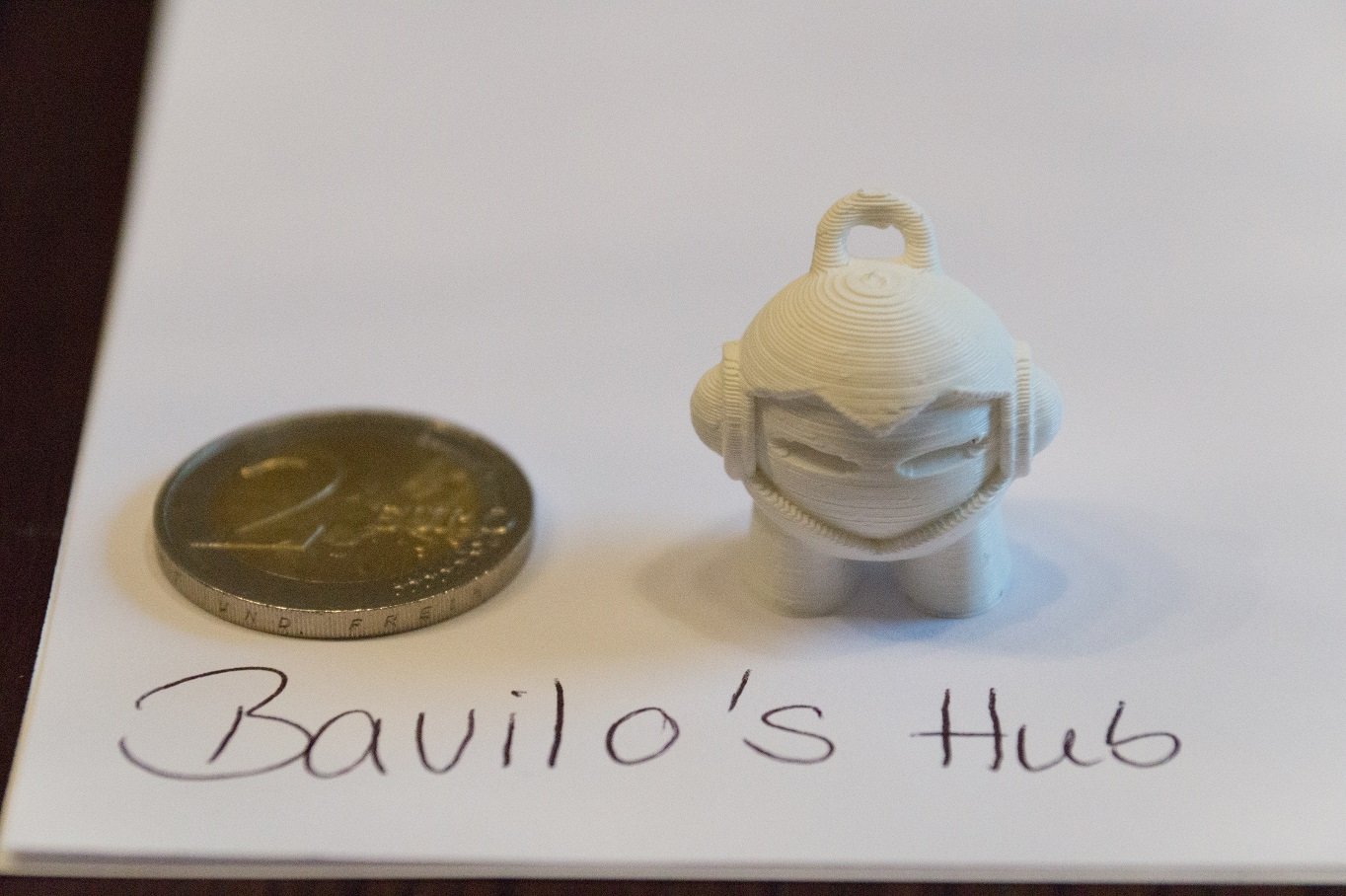

Ok so here are my latest prints:
200 microns looks good. 100 is still screaming for improvement. Is it still printing too hot? This was 205°C
My first layer is fine.
I haven’t used slic3r much, but is there a minimum layer time? It looks kind of like the layers aren’t having much time to cool. Try printing one with a cooling tower next to it (print a Marvin and a simple small cylinder at the same height as the Marvin) at the same time and see if that helps. It also looks like you may have some z wobble. Make sure you y and x belts aren’t too tight, as that can cause the same issues. Print a 20mm calibration cube with low infill and extended in the z axis to 100 or 200 as well. This should give you an idea if you have z wobble around a certain height. Once it’s done if there is ringing around 110mm you know that something goes wrong at that height. I had an issue where my smooth rod for the right side of z was a little bowed, and at 140mm it bowed inwards, causing the x axis belt tension to get thrown off, causing some issues. Let me know if any of this helps.
What speed are you printing at? Maybe try slowing down a bit?
