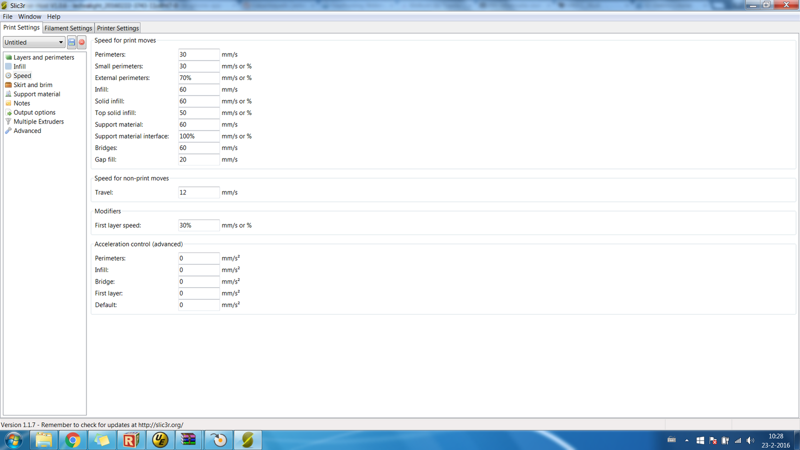

These are the speed settings for 0.1mm
For me this looks quite normal. Try switching to 100 microns and maybe try a lower temperature.

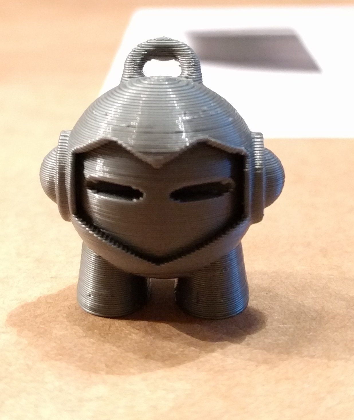

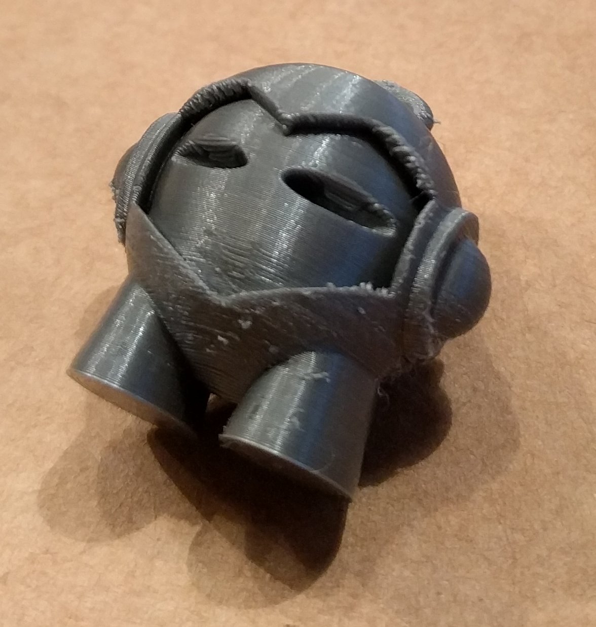

I have finished another 200 and 100 micron print. I believe 200 microns should be good to go now. 100 microns is still weird.
These were printed using the default settings from Prusa Slic3r preset. Temperatures for both are 195°C / 60°C. For the 100 micron version I even included a wipe tower…

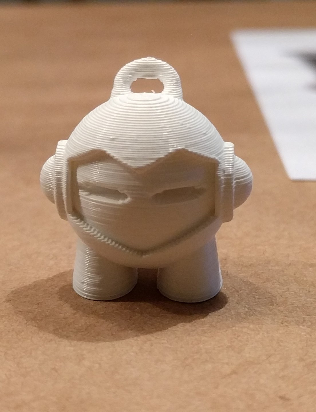

I think the white colorfabb pla looks good too using the same settings…

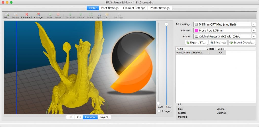

I did not read through all the replies, but I am having the greatest success using the Prusa’s Slic3r version.
I used the recommend settings for the most part. For Marvin, just select detailed.
Also, on Printer: Settings → Mode – > High Power
Settings → SD Card → Normal
