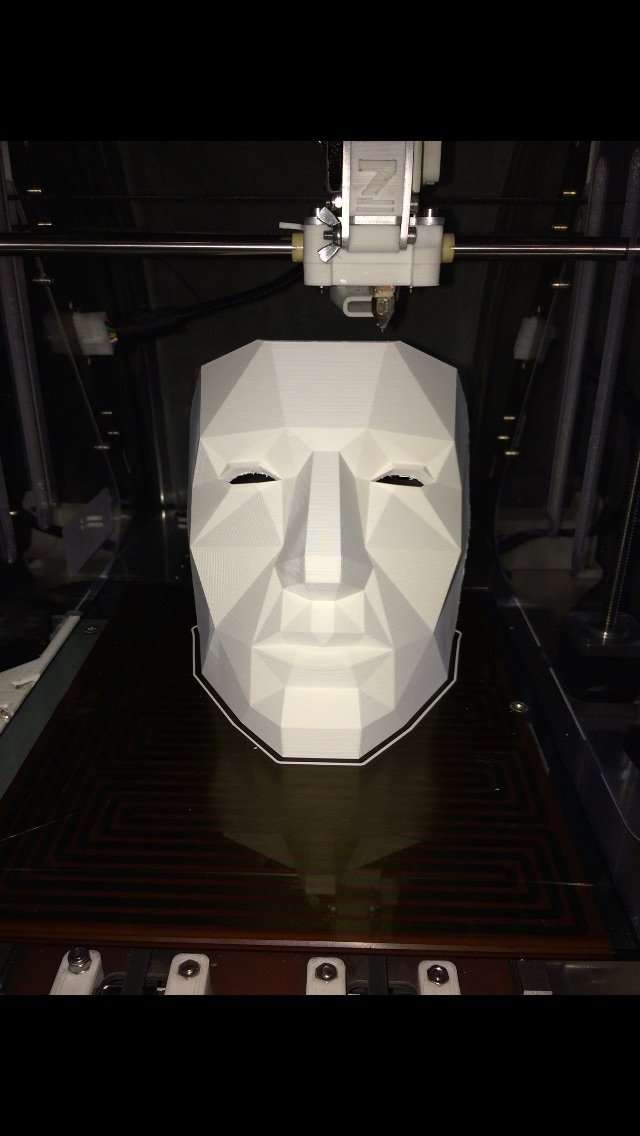

Have you seen the ugly printed wolf that comes with ZMorph?
Maybe we have different understanding of what a good FDM print quality is?

Yes ,actually we are also authorized re seller of Zmorph in Greece , yes is a very good machine and with open software , voxelizer give you the freedom to experiment with a lot of different materials, the good for me is that is a workhorse we use it everyday with no problems and is very easy to service it cause of the open design of it

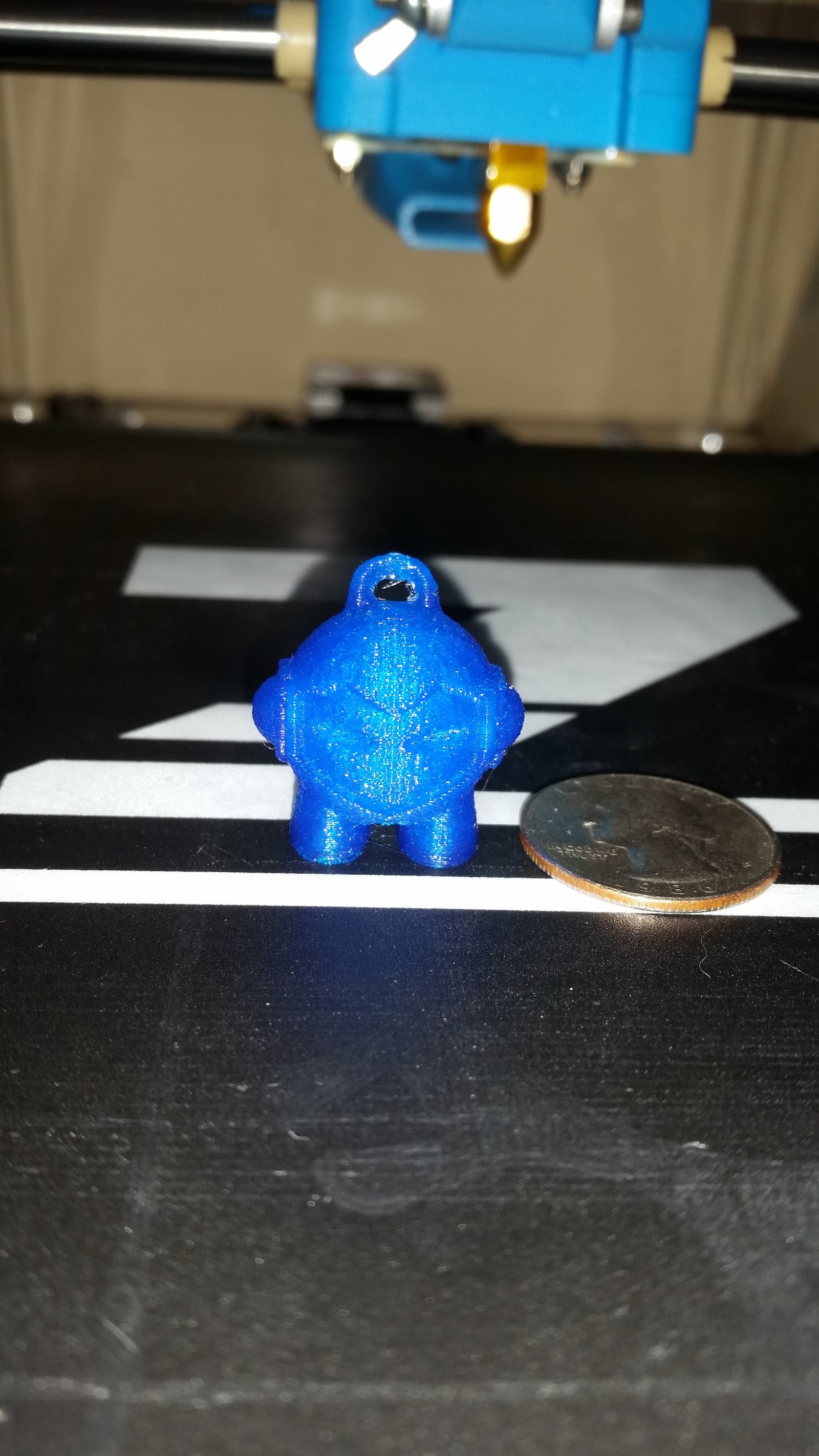

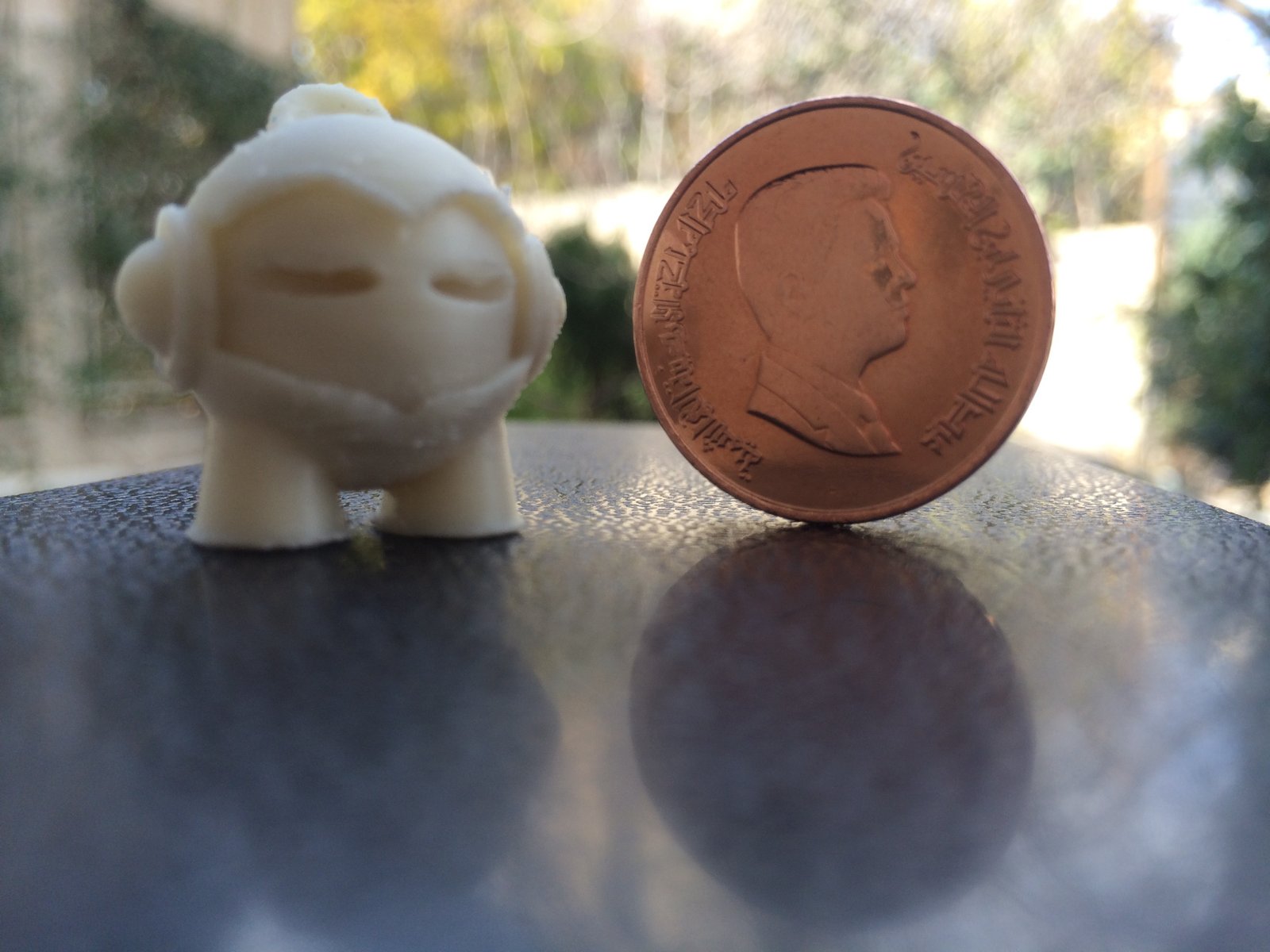

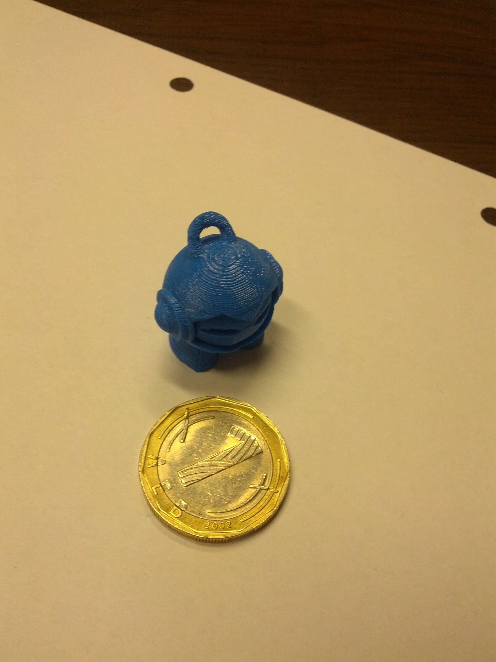

I’d love to see a nice ZMorph Marvin
Will you share one with us?
actually we have also a zortax that has very good results …but is closed and works well only their filaments , about the wolf is like these to show the voxels concept voxelizer use a different approach of slicing he is making voxels , I will print the Marvin in zmorph and show you the result
i will
Woop, woop! Looking forward to it
Cheers
