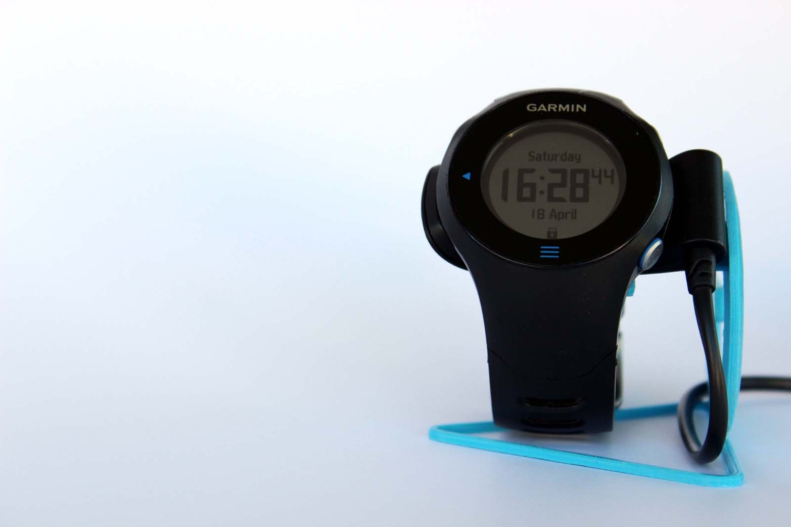

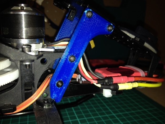

I started with a very straight, simple component for my RC helicopter, and now I have created a watch mount that is not only balanced to support the watch but has multiple curved surfaces offering functionality and a cool design to compliment my Garmin watch

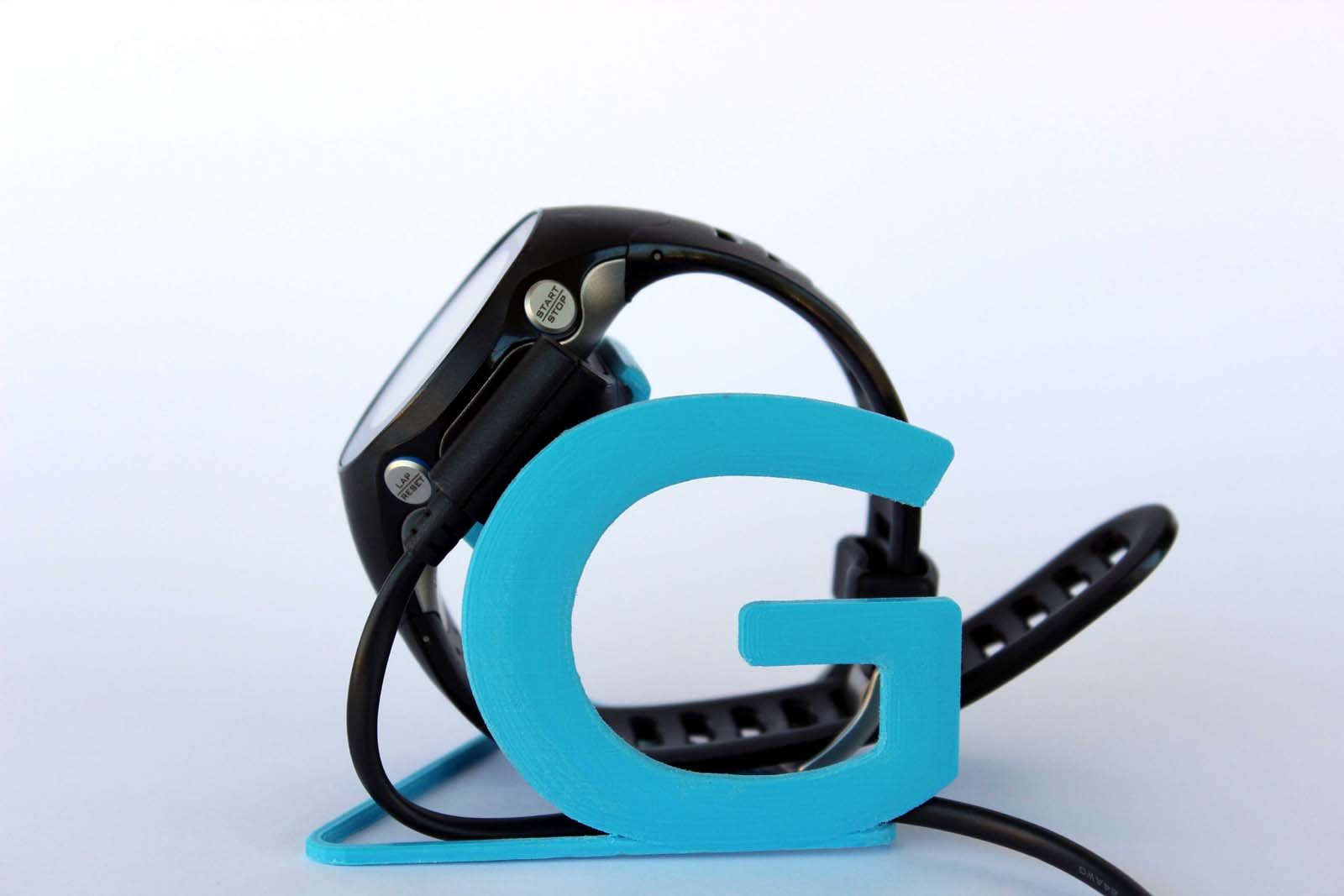

I wasnt happy with plugging in the magnetic charging cable each time and simply leaving it on the bench. I wanted to place the watch onto the stand, have the time visible and have it sit there on display waiting for its chance to be worn again.

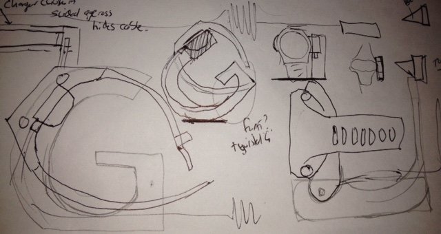

First of all, Sketchup can consume your life. The time spent drawing can be extensive and sometimes frustrating. So, the key is to draw your design first, measure everything as accurately as possible so when you start building your object on the computer, you already know what you are trying to achieve.

Once you have the STL, upload it into 3DHubs, select your town, choose a Hub, material and colour. Pay attention to the quality of print (low medium high or Ultra) My Watch mount was printed in Ultra and you can barely see any of the print layers, it is amazing. The print materials all have different characteristics so search online for form information. I find the hardest part is to pick a colour, I usually have something in mind but you can email the hub owner and ask for a link to the manufacturers page and that will give you an excellent idea of what your print will look like.

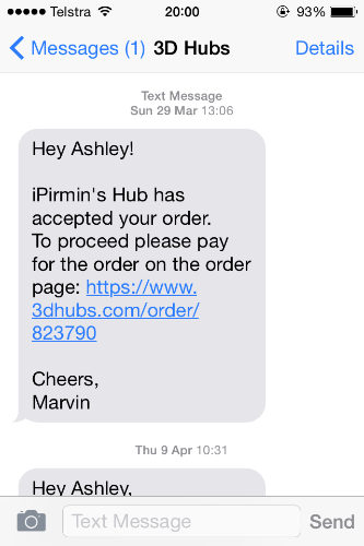

Once you submit the order you will be amazed at how simple the process it, the communication from 3DHubs is excellent and you know exactly how the print process is going. I got a SMS to say the job was accepted, the print had commenced, the order was ready for pickup all in the space of a few hours! I walked down the road and picked up my order. If you are lucky enough to own a 3D printer - register it with 3DHubs, but if you can’t afford to buy one, then this is the best and only website you should consider when you need to print an item.

danx.pngSo far I have printed a part for my RC helicopter, a replacement battery case for my robot mop, a marvin the martian that glows in the dark, an iPhone4S phone case, a GoPro 3 case with anti-vibration mount for my quadcopter, a stand for my FPV LCD screen that clicks onto my RC controller, a watch mount for my Garmin and just the other day 2x replacement hooks for my lawnmowers grass catcher.

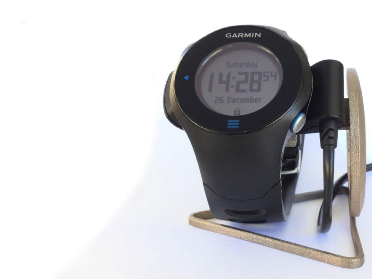

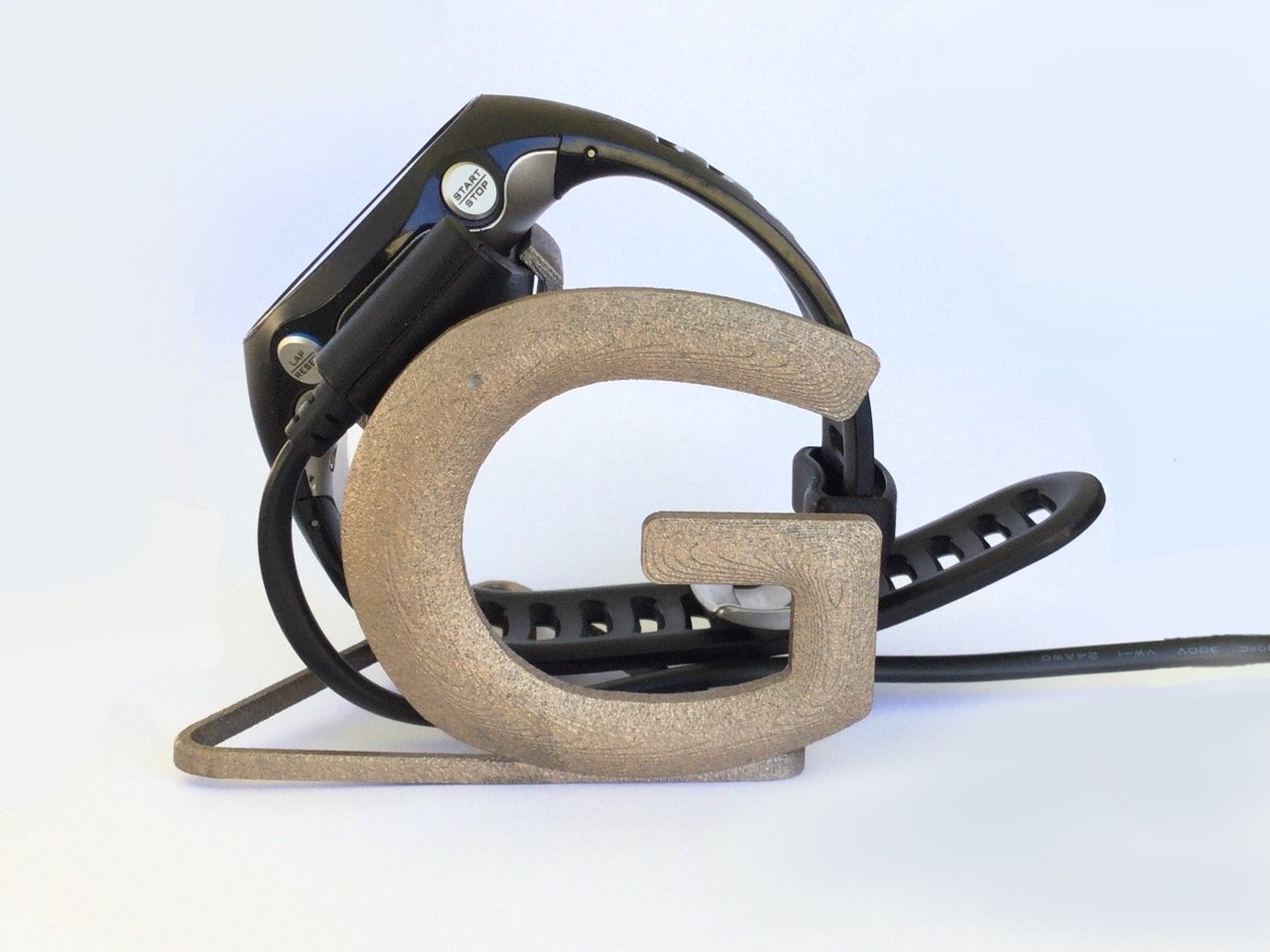

A quick update, I managed to get it 3D printed in polished grey steel. It’s also magnetic so the recharging cable clicks into place.
It really looks stunning! Do you have the files uploaded on Thingiverse or a content platform of sorts?
You can find it on Shapeways so anyone can order it. I found they have a great website and offer the best metal prints.
