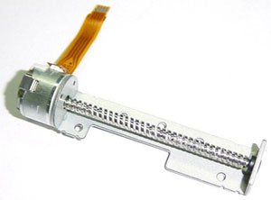

I dont need belts I am using small stepper motors from DVD drives like this:
http://images.elektroda.net/85_1309460292.jpg
So it will be pretty small
