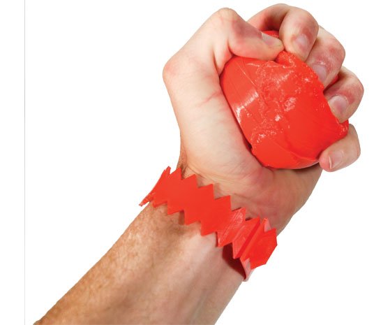

Hi @mdevisser. We mainly print with Ultimaker’s flexible filament and filaflex from recreus. Ultimakers filament available only in black and white has a leathery feel to it. While filaflex is quite soft and elastic and comes with a wide variety of colors.
Check out makezine’s review of flexible filament which gives you tips on printing flexible materials. Also gives a comparison of strength and stretch.
If you are looking for a printer that prints flexible well. Best look for printers with direct drive extruders( drive motor on the print head) compared to Bowden tube printers (drive extruder not on the head)

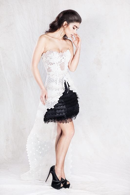

are you familiar with our inBloom dress? http://3dprintingindustry.com/2014/08/22/blossoming-catwalk-xyz-workshops-3d-printed-inbloom-dress/
you our can download our design for free from #ultimaker #youmagine site. And I can comfortably say it is quite comfortable depending how you design it. I wear a watch version everyday. And it feels abit like leather. We’ve had no complaints about from the models that wear our dresses but then again they don’t wear it for the whole day.
But it I agree that for comfort there needs to be a certain level of porousity to let the human skin breath. That’s why we model our dress with openings to allow that to happen.
we still haven’t figured out how to wash it haha. Cause you can send the dress to the dry cleaner of it will become a pile of goop. Hosing it down in the lawn is probrably the best way, but that ain’t very glamorous is it?
