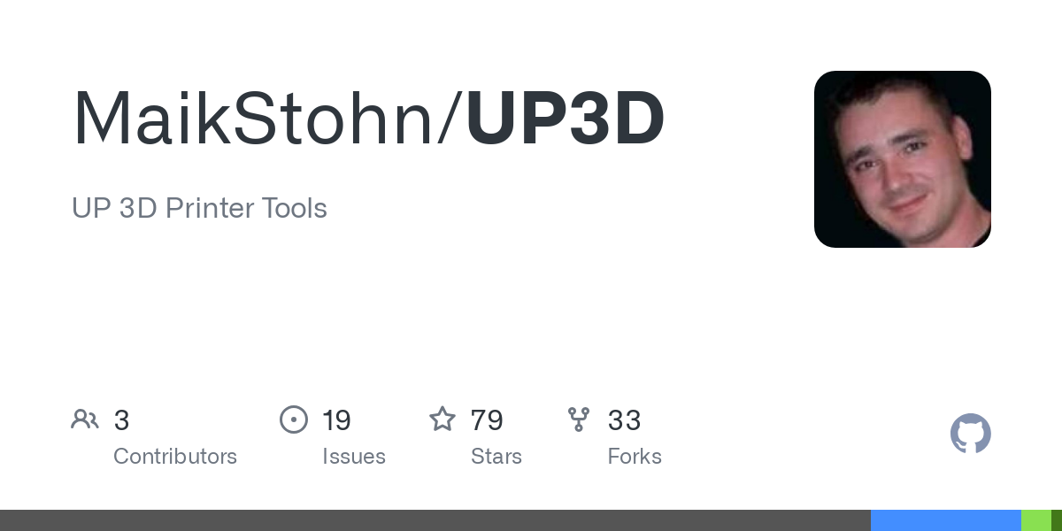

There is an update to this project that fixes some previouse issues related to positioning errors especially when used with Simplify3D (infill shifts). The G-Code transcoder works on the entire UP product line like the UP Mini, UP Box, UP Plus, UP Classic.
Please see details here: GitHub - UP3D-gcode/UP3D: UP 3D Printer Tools
In addition the G-Code transcoder supports not only Windows platform, it supports OS X and Linux as well.

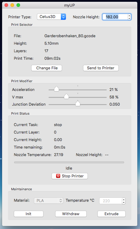

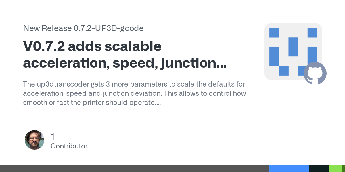

There is now a new transcoder version available which allows for acceleration and speed control. This version includes also a alpha release GUI fronted forOS X.
See details here:
Well, took a while, still… Dropbox - g2z - Simplify your life
