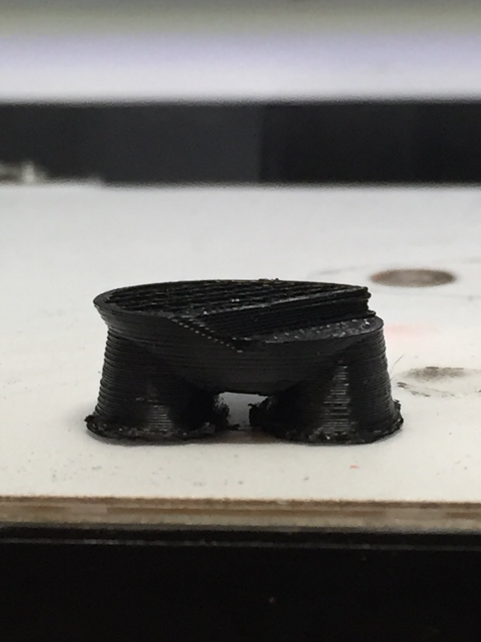

1. I took the .stl Marvin into Rhino and split the face and ears apart from the rest of the body and used the “Dual Extruder Wizard” in simplify3d to put it back together. When I print, the face only partially prints and leaves “V” in the bottom of the face out. There literally is only a “V” where the face should be. Everything else but the face and the ears prints fine.

The second color doesn’t even start

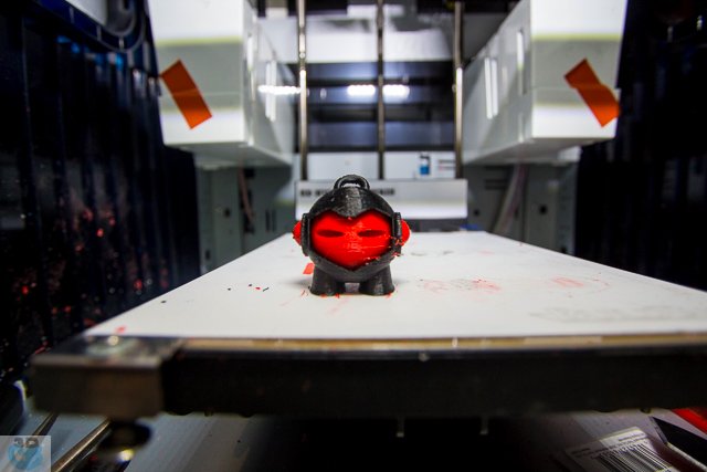

Here is my resault
