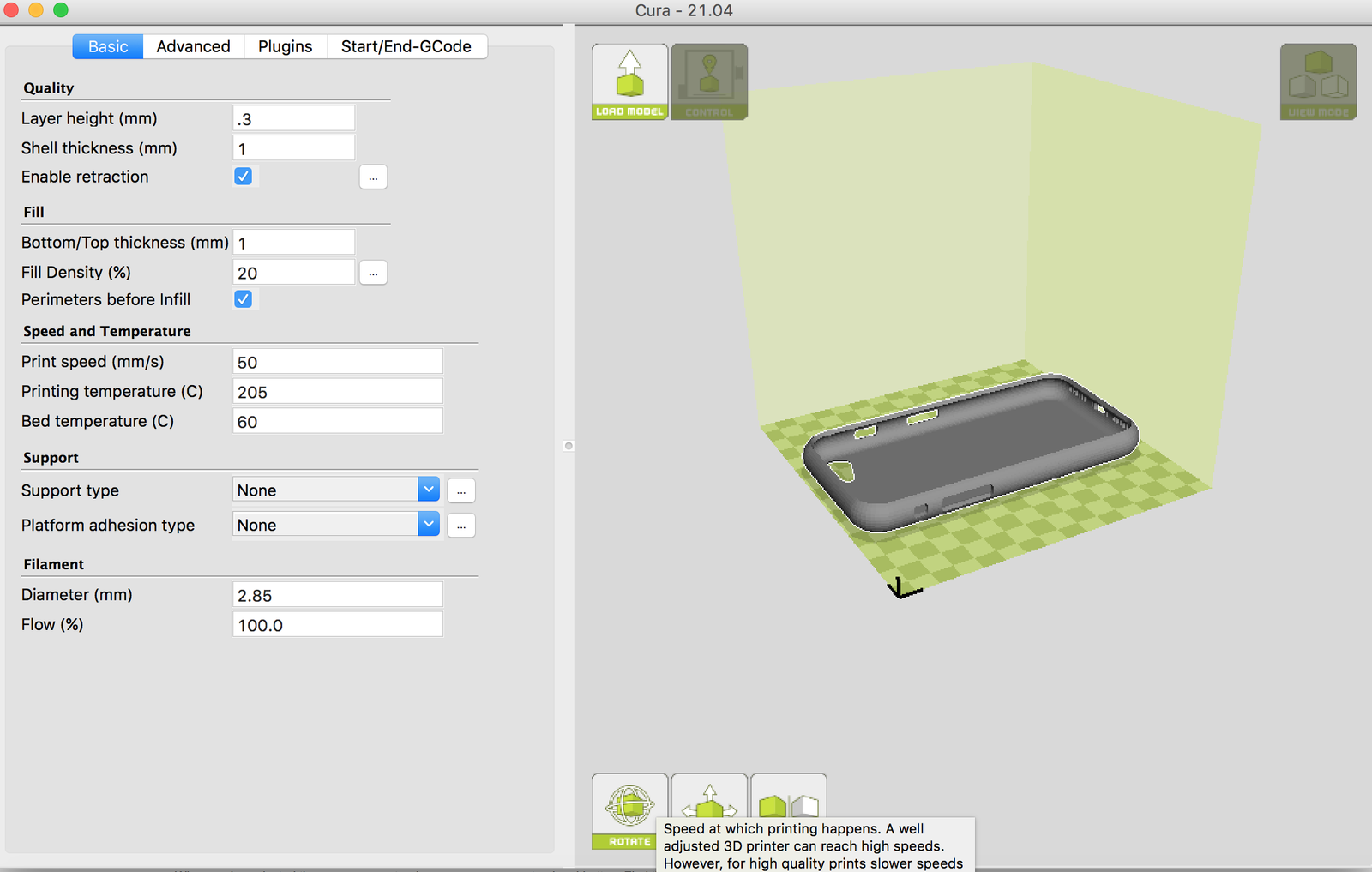

model made on solidworks won’t print on cure, as you can see the control botton on the middle top right is greyed-out. Any tip would be appreciated. Thank you

Not sure if it is the cause, but you have a floating surface that you need to delete. I highlighted it on the attached pic.

I don’t use Cura but do you need to click on the model to select it first?
It looks like the phone case is larger than your CURA printer bed.
Scale it down slightly to see if the part goes green.
OR try rotating the part 45 degrees in CURA to see if it fits on the CURA printer Bed.
The small floating surface will give you a defect in your print, But I don’t think it will stop CURA from printing it.
