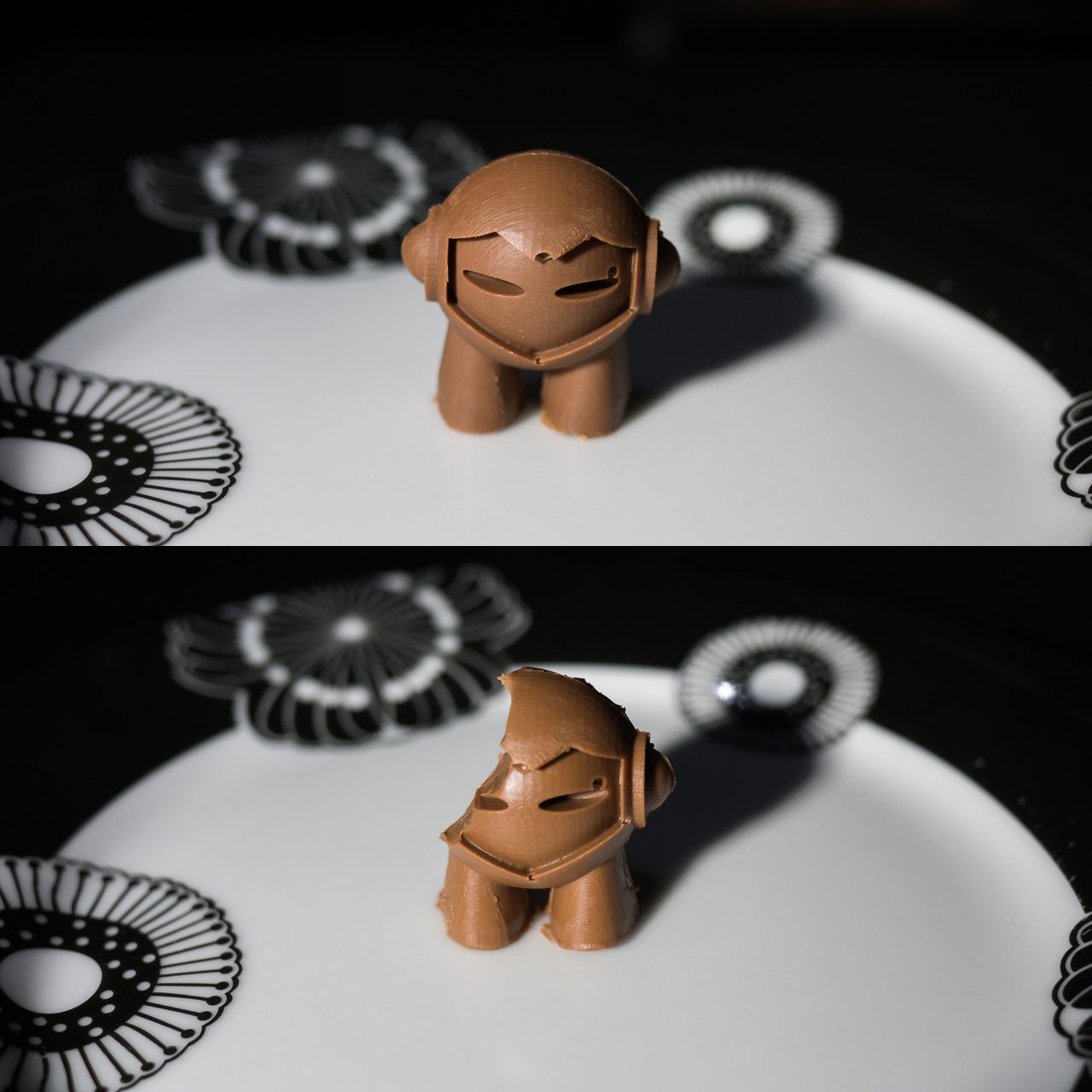

I’d been experimenting with using silicone mould compound to cast duplicate parts (as in this tutorial video) for a while, when I hit on the idea of using food-grade silicone to cast in chocolate instead. And after a few attempts I got it to work reasonably well (poor Marvin!):
It’s a relatively manual and time consuming job but I’ve decided to offer it as a service on my hub anyway as it’s fun and something people generally aren’t offering as a complete service

The template model was printed on our Form 1+, and yeah that Marvin was milk chocolate flavour :slight_smile:
