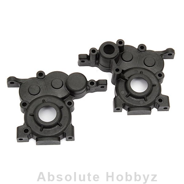

About the gearbox, I will not be printing the gears, just the gearbox itself. I will be using the standard gears from the car, but I just want to change some things at how they are located and such. I added a picture of that. Could that be done with XT-CF20? Or also better nylon?
I like to avoid nylon because it’s time consuming, no? You have to bake it before you print with it…

I use a lot of Taulman 910 nylon, with fantastic results. I use Simplify3D for slicing/printing and with some tweaking, I’ve gotten it to print very reliably with supports that work great and are still easy to remove. The parts aren’t as strong as injection molded parts, especially stuff that is glass filled (like a lot of RC parts are), but it works very well either way. The slight bit of flex actually helps the parts survive crashes that would otherwise crack or shatter parts that are printed in very rigid materials. For parts that you don’t expect any flex, I would print in the XT-CF20 or similar. For everything else, I would use nylon. Here’s a few helpful hints I’ve found with printing nylon
*If you are going to print with nylon, keep it in a sealed container with a cheap dehumidifier and you won’t need to bake the stuff before printing. My machine is warm inside because it’s enclosed, so I just keep the door closed with the material loaded inside. Works fine.
*Use a larger nozzle for MUCH stronger parts. I had the strongest parts when printing with a 0.8mm nozzle, but we sacrificed a small amount of fine detail. I would suggest nothing smaller than 0.6mm for better strength. I print with 0.35mm nozzle when doing very small parts that don’t need a ton of strength.
*My machine is pretty fast, around 250mm/sec for ABS and it CAN print nylon around 150mm/sec but the filament is slippery and the extruder will slip and the material will tend to extrude inconsistently and the parts will be weak. I slowed it down to around 80mm/sec and I got good results there. You’ll need to do some test part to find out what works for you.
*Nylon likes to warp as it cools. I would add some kind of enclosure to your machine if it doesn’t have one. I keep my bed around 80°C when printing and I use kapton tape with Elmer’s Glue sticks applied. I also found that adding a raft helps keep larger, thicker parts from warping as badly.

I already ordered a spool of XT-CF20. I understand that parts that get big forces should have a little flex.
I think for the gearbox enclosure ands stuff like that, the CF20 filament is great. But I think I will buy Nylon too.
About printing with a bigger nozzle, I understand that bigger parts are stronger. But these RC parts are small and still also require some type of detail, so atm I’m printing with a 0.4 nozzle, 0.2 layerheight, wich seems a nice balance between quality and strength.
