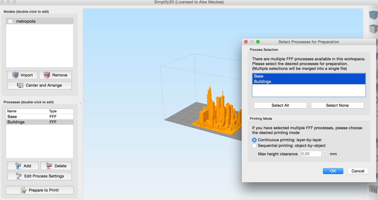

Different Settings in one print
This is a bit more of an advanced thing to do, but you can actually have different settings in one print. For example, you can have varying infill percentages by creating different processes at a certain layer height (more below). This is an interesting way to save printing time, filament, and reinforce potential vulnerable sections of your print.
To do this is you have to “start printing at height” and “stop printing at height” at the layer you want to switch settings. With multiple settings achieved, when you move to the prepare to print section, a new dialogue box will appear. Select both settings and then the continuous printing .

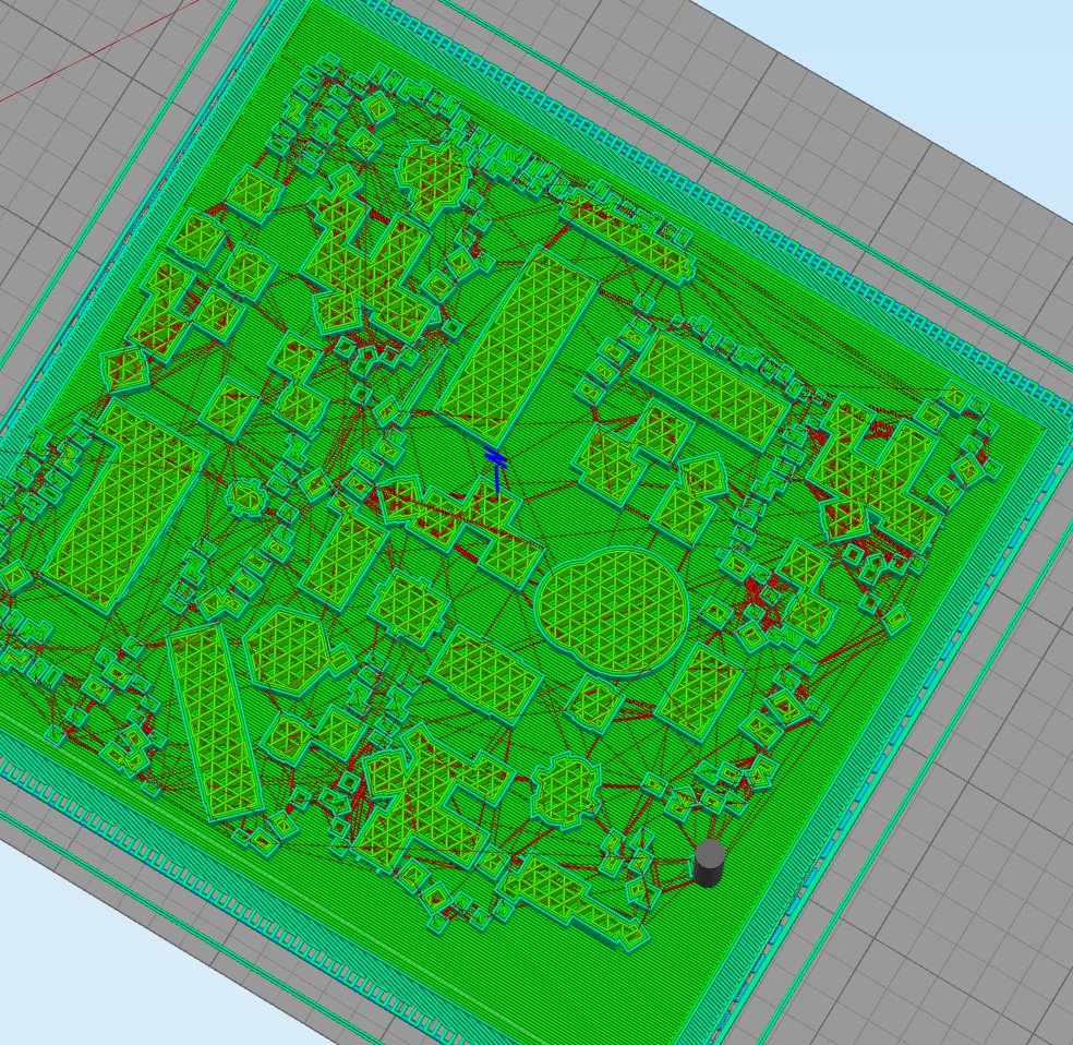

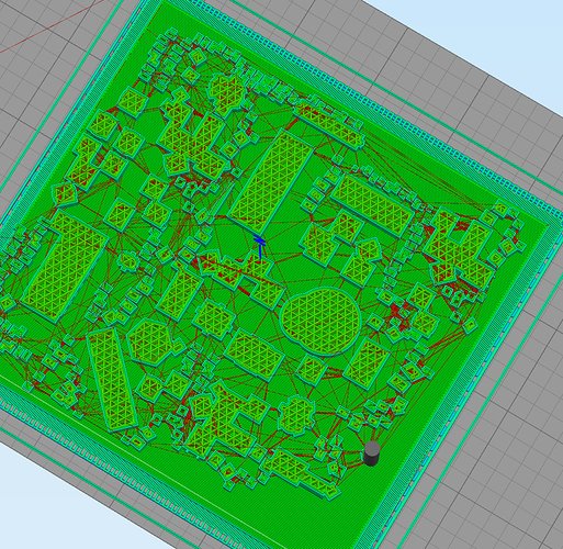

Fill Patterns
You can change the angles of the lines placed for the infill. The default pattern is -45, 45. You can do horizontal/vertical by 0,180, triangles by 0, 60, -60, so on and so forth. For properly solid models, you can make 200% extrusion width with a high infill. Unfortunately, the honeycomb pattern isn’t available yet with Simplify3D. Hopefully soon!
