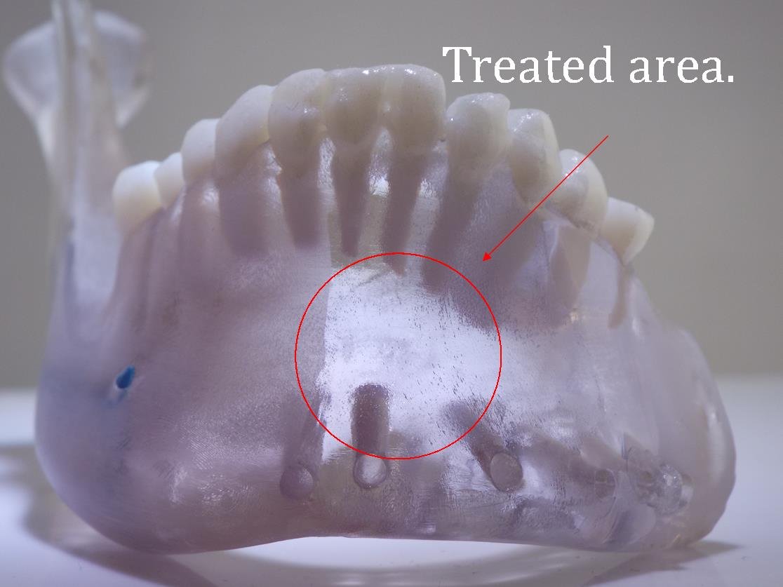

Thank you so much, my Distributors will kill me, for talking pre-launch, I’m sure you can keep a secret until Thursday, but it has been a tough 18 months, developing products to reduce your burden of post-processing. I call it safety in numbers. 1,2,3,4.

That bronze finish is amazing! I just had about 30 new ideas for projects!
