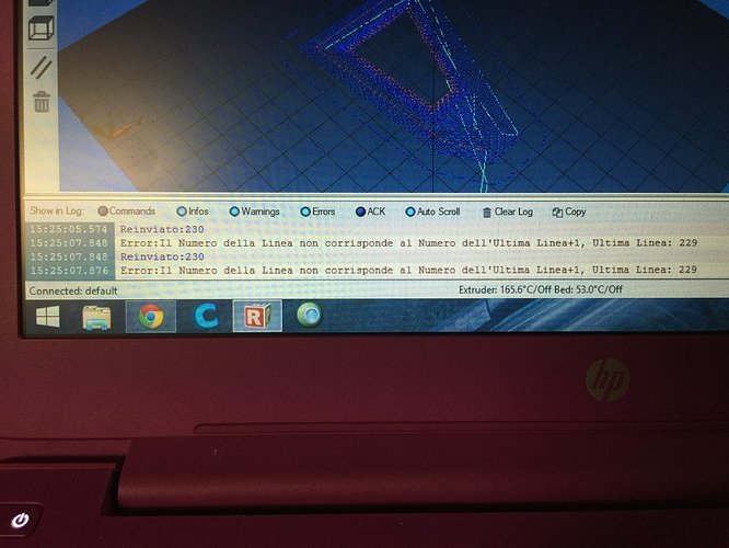

I keep having an issue where a print will start but a couple of layers in, it will stop and Repetier will throw up errors in another language. I’ve had this happen with different STL files and Gcode created by different slicing programs. I’ve attached a photo of the errors.
haha Italians are taking over Repetier! If it helps, this is what the software is trying to say: ‘serial error Line Number is not Last Line Number+1’. It seems to be caused by a loose USB connection, you can read more about it here, but you’ll need Google Translate for it: problema !!!!: serial error Line Number is not Last Line Number+1. Good luck!
