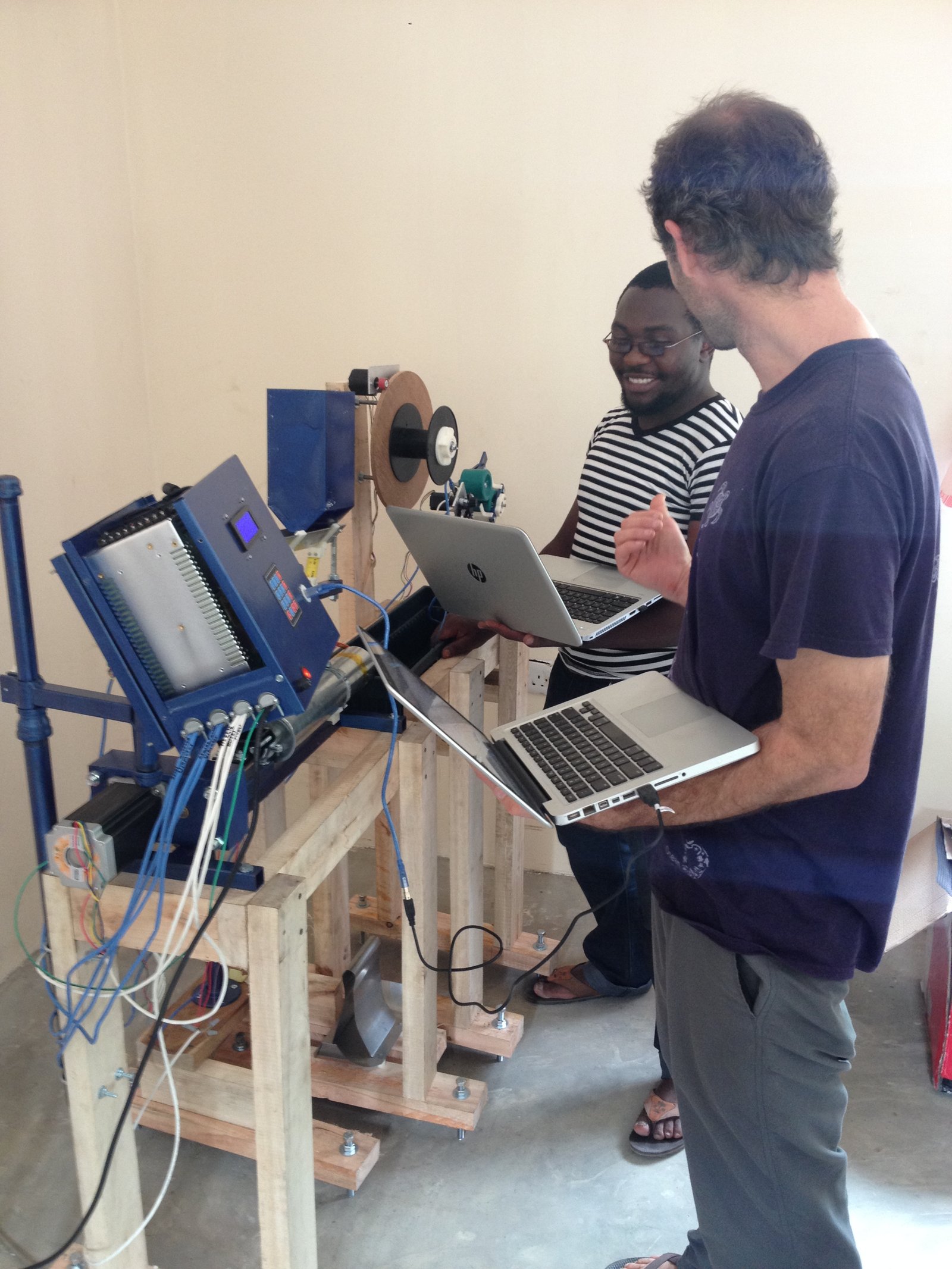

Great initiative! How does your extruder deal with the PET material? Do you face crystallization problems of the PET polymer leading to bad results? How do you encounter it?
Hi!
We indeed had some challenges with crystallisation in the past, both in the extruder as well as printing with the filament.
On the extruder we’ve solved this by pulling it through a water bath right next to the nozzle head. It’ still a very delicate process to get right though. On the printer it mainly has to do with right temperature and printer settings. We’re currently testing with our partners to find additives to ease the crystallisation or to mix it up with PETG.
If you want to know more in detail how our extruder works we’re always open to a Skype (@jaspermid).
