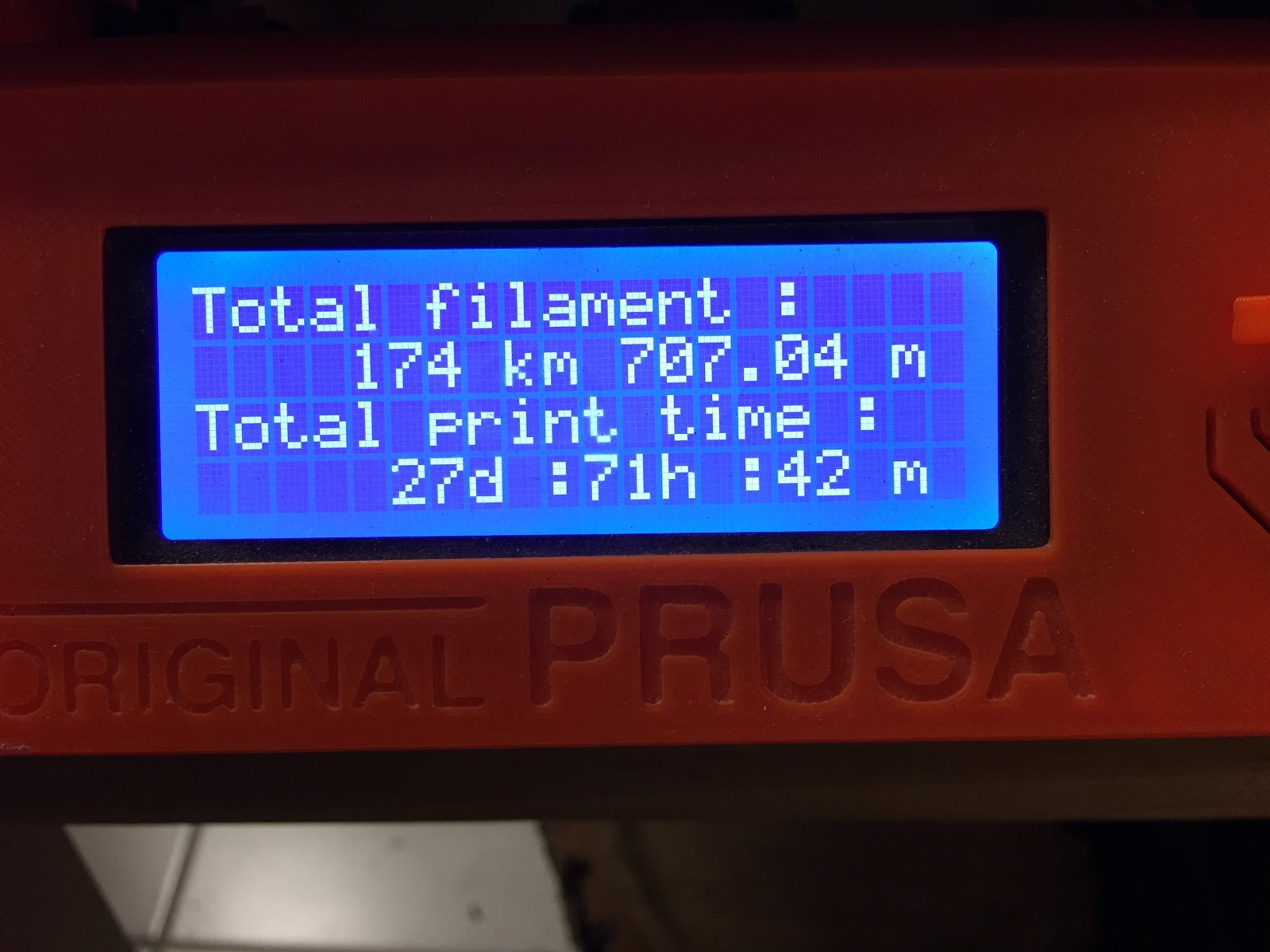

I hve had my i3 MK2 since march. I bought it as a kit and built it myself. So far I didnt have to replace any parts and I printed close to 200 kilo meters of fillament. I bought silicone sleeve and hotend thermistor from e3D since I want to protect the hotend and the wireing of the new thermistor is much better. I had a problem that one of the prints stuck to the hotend and damaged insulation of the thermistor wites but everything was fine and the printer works. My next printer will definitely be Prusa if they manage to make printing volume bigger.
@ Clip3D … so you have printed over 500pcs of 1kg rolls of filament without any failures? Thats a lot of printing there :wink:
Look at the statistics. :slight_smile:
I got a short in the bed thermistor on the newest printer I recently received. But I have owned the first Prusa I purchased since February without any issues. I Upgraded it recently to the MK2s… but that is only bearings and rods (with a few additional printed parts). I haven’t had any electronic component issues though. Not from wear and tear.
I think this is a fake (you edited the setting) i printed 580m within 8d and 7hrs printtime. So it would be sth. around 1.6km after 27days
I doubt it was meant to be faked. My first machine has a similar issue, I believe it’s a firmware glitch. The first machine says it has over 800 days of print time, which clearly isn’t true. Hope this helps!
I don’t have intetion to fool anybody and I wish I had a knowledge to fake it. If it is a glitch sorry to make a mess but I do hope that I will print this amount of filament without problems. We’ll see.
not I do not believe that you are trying to fake anybody, what would be the sense in that? Actually my printer also shows a crazy amount of filament in the statistics, when I got it it showed realistic numbers but after the firmware update it started showing these kind of “updated statistics” :wink: I guess something was “lost in translation” I just keep track of how much I print by the approximate amount of filament I buy and use…happy printing everybody!
