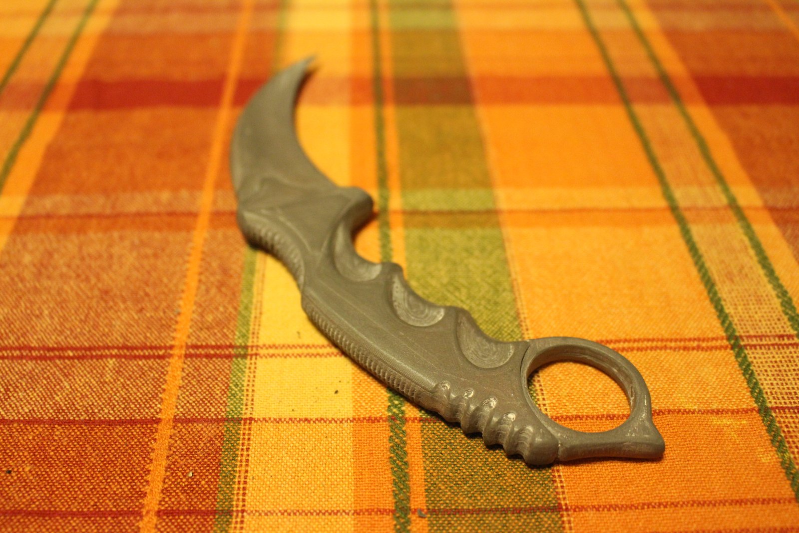

As For strength, I printed a karambit in SS to make a letter opener and found that the edge is quite fragile but I have dropped it many times and haven’t had a break, keep mind that I printed it at 100% infill due to the intended purpose.
In this photo it wasn’t fully polished.
