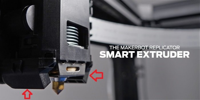

* The air plenum on bottom of extruder is missing (see attachment). Is this a possible reason about the problem?

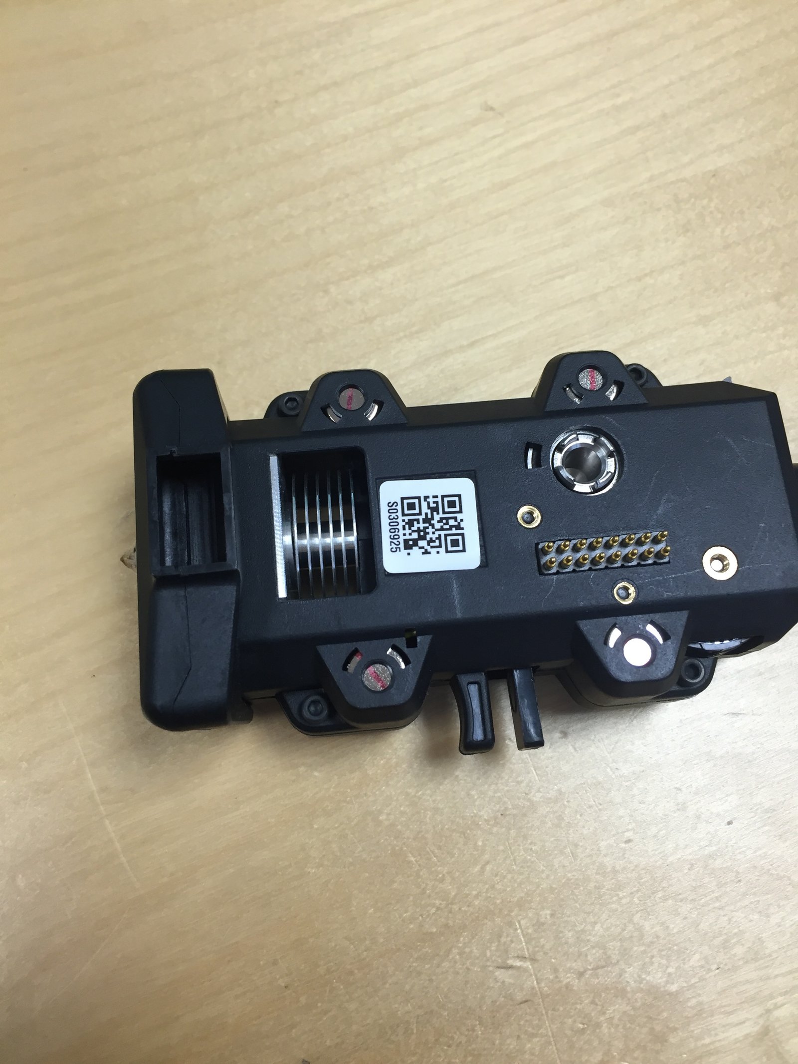

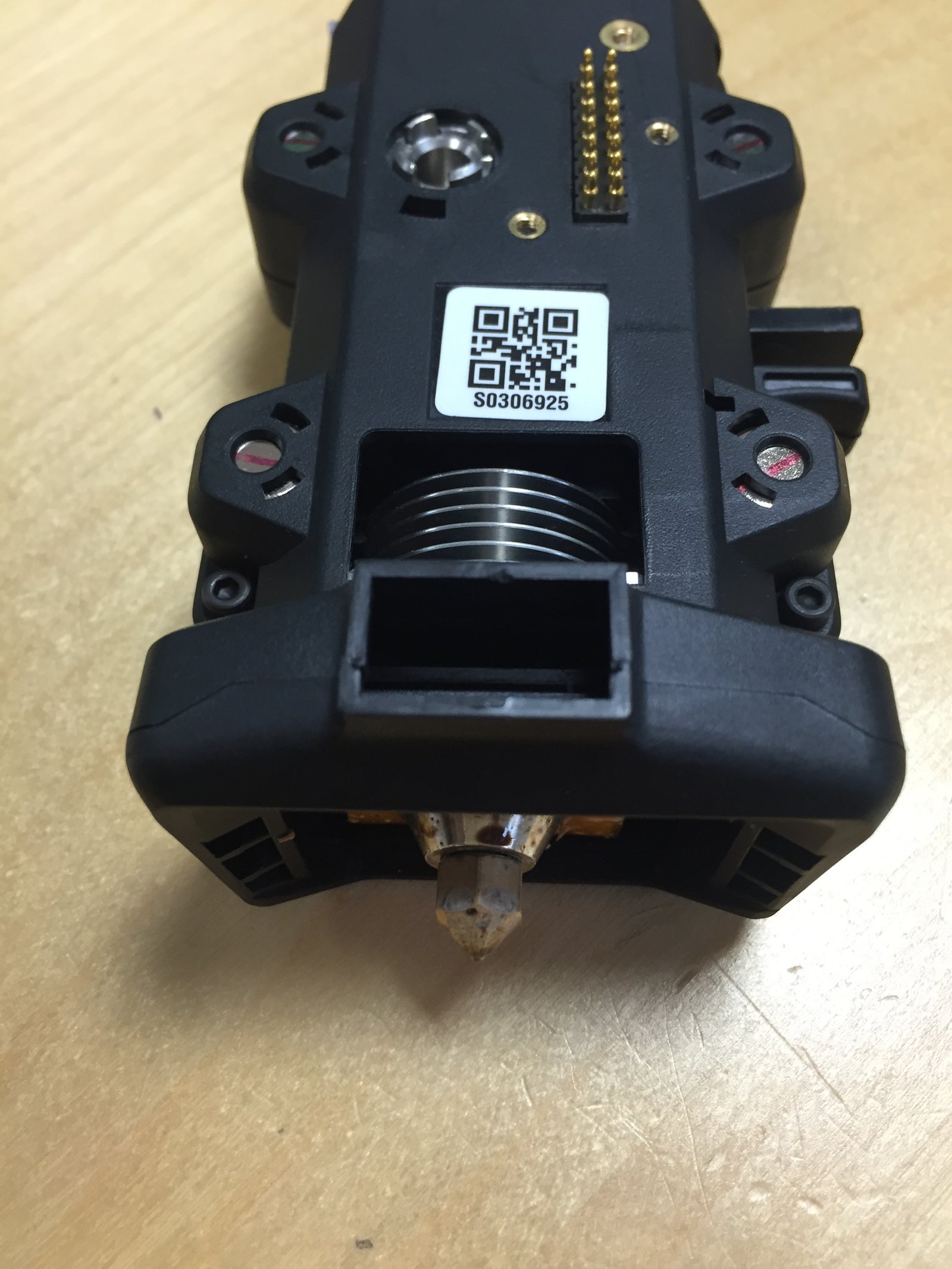

I have attached some photos of my Smart Extruder Plus off my MakerBot Replicator 5th Gen 3D printer which not had any issues with, with the new Plus Extruder! Before I fitted the extruder I updated the Desktop software and firmware on printer to lates and then fitted new Extruder and check in setting that if swap over from the std smart extruder to the plus smart extruder within setting as there will be different parameters hence updating the firmware and desktop.
Hope this help you move forward start to get some great models out of your 5th Gen MakerBot 3D Printer

The air plenum helps to regulate the hot end temperature as well as cool the prints. Without it on the old extruder I’d sometimes get a heat related error. On the new Smart Extruder+ You will almost always get a heat related error. The first SE+ I got had the plenum unattached from the extruder and I didn’t notice until I was getting errors (it was in the box, I just didn’t notice it). I’ve noticed that new SE+'s come with red tape holding the plenum on, so I must not have been the only one experiencing this issue.
