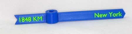

When developing the MyWay Sign (www.mywaysign.com), we wanted to print small font text on both sides of each sign pointer, so it could be easily read from different angles.
To achieve a nice clean print, we had to print the sign pointer vertically; else we’d need to use supports and would mess up the finish on the side facing down.

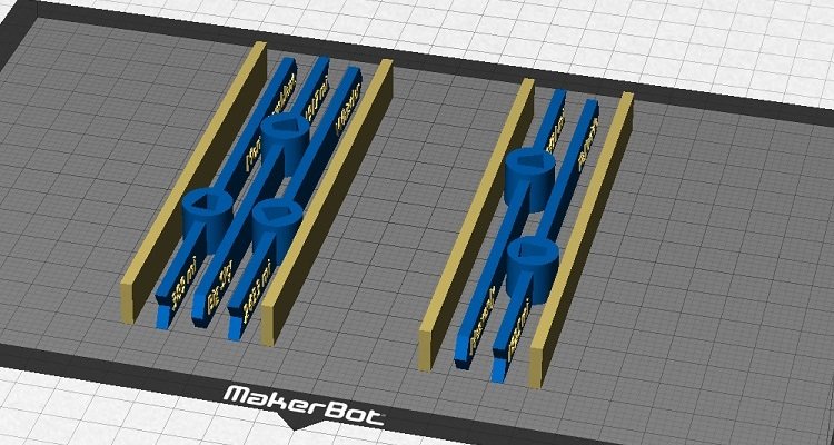

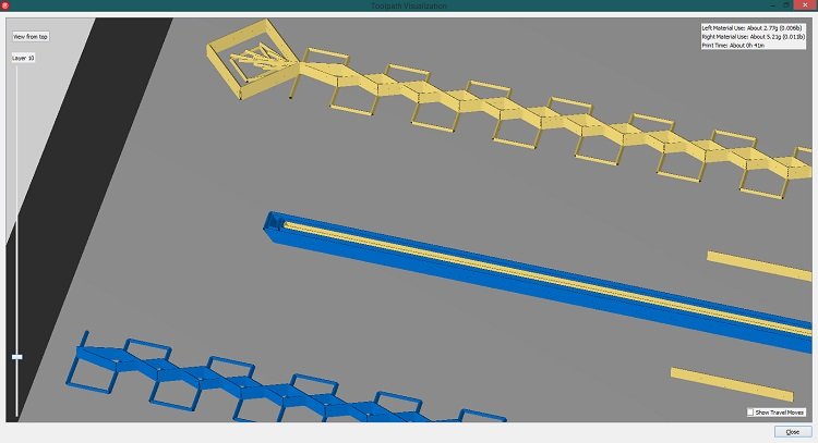

The first thing we did was layout the sign pointers in tight bundles of 3 or less. They were grouped and positioned on the build plate so when one print head was in use, the other was not getting dragged over any sign pointers. This solved the text shadowing quite nicely. To eliminate the schmutz, we added extra purge walls in the text colour to reduce oozing and to frequently wipe the nozzles, keeping them as clean as possible.

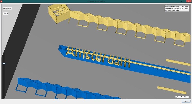

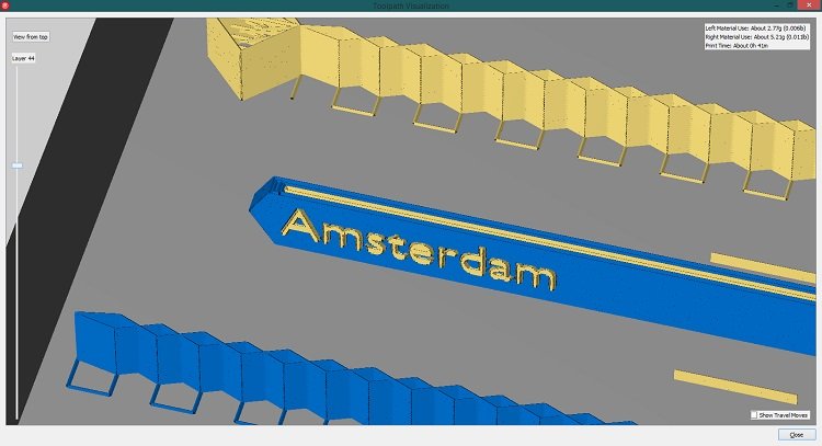

The final problem we uncovered was related to the filament flow when printing the text. Since the font was so small and the letters were being printed upright, the extruder was printing very short and thin bits of the text. These bits were causing excessive start/stop feeding of the filament resulting in small blotches and divots on the text. There was no consistent flow to the filament feed, it was too choppy. The solution was to change our design by adding an extra but hidden element. We inserted a thin plate down the center of the sign pointer and bonded the text to it. This allowed the extruder to print more smoothly.
The result was much better filament flow yielding nice clean text. We could even print small accents and punctuation without any problems.
