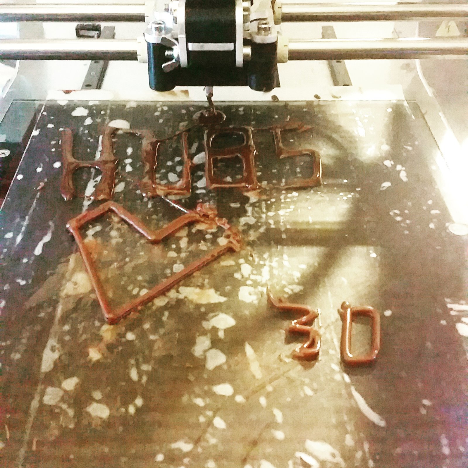

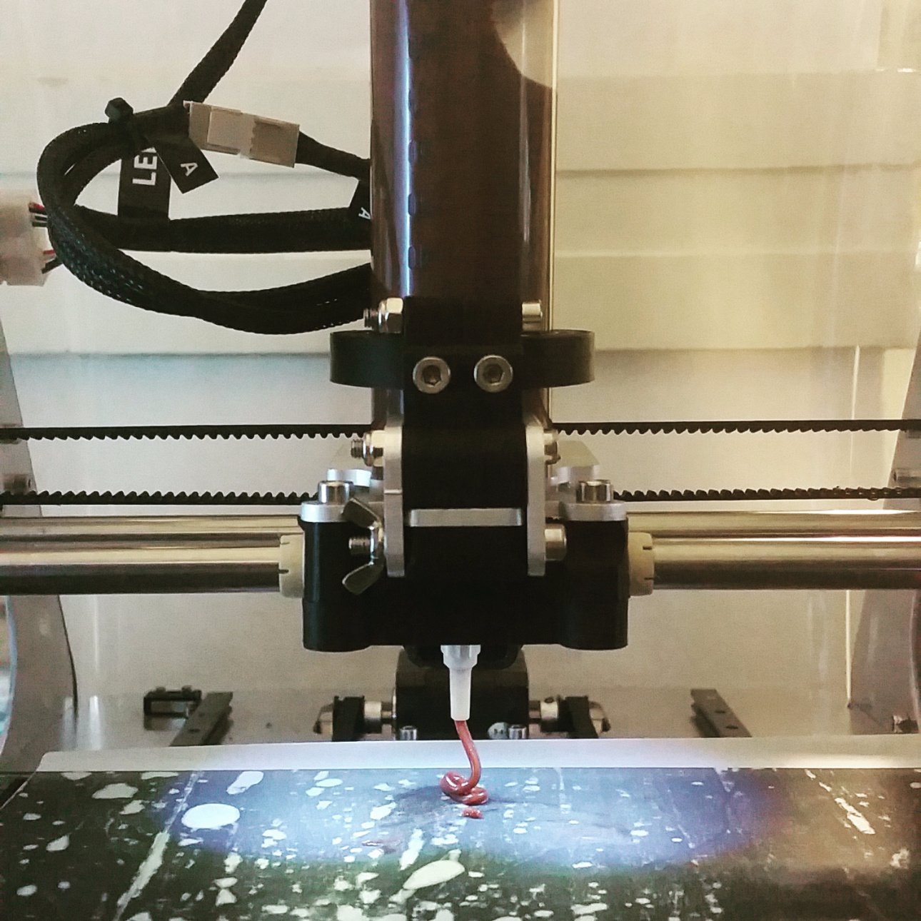

Actually putting the mixture in the nozzle and mounting it was a piece of cake, but maintaining a good “extrusion” was a toughest challenge. It was either extruding all the time or simply not extruding at all. Changing, mixing and experimenting with the chocolate took us the most of the time. But at the end we seemed to have everything calibrated and managed to create some sorts of shapes.
