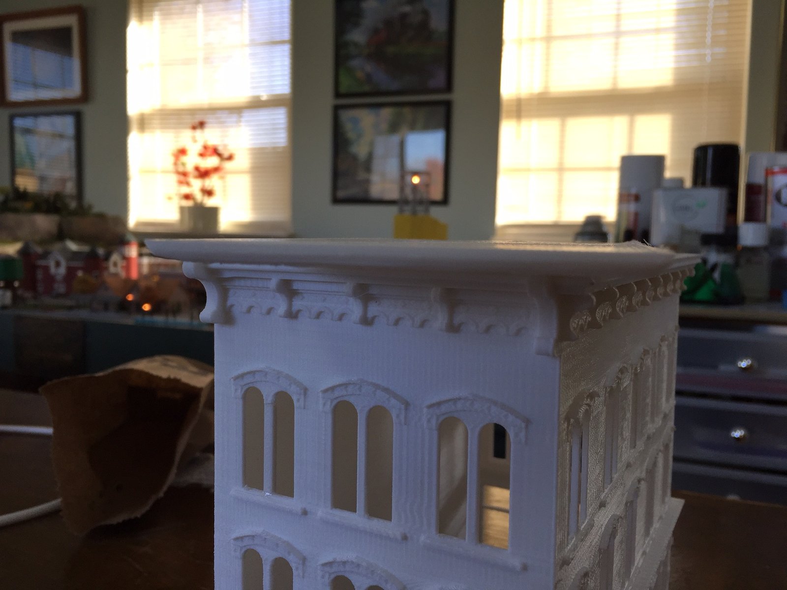

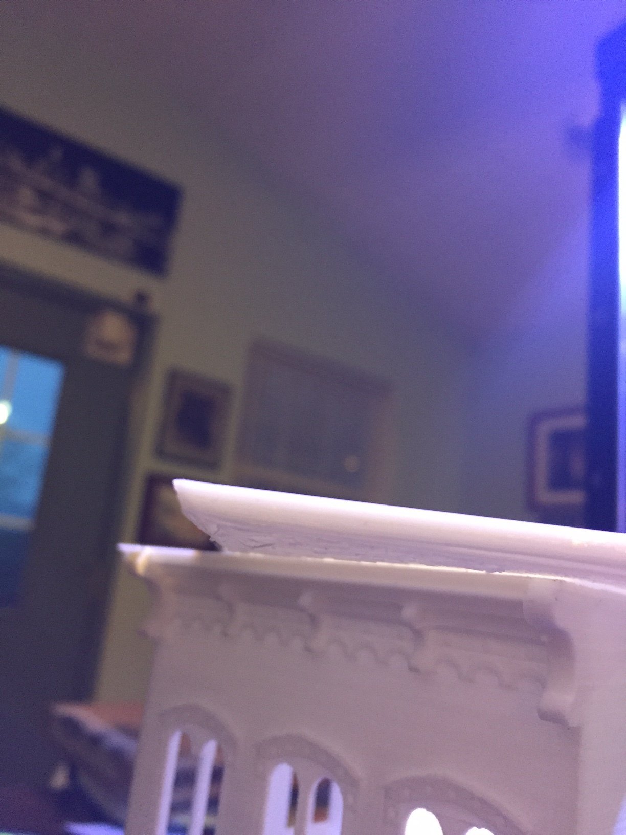

Hello all. I just purchased a Formbot TRex2 3D printer. I have been working with it all week trying to learn how to use it. On my third print, I had a small, very uncomplicated job. I was simply trying to print a rectangle 3"W x 8"L x 3/16"H to serve as a floor for a building model that I had 3D hubs print for me earlier. The edges did not come out square. From a side view, the printer made the edges at about a 45 degree angle, though this was not in the model. Any Idea what could cause this? I was using PLA at 230 degC.
Can we get some better pictures, sorry but cant really see the edge. Did you tried to print a normal cube to see how the edges are look like for that?
Also please share the STL file also to check.

Hello Tamas, thanks for responding. Yes below are some better pictures of the corners. No I didn’t print a test cube, that might be a good thing to do huh? I have made some test prints that have come out very nice. This one in particular however needed square edges.
I attached the stl file that I made from Sketchup. I created the g-code from Cura. I guess I expected the machine to print square. I am using PLA at
230 degC and 50mm/sec, .0.2 Layer height. My bed is heated to 57 DegC.
tan_bldg_floor_1.stl (684 Bytes)
Hi Frank!
The stl file looks fine, its just a simple rectangle no errors in it.
Was the print stick well to the print surface at all corners(bed leveling)? As this looks like the corners lifted /curled up during print and this caused the issue, so check the bed level again, and watch it during print if its lift up or not.
I would suggest to print a smaller test cube, to check how the printer prints walls.

I can’t quite see exactly the problem with the edges from the pics. I do see is a ton of wobble and ringing artifacts. Usually that means belts are not right enough, the print head may not be secure enough, or something else is being allowed to move around when it shouldn’t. You can also try slowing down the acceleration to 300 and jerk to 1 and see if that helps.
If you are using Cura btw, you may have the “Make overhangs printable” option turned on which would round off edges.

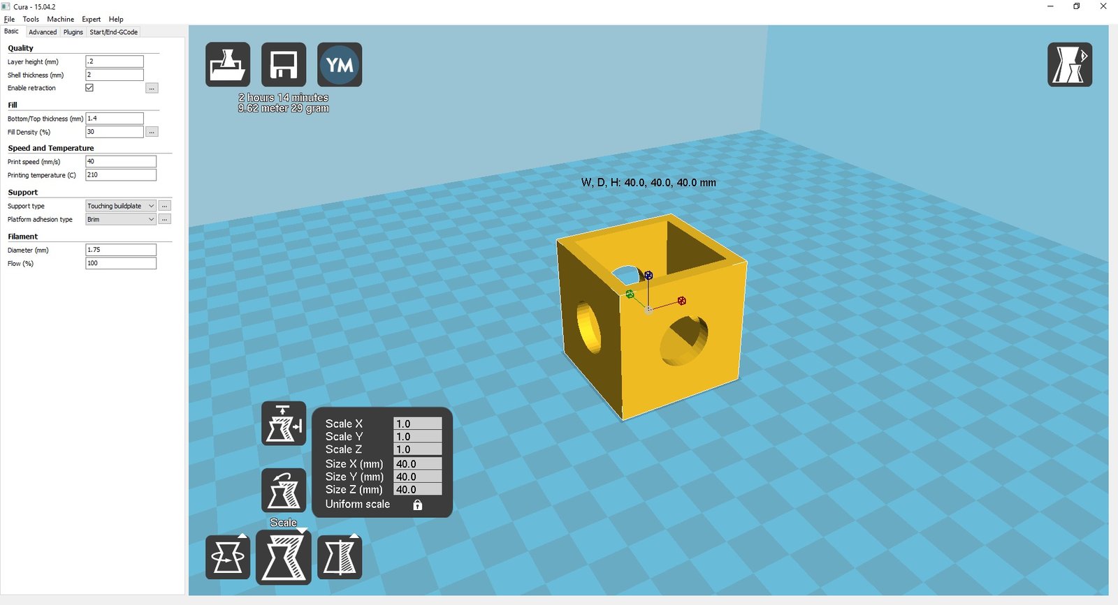

Hi Tamas, I am interested in your suggestions, I need some clarification. I am using Cura software I think the settings are different from your’s. I see a setting for flow in %. I have mine set at 100% There is a printing speed setting that I did lower from 50mm/s to 40mm/s. Is that too slow is that what you mean by extruding too much? Since it prints slower it will leave more plastic no? My printing temperature is set at 210 for PLA. I had quality set to 0.3, I’ve changed it to 0.2. For cooling I’m set at “minimal layer time of 5 sec”. I am using a bed temperature of 64DEGC. I have retraction set to combing off which is supposed to mean it retracts over holes. I doubled the size of the model I was concerned at the time I was having a problem with the print slipping after a couple of hours of printing. I think we’ve fixed that problem. I took some screen shots of my settings. Would you mind looking them over?
My plan is to clean the bed as you suggest and then lower the nozzle a little (That was Formbot’s suggestion) I was also going to raise the speed up to 50mm/s. That should decrease extrusion no? I like the bed temp of 64 DEGC. It seemed at one point I had raised it to 68 and the initial llayer showed more warping. I got the impression it was too hot. Any help you can give I would surely appreciate.

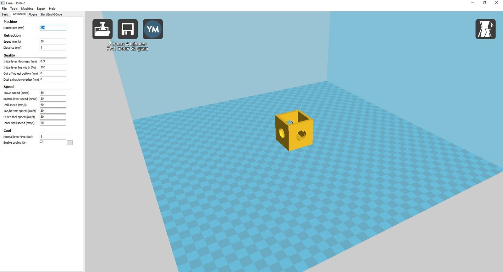

You missed the advanced tab and uploaded the basic tab twice, no problem.
I suggest:
Layer height: 0.2
Shell thickness: its the multiply of the nozzle diameter so for a 0.4 nozzle 1.2 if you have 0.5 nozzle 1 or 1.5.
Bottom top thickens: 1mm should be enough.

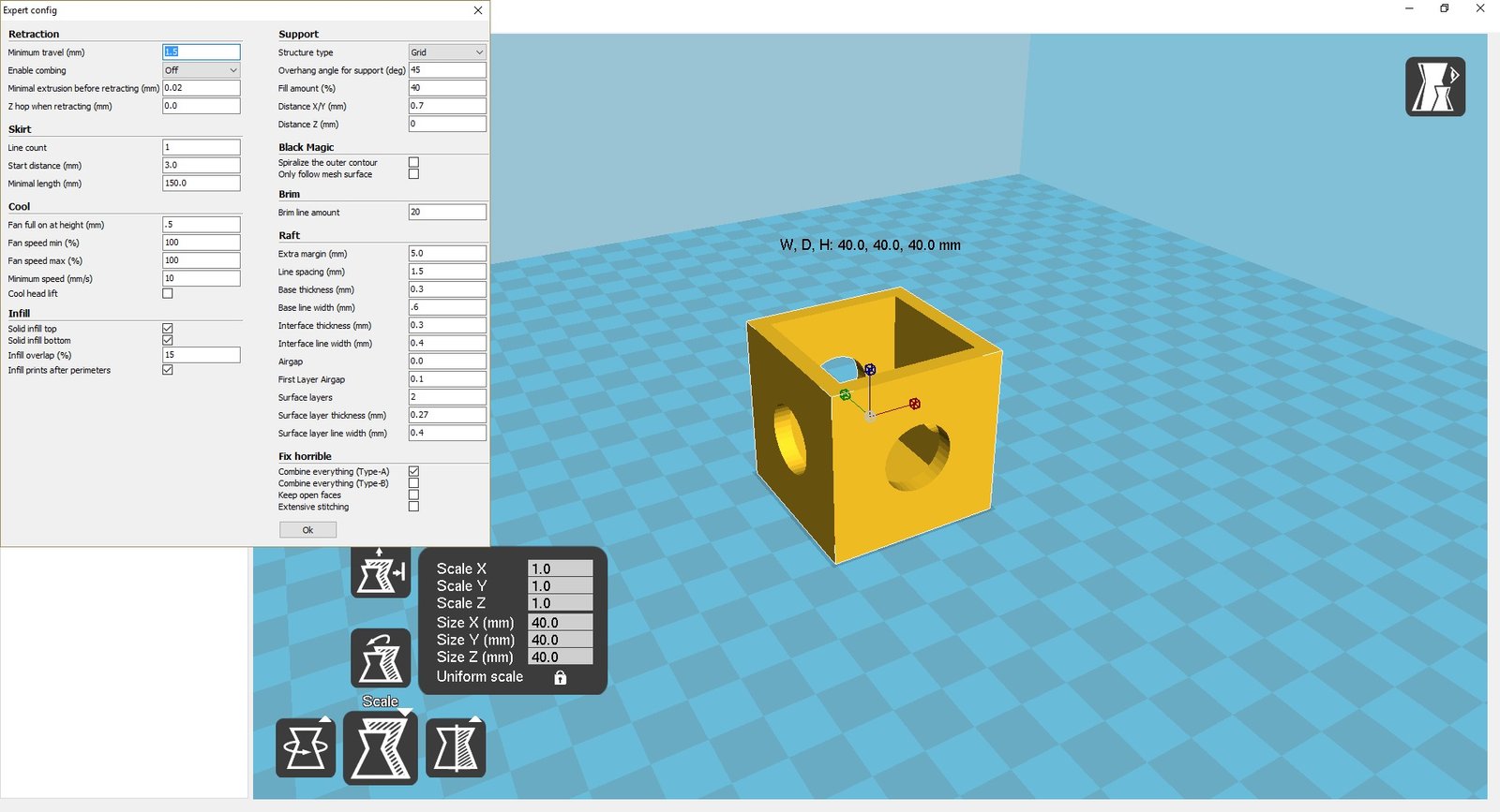

Enable combing set it to ALL
Z-hop: set it 0.1 or 0.2 so this will raise the head when moving the print head to prevent collision with printed object.
Brim line amount: 6 should be enough no need for 20 lines.
The rest should be fine for now.

I attached my advanced settings tab, sorry about that I should have checked. Getting older, I need to double check myself. Tonight I’ll look into the calibration software.

Hi Frank!
First:
There is one big mistake in this configuration: Initial layer line width % is 300 !!! so it means for the first layer you try to extrude 3X times the amount of filament. Please set it back to 100.
Also the initial layer thickens(first layer height) I recommend 0.2mm.
You retraction values should be tweaked a little : speed to 50mm/s and distance to 4mm.
