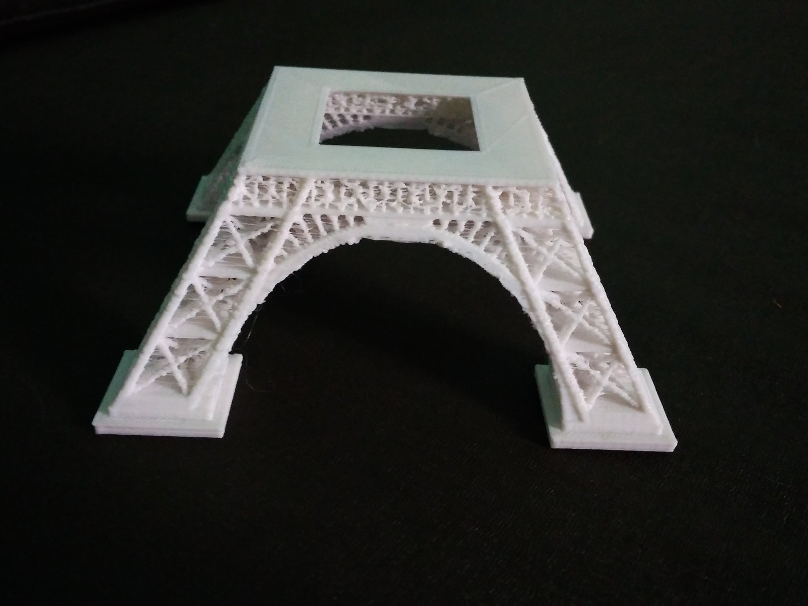

The attached image is the base of eiffel tower printed on Anet A8. The size is 109 x 109 x 40 mm. I know there is lot of stringings, however as it is printed on a low end 3d printer(Anet A8) I want to know whether the print quality is normal for such complex structures. If any one tried printing Eiffel tower on Anet A8, please share a good quality image and also please let me know to improve the quality.
Please note that I tried different combinations of retraction speed and distance, but I see no good improvements.

My cura 14.07 settings are:
Nozzle : 0.4 mm
Layer height : 0.3 mm
Shell Thickness: 1.6mm
Print Speed : 30 mm/sec
Print Temp: 200
Bed Temp: 60
Fill density: 20%
Retraction speed: 45 mm/s
Retraction distance: 4.5 mm
Retraction Minimum travel: 1.5 mm
Minimal extrusion before retracting : 0.02mm
Enable combing: True
Zhop: 0 mm
Material: 1.75 PLA
