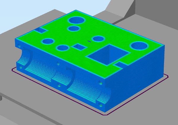

Looking for some advice on witch way up to print these parts.
Using DesignSparks Mechanical and Simplify3D
I would like to print without supports if possible and wanting to know which way to print the parts.
I have included the parts. What do you recommend?

Hey @Alex3DHubs, do you maybe have some advice for Suggy?
All Version 2, but Version 3 for top. I suggest you close the holes for the screws on Top 3 with only one layer, than you don’t need support
Bottom Long Right.stl should print well with .3mm layer height and cooling fan at least at 60% if printing with PLA. No supports should be needed if oriented as shown in attached picture.
Also take a look at this article for more tips:
Top 5 Design Tips for 3D Printing: http://hubs.ly/H0215tC0

Forgot to say it will be ABS
A little confused all 2? even the carrage? as this puts it on its edge
How do you mean close the holes?
