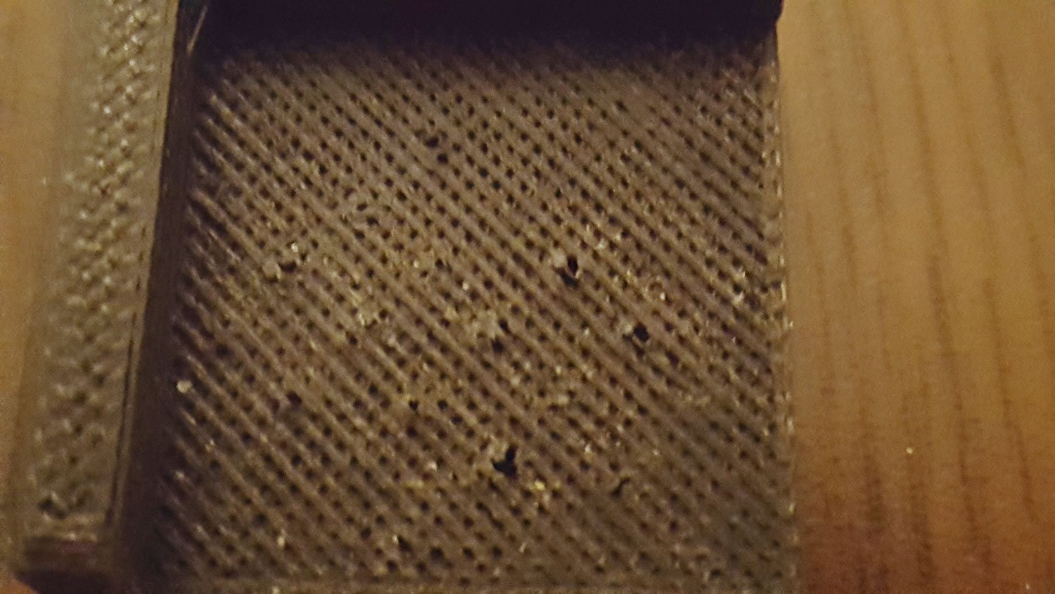

Pothole in top layer
Got a problem with the top layer, seems to be on every print I have done.
I use Cura. Is the top layer to thin? And if so, where do I increase it.
Bubbles, probably your filament is bad, check with a different brand. And why it’s skipping one line after printing one?

It appears that you are building the part using about 40% infill.

Now that you’ve mentioned that you are using 20% infill, the lines in the photo must be
the top layers.

Yes, you are correct. The lines in the photo is the top layer. And I have set the Bottom/top layer to 1 mm.

It looks like the printed noodles are pretty round looking.

I’ve search the web and found out that this is called pillowing. And is due to to little cooling and/or to thin top layer.
So I’m going to check the fan and see if I can improve this. All so I need help to find out where the number of top layers is set in Cura. Have no clue where to find it.
https://ultimaker.com/en/resources/19503-pillowing
Are you getting adequate airflow onto the ptint? If it is pillowing as you stated then it could be that inproper airflow (or lack thereof) is flowing over the print as the nozzle moves over it. If so try adding better airflow (dual fan shroud etc) to see if rhis helps keep the peint uniform.

I was thinking the same thing. So I have ordered a better quality fan, hoping that will to the trick. If not, I’ve got two fans to mount.
