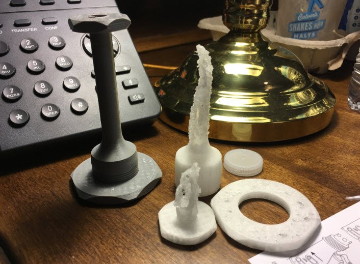

Hey Nate,
Adam from MadeSolid here. I did some testing with XT at 245C like it recommended on their site and it did not come out very well at all. I then printed with PET+ and, well, you can see the results. It was a smaller spool holder. Something went very wrong on the XT print…
Hi Adam,
Gijs from colorFabb here. We can definitely help you find better settings for printing with our XT material, I imagine it’s quite different from PET+. Just let me know which 3d printer you’re using and if you could share the STL file that would be great!
best,
Gijs
