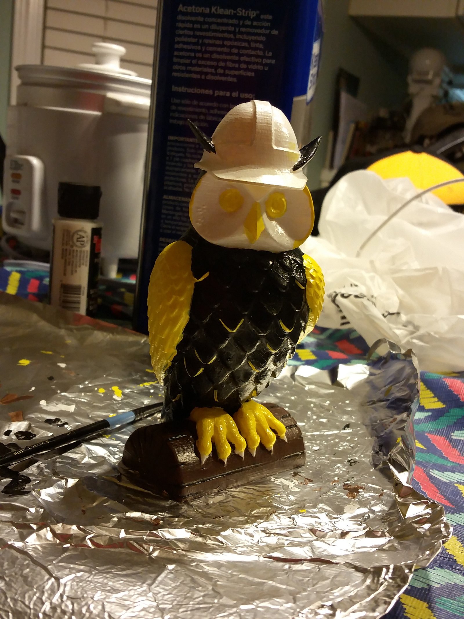

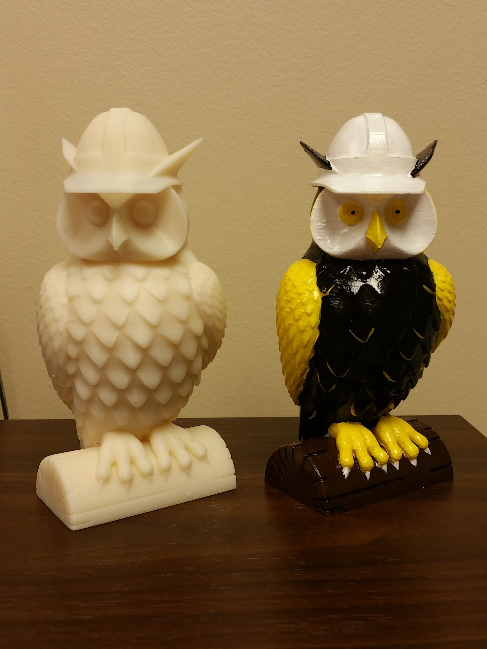

I acually just painted an owl that I modeled and printed. I am not a professional in painting by far but I think my first results were decent. I used acrylic paint and brushed it on. My model is in abs though. I have found many people use the spray guns for abs or airisol cans. In researching the topic I have found it really depends on what type of plastic and what type of tools your comfortable with.
Nice job, @lalap! Was it laborious? Just wondering, moving forward do you recommend acrylic on ABS or are you still looking for more options?
I don’t have access to a spray gun so for now I am sticking with the hand painting. It was to bad. Between applying acetone and the few coats of paint in took me Saturday and Sunday. This model also had a great deal of detail and it was my first time painting something like this so it took a little long then expected. It definitely takes a little practice if you haven’t done it before. If you have a spray gun and are comfortable with I would say definitely give it a shot.

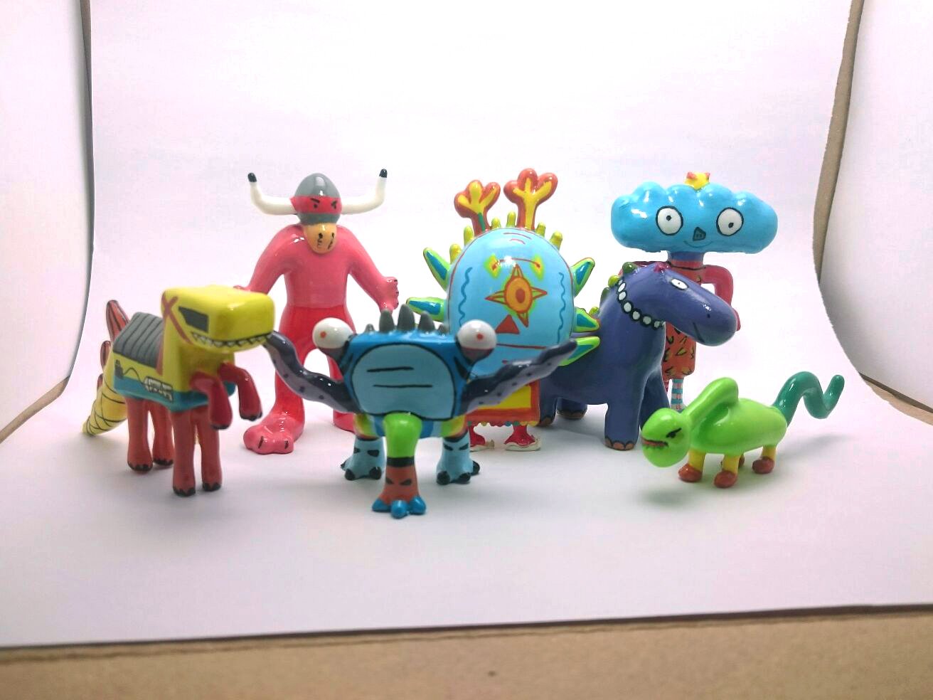

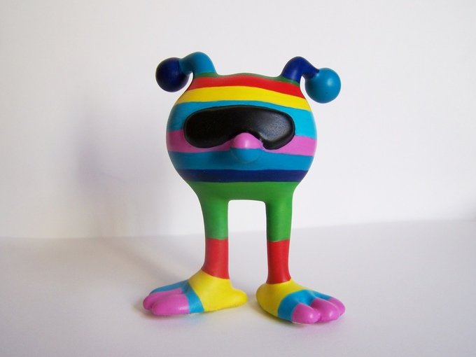

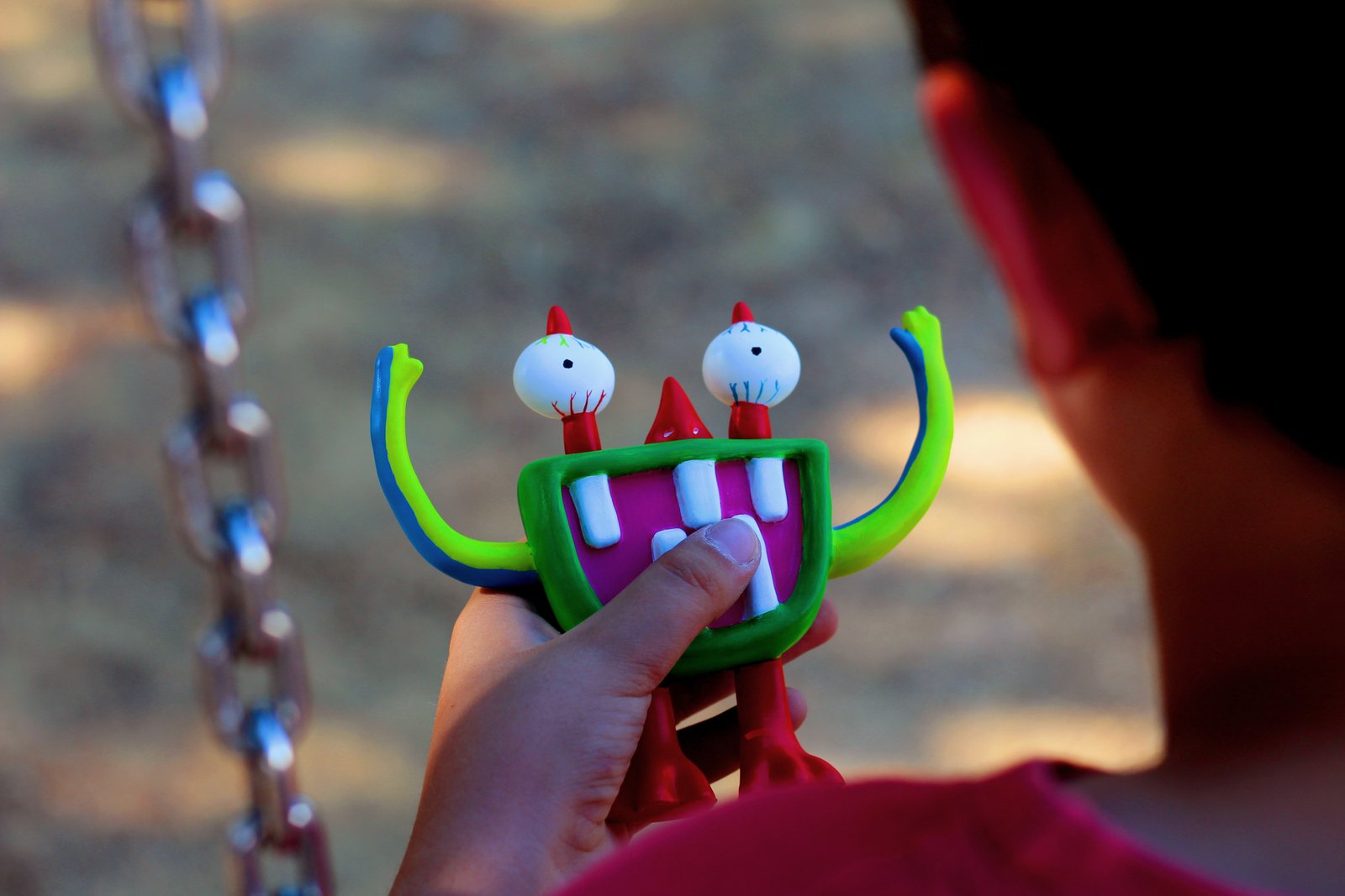

My experience is with 3D printed monsters designed by children (aka Moyupi), so nothing realistic, but in my team we used this acetone smoothing method, white plastic primer spray, acrylic paint and some spray vernish for the finish, and it worked out well. Good luck!

Thanks for the tips!.. cool owl too

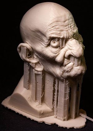

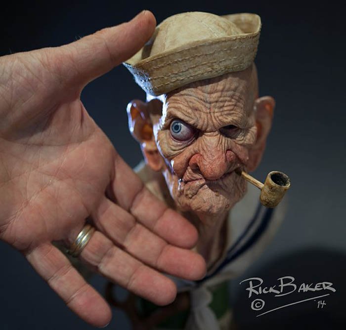

A little investigation trough Youtube brought me to this artist, Rick Baker, he also explains his creation process in the link, less detailed I think but really interesting anyway, since he works for Hollywood: http://3dprintingindustry.com/2014/02/27/hollywood-legend-brings-popeye-life-3d-printing/
