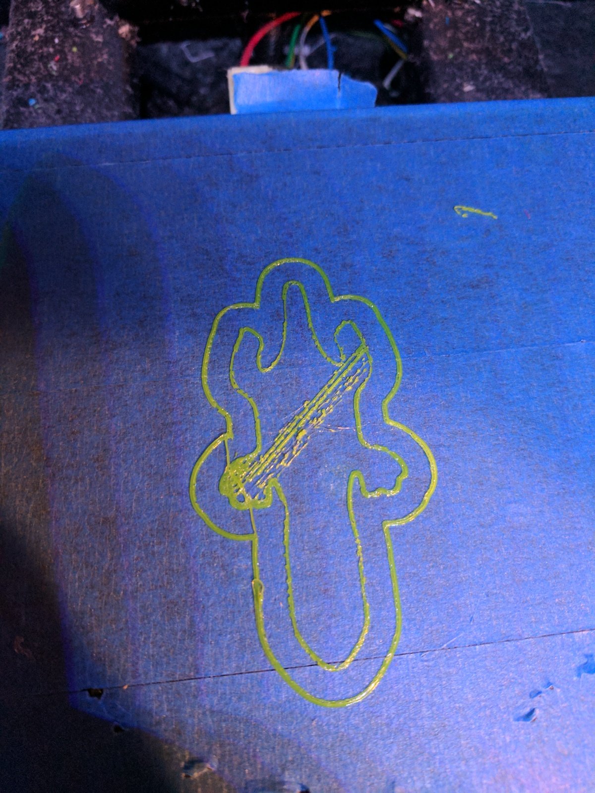

I have a flashforge creator pro, and I’m printing with Ninjaflex. I installed the custom extruder piece and have had success in the past printing things out with this filament, but most of the time, it does around half of the first layer then starts tapering off.

I just updated my post. Simplify3D does the speed setting per MINUTE not second. So I was actually printing at 18mm/sec. Any suggestions knowing that was my speed?
That may actually be kind of slow. Also look at your retraction rates.
Does it jam up when it tappers off? What is it actually doing when it stops extruding?
I got some guidance from Ninjaflex support, and changed it to 600mm/minute and I was able to complete a medium sized print with no problems.
