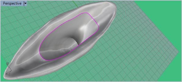

First problem is your STL is not a solid. The bottom has a hole. See attached picture. To 3D print a part you need an STL file that makes a sealed volume. I sealed it up and uploaded it. You can print a hollow solid part by changing the settings on the slicer to zero infill. The part will however have a closed bottom that you will have to cut out. If you do not want to cut it out you will need to create an inner surface offset from the outer surface and then merge that with the bottom edge. Now the bottom edge is not flat and so you will need some support. Also the part needs to be rotated about 45 to 55 degrees to make printing easy. This may cause some bottom surface distortions where the supports attach. Printing at a .3mm layer height print time looks to be maybe 5 hours or so for my printers. Printing with white would give a nice milky white appearance but transmit light well. The PLA can be epoxy coated to give a smooth outer surface, however because the epoxy is crystal clear you will still see the build ridges. Not a bad look but maybe not what you are looking for. You could add some white pigment to the epoxy to make the epoxy milky to kind of hide the build lines. Is each part of your 24 different or just 24 parts of the same design. Also does your $20 price target include finishing?.$20 for just the printed parts might be reasonable leaving all the finishing to you completely finished that would be low depending on what you want. I only have FDM machines. SLS could give you a finished part in a nice tough white milky texture. However I expect they would be more than $20 each. Have you thought of a rotomolded part? I have a roto molder for hollow balls that could make hollow horns however they would need to have the bottom hole cut out. Making a mold though is kind of expensive If you were planning on making a hundred parts it might make sense but if they are all different no way that could be economical.

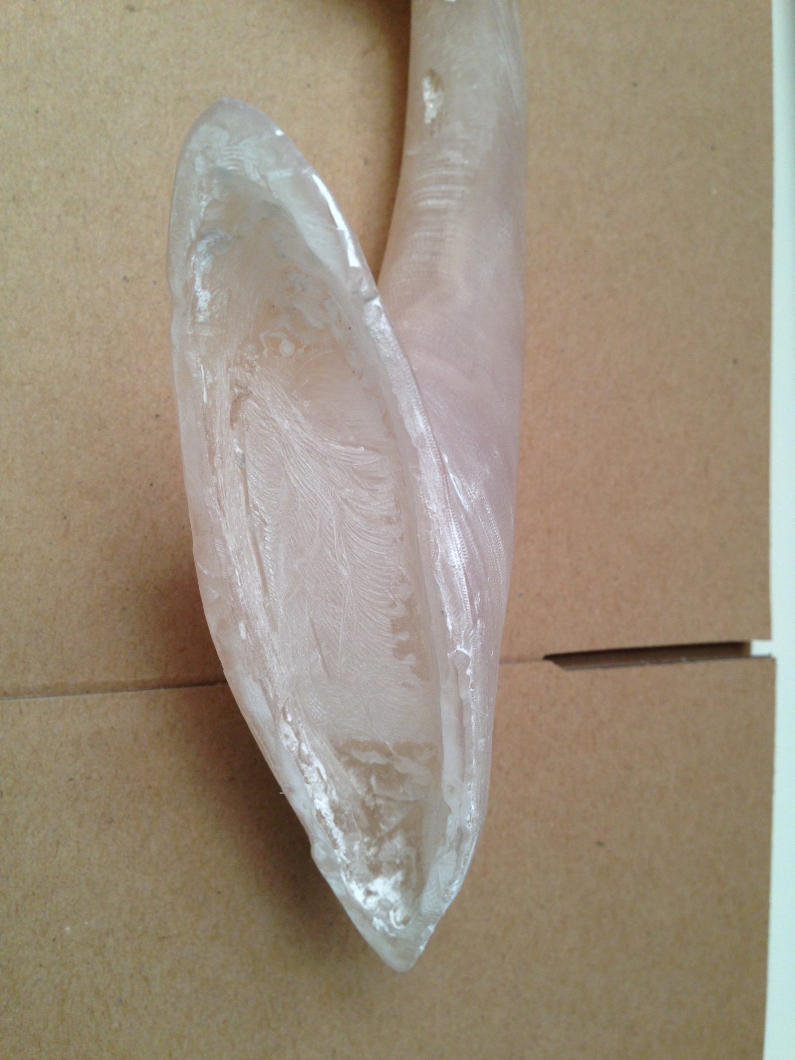

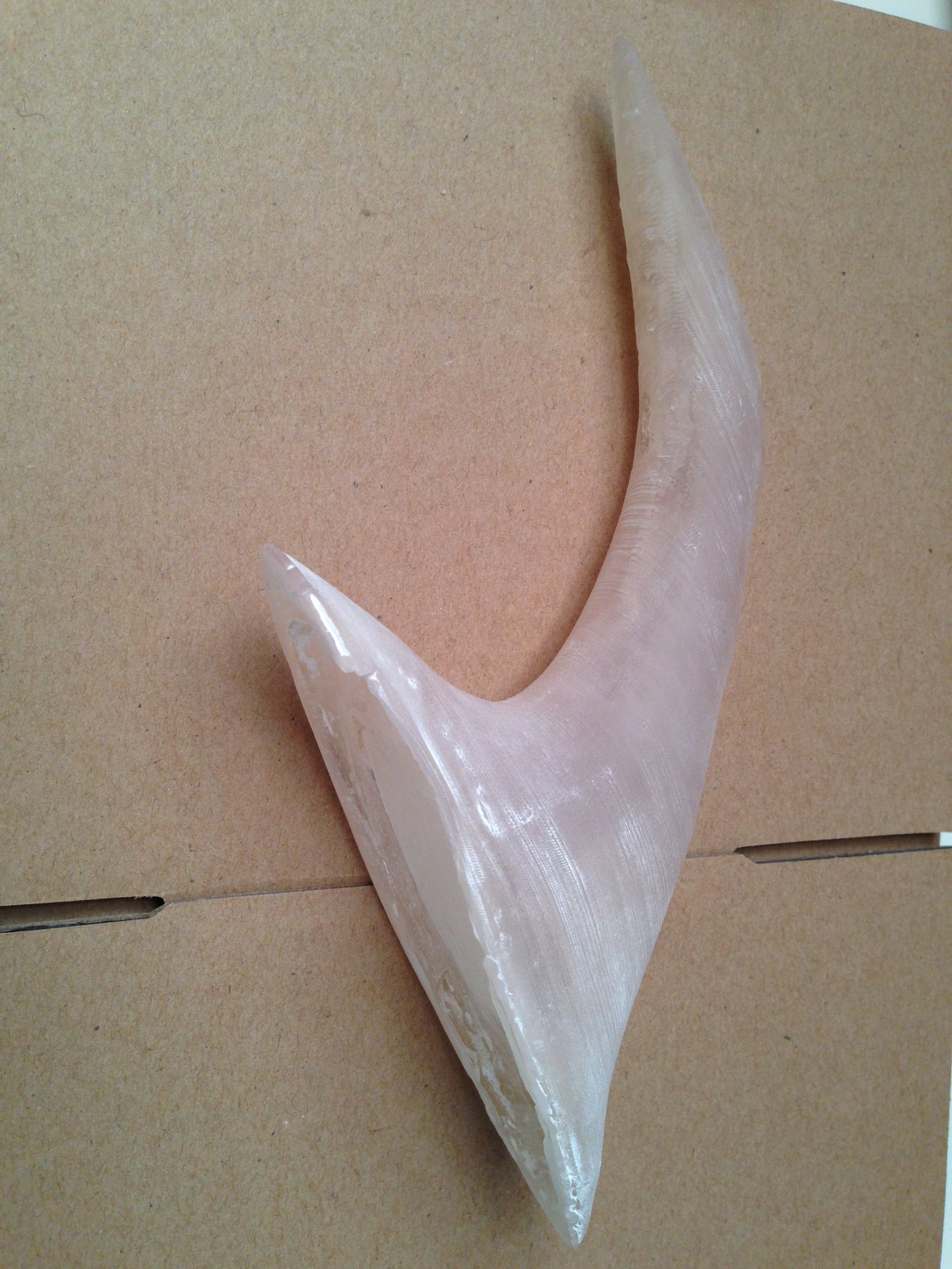

This specific model I am only going to be needing 8 of actually. The attached portion however, I will be having 8 of, and then 8 of a similar model to the attached model, but slightly bigger. So far, I have been able to find someone that was able to make me a test print of the model I originally made, and his images are looking fairly great save for a few defects due to support portions. I think it may have a filled in base like your model suggestion, which again I can hopefully just dremmel out, but I won’t be for sure until I receive the piece. This was printed using UV curing resin, and seems to have come out fairly translucent as well, and he’s recommended I can paint them with a UV curable gel as I need them to actually be different solid colors at the end of my project.

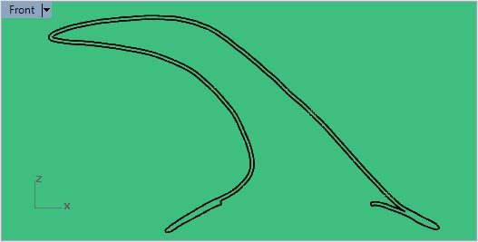

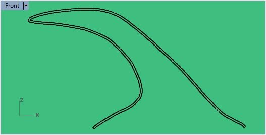

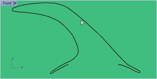

It’s possible to print with a hole in the bottom however the STL file is just a surface with no thickness. See the HornSection.jpg picture. You need to have both an inner and outer surface to establish a thickness.Like shown in the HornSectionWithThickness.jpg picture. This can be easy or hard to do depending on the software and the way the model was built in the software. In the slicer program the part can be printed without infill. The sections will be made hollow with a specified wall thickness however it needs a closed volume to work. Could your part work if it had a uniform wall and perfectly flat bottom like in the attached picture?
