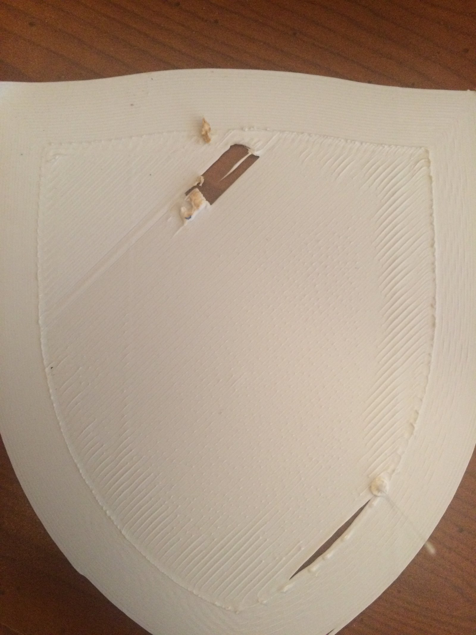

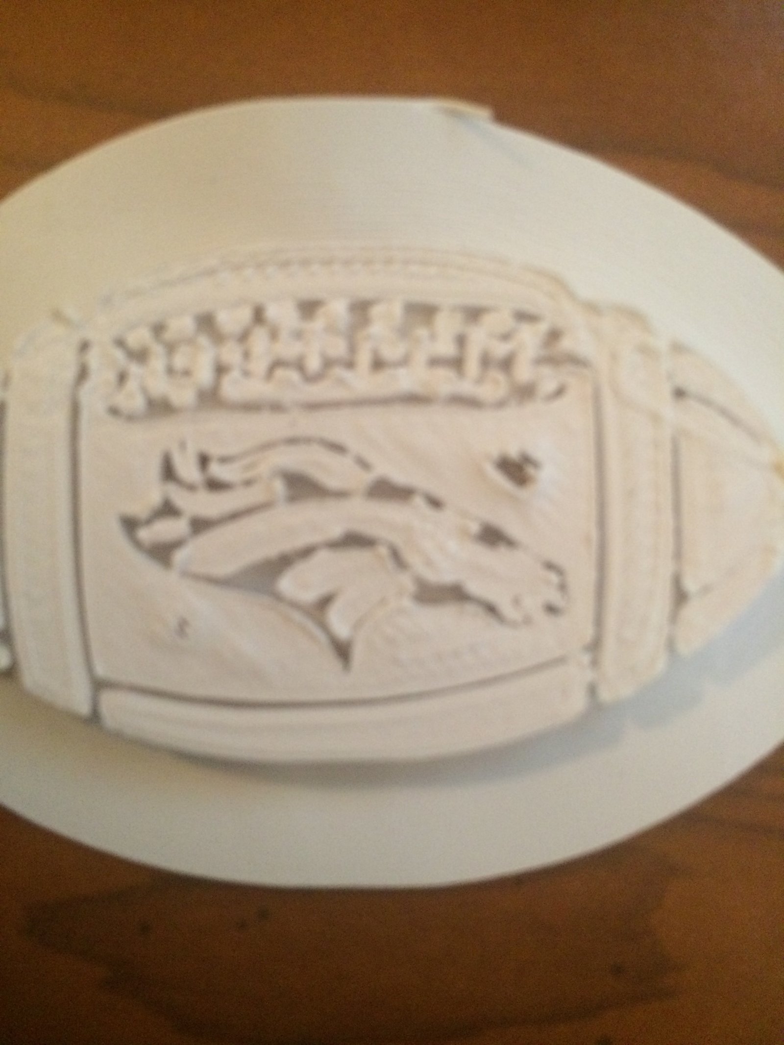

Hey are a couple. They come out spotty or blotchy

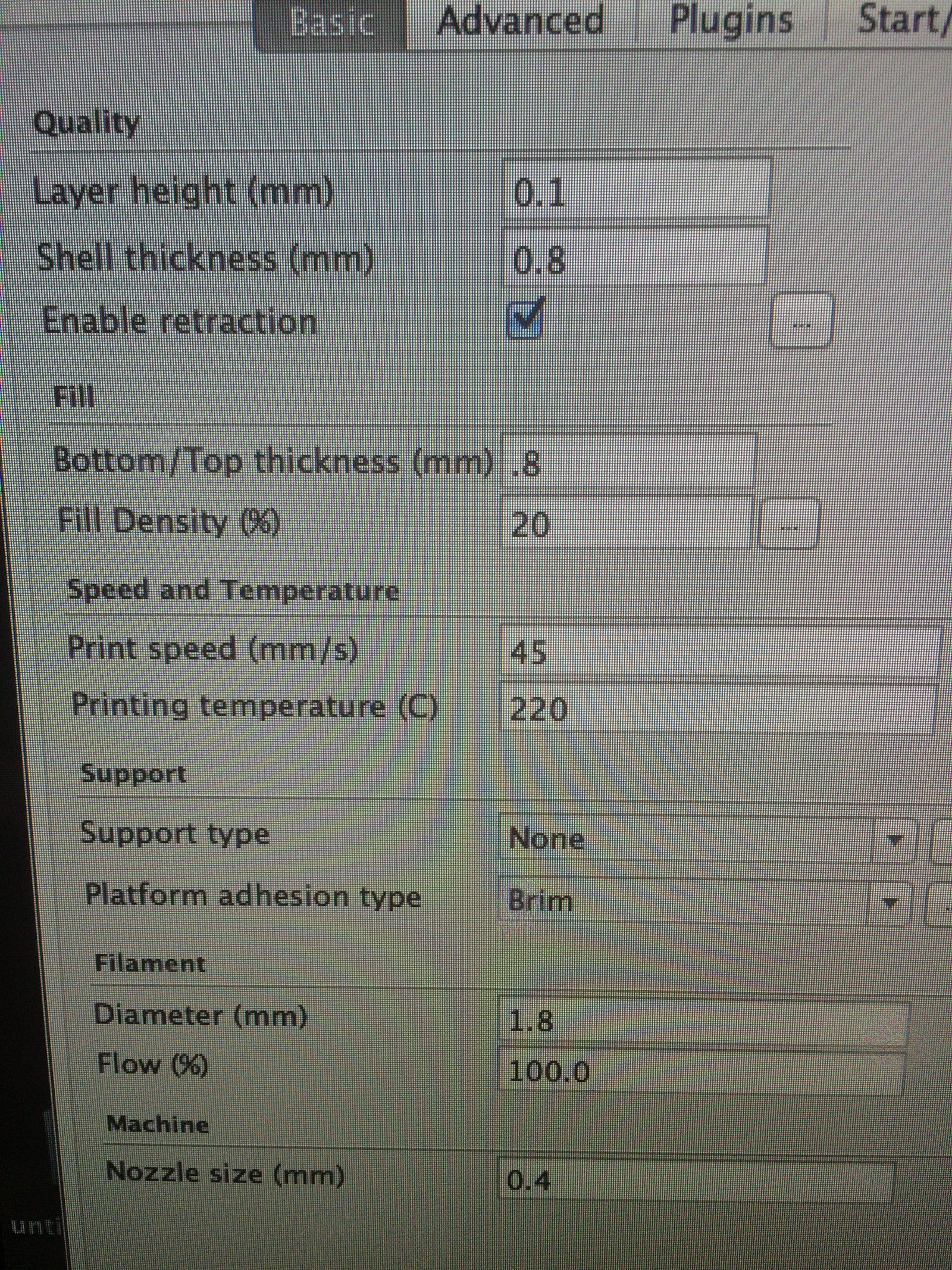

I have printrbot plus. The picture show my settings and I’m not quite sure what the slicer is

Welcome to the 3D printing world! ABS can be a finicky material. Remember it likes to print hot, and remain hot! reduce any drafts, and enclose your build area as much as possible. The above links that others posted are great reading material!

If your printer is enclosed, your extruder should be between 230-250, always start low and up your temps by about 5C. For ABS I usually keep my bed at about 100C.

I generally print ABS at 230 and start the bed at 110 then down to 100 after some layers. Not sure if the bed temp change is helping but I read it somewhere. Doesn’t seem to hurt.

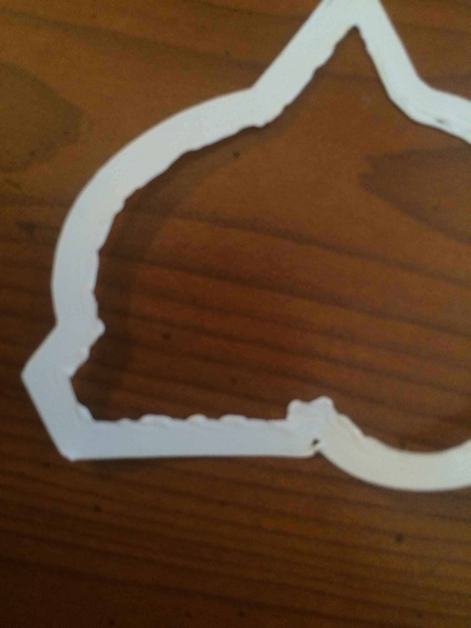

Thank you for your tidbits, I have gotten closer to a good start only this. No curling just some catching it looks like
