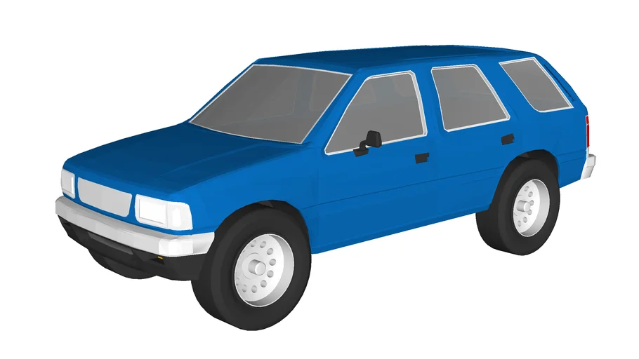

So I am trying to get a 3d printed RC truck body for a gift. I found a model of the specific car online and I e-mailed someone asking if he could hollow it out(to put on top/fit components) and take the tires off. Then I would get it 3d printed. Unfortunately we ran into a snag and he was unable to hollow it out. He told me if I could get the model hollowed out he could do the printing so I am asking if anyone knows how to do this? this is the model:

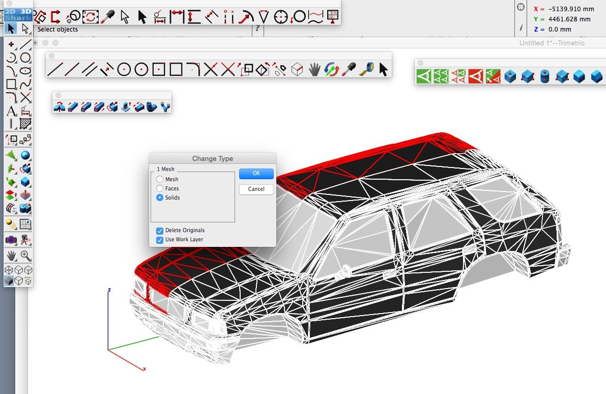

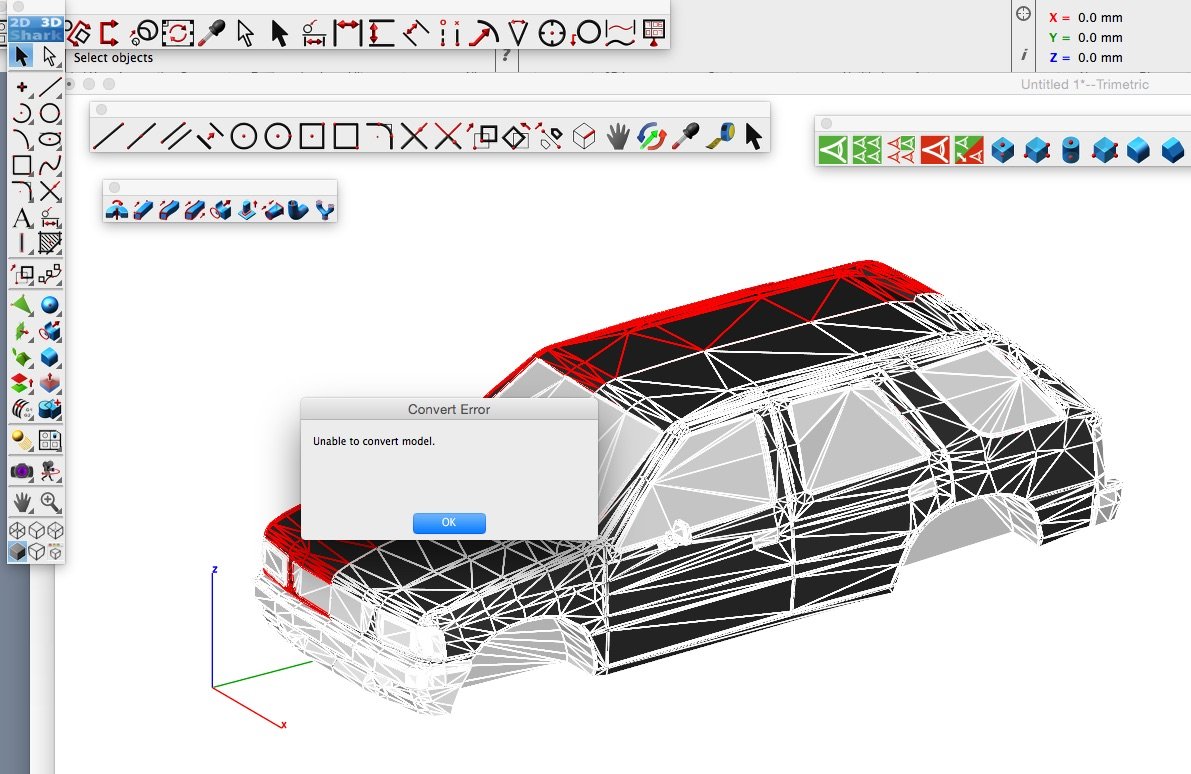

Although I can import the model in my professional 3D modelling software, it is not possible to stitch the mesh together and convert it to solid. See attached screen grabs.
The model is also very faceted, I don’t think it will give you a good final 3D print.
My suggestion would be to re-model the car and then hollow it. If you’d like help with this, please raise an enquiry via my hub https://www.3dhubs.com/leicester/hubs/designeering …we can discuss your project further there and give you a cost for the work.
