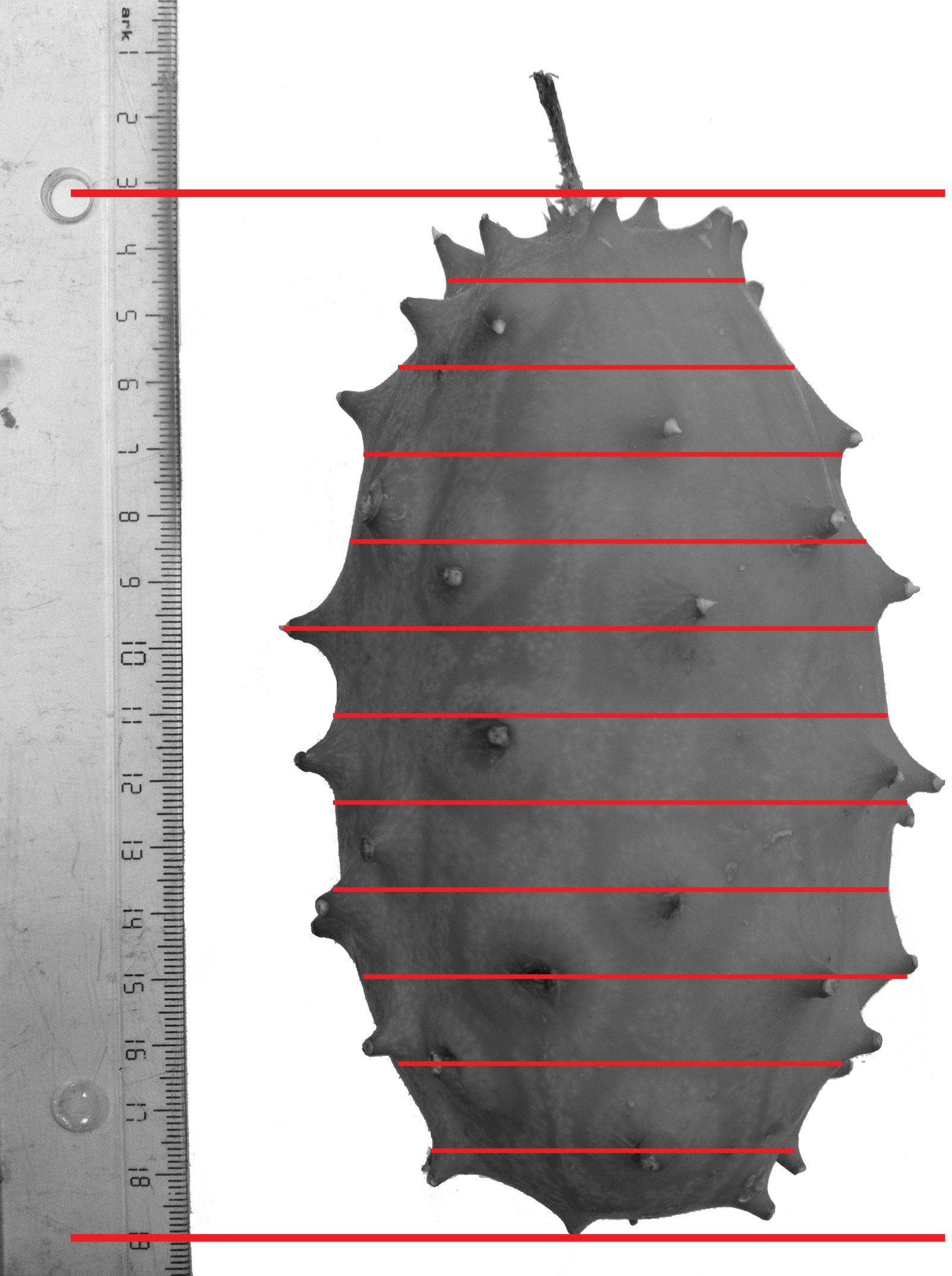

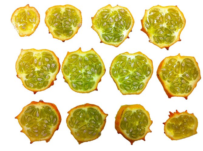

In the first part of the exercise, we had to choose how to divide and cut the fruit. I decided that the best way to do it was by cutting it horizontally. In the images below you can understand how the slicing was done, and the profiles that came out of that cut.
At this moment, I had all the ingredients necessary to start drawing on them. I started to draw some vectors out of all these profiles. I’m sorry, I lost the image for this step but I think you can imagine the experience of opening Adobe Illustrator and drawing some lines for the outlines :slight_smile: . I traced the outline of each element and its seeds as well. I didn’t know then, but I only used the overall shape and left the seeds for another project.

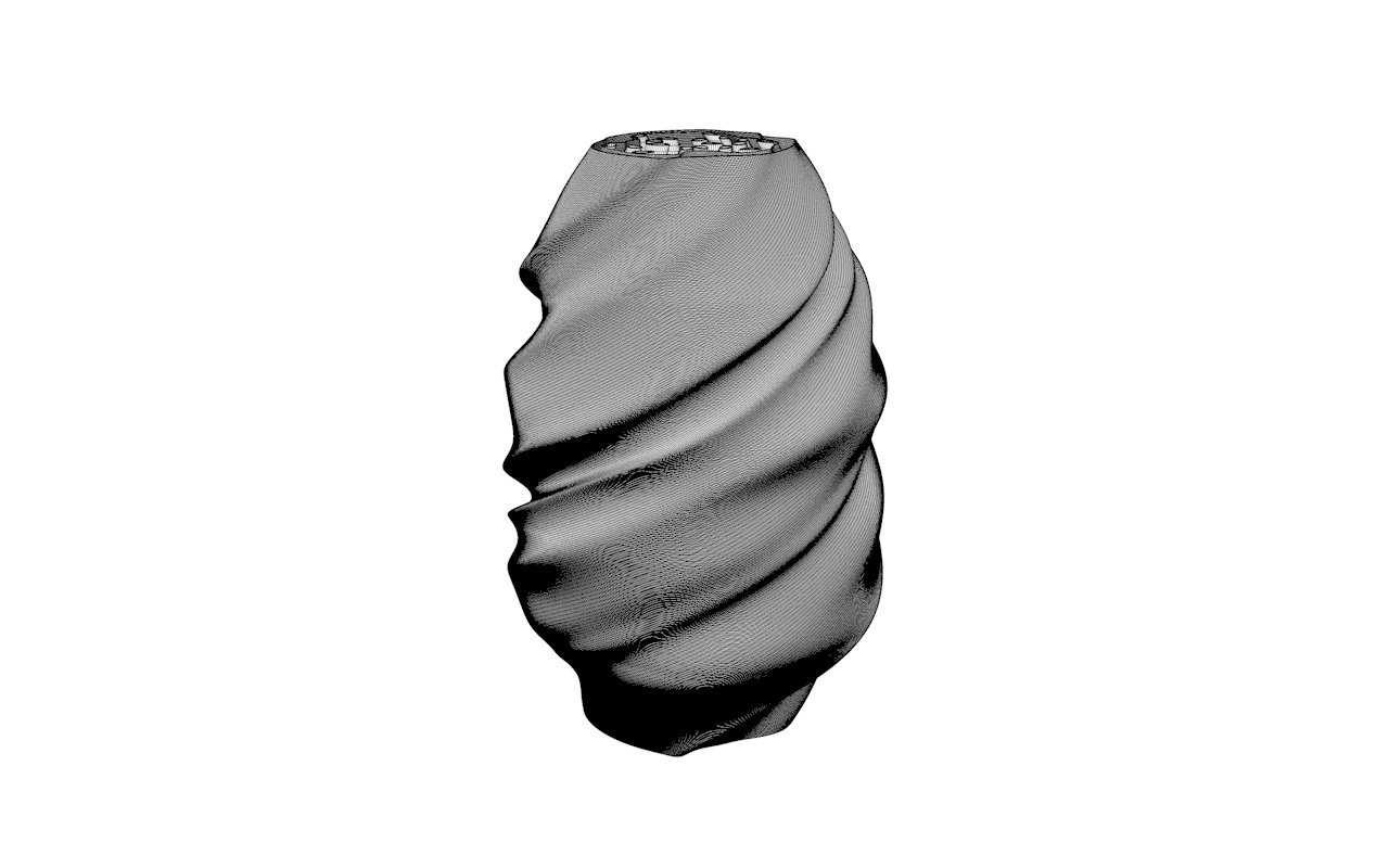

With the outlines traced, I could then start to draw some 3D shapes out of them. The process I used behind the creation of the image you’re about to see was relatively simple. iIts a loft surface created from one of the profiles repeated and scaled and rotated.
To make things funnier, I decided to give a twist on my model and this was the result:

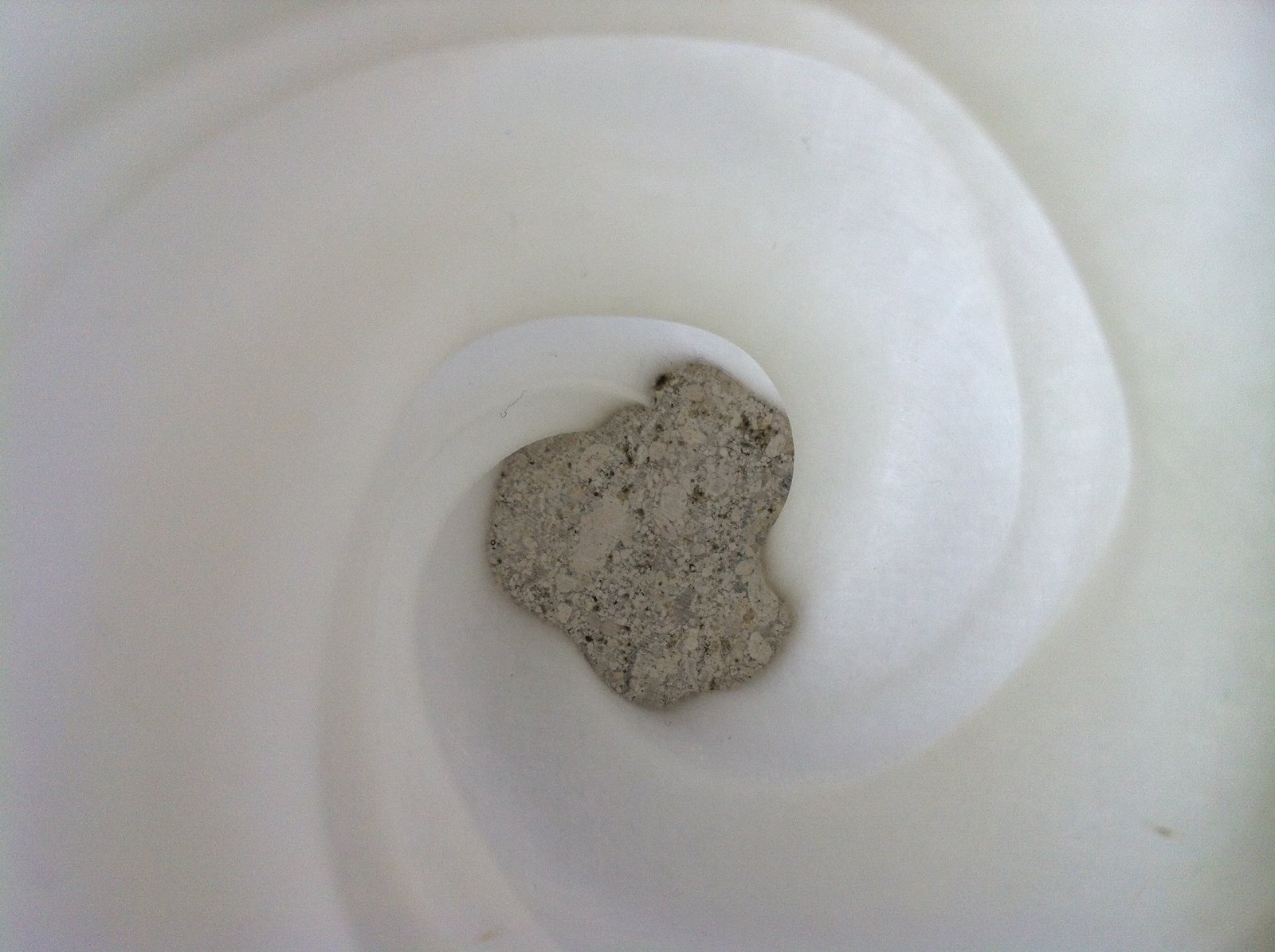

Next, there are some images of my model printed on an Ultimaker Original.
Settings
  • Print speed (mm/s): 50
  • Printing Temperature (C): 220
  • Layer height (mm): 0.1
  • Shell thickness (mm) 1.2
  • Bottom/Top thickness (mm): 0.8
  • Minimum travel (mm): 1.5
  • Minimal extrusion before retracting (mm) 0.1
  • Z hop when retracting (mm): 0.075
Filament
  • Type: PLA
  • Diameter: 1.75 mm
  • Fill density: 100%
  • Support type: none
  • Platform adhesion type: none
  • flow: 100%
I used Adobe Illustrator for vector drawing and Cinema 4D to build the 3D lofted surface. I can’t remember the exact time it took to build this beauty, but I think that Ultimaker took about 9 hours to do so, I’m not sure.
