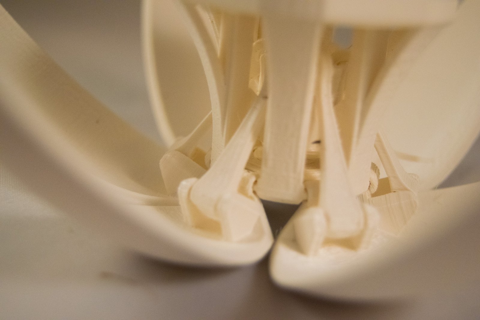

I haven’t seen this technique before, that’s why I named it so - hopefully Iam the first one :-). The concept is very simple. To create a horizontal one-piece hinge, I’ve added a small bridge of about 0.4mm right beneath the hinge. Once the hinge is getting moved, the support bridge breaks and the hinge is free to move.
See images for more detail.

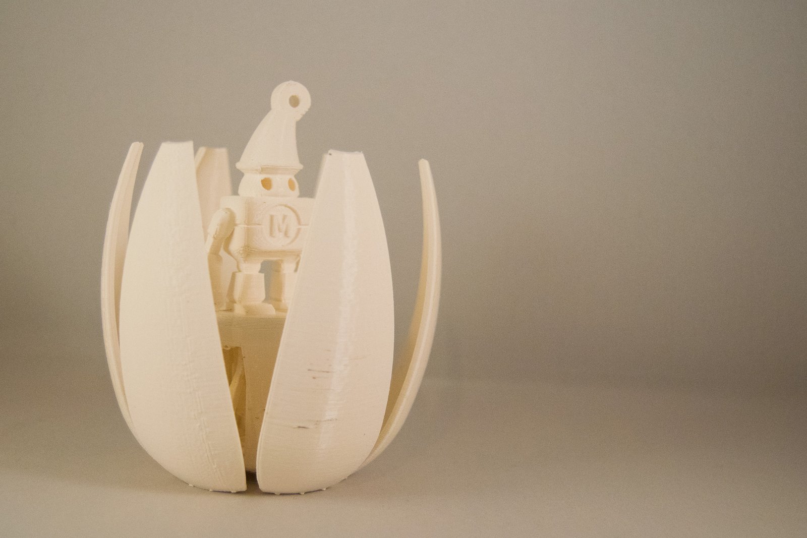

I printed it!
Very very cool.
Might need to add more strength to the little arms though. I had one break on me… (after I tried to close it oddly)
Looks like one of my platform supports broke too, it fell out of the print when I picked it up off the printer.
Wanhao Duplicator 4 / Simplify3D / Clear PLA / .2mm layer / 20% infill / 6hr print time
Pictures: http://imgur.com/a/0a867
I tried printing this on an ultimaker 2.
The hinges worked really well, but the rotating part didn’t. It didn’t come loose before breaking.
I had issues as well… took me like 2 min to get it open the first time… had to turn it slightly… and then turn it back the other way… and do this over and over until it turned all the way… Also its reversed… so you turn to the right to open it… turn to left to close it.
hi Sybren_Zwetsloo and jatmn, first of all thanks for testing the model. I’ve already modified the model, to prevent other users to have the same problems that you guys had. the turning point on the bottom has more tolerance than before. the first layer on a heated bed is slightly wider than on a printer without. I also added some strength to the joints. I did had the equipment to test it on other machines. so I’m very glad you guys did. The thing that its difficult to open the first time is very normal. the SmartBridges need to break first. This technique was the only way to get a one piece print. thanks again. Best Yves
