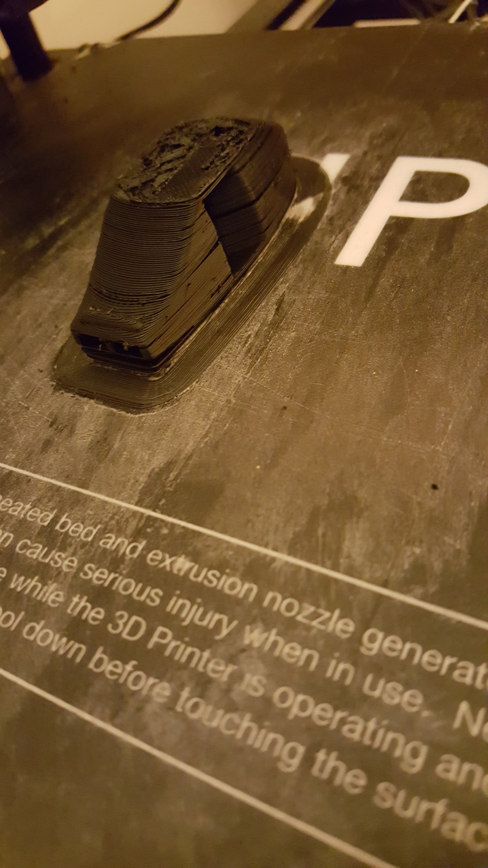

I have had all the trouble in the world with my IIIP Maker Select V2 printer. The nozzle has recently been unable to get a first layer down 100%. I’ve tried resetting the bed thinking it may be the leveling, but that hasn’t been successful. While using the heated bed I usually always have a couple corners warped which completely ruins the layering farther up the print. I usually set up my prints with a bed temp of 210C-220C and an extruder temp of 65C-70C, so still not sure where to go with temps to fix the warping. Along with the first initial layers being a problem, it seems the nozzle catches small fibers of print that are part of the support inside the print. I bounce around with 30%-50% density And haven’t found the right spot. As far as adhesion I’ve tried attaching glass, gluesticks, painters tape, and hair spray (even combining some and still failed prints). Im just praying someone has some advice because in my attempt to talk to Monoprice they want me to send the while printer back and to get a replacement. Plz help.

Personally, I would recommend using a raft. I use Cura for slicing and the automatically generated raft has completely removed warping. Furthermore, if you are using PLA, I would lower the extruder temp. I have had a lot of success with 195degrees C.
Yes I meant to say my bed temp is around 65-70 and extruder 210-215. I have been using a brim for my prints that go 5 times around. I began using rafts and they always seemed to peel up. Next time I’ll have to try using less infill because on the print I just tested it was all sorts of messed up. I did my best to level out the bed and used a glue stick and hairspray.
