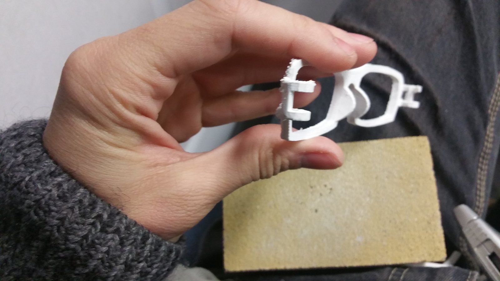

I use a FDM desktop printer and have been developing and designing glasses with it. I’ve worn them to the NYC event for 3D Hubs and got a lot of great feedback. They’re in the final stages. Included a picture of the V13 I printed out this morning. Id be more than willing to answer any question that you have. Btw I started creating them just cuz I was sick of paying for $200+ frames made in China that were breaking on me every year.
To clarify, did you mean drinking glasses or optical glasses?
Thanks for answering. I’m talking about drinking glasses
Ah a drinking glass. Still super easy to create. Not sure about making it dishwasher safe but then again there’s polycarbonate material these days (same plastic water bottles are made from). Simply design it, make sure it’s water tight, and print. I couldn’t imagine it being difficult and your really only limited to your imagination and skill.
