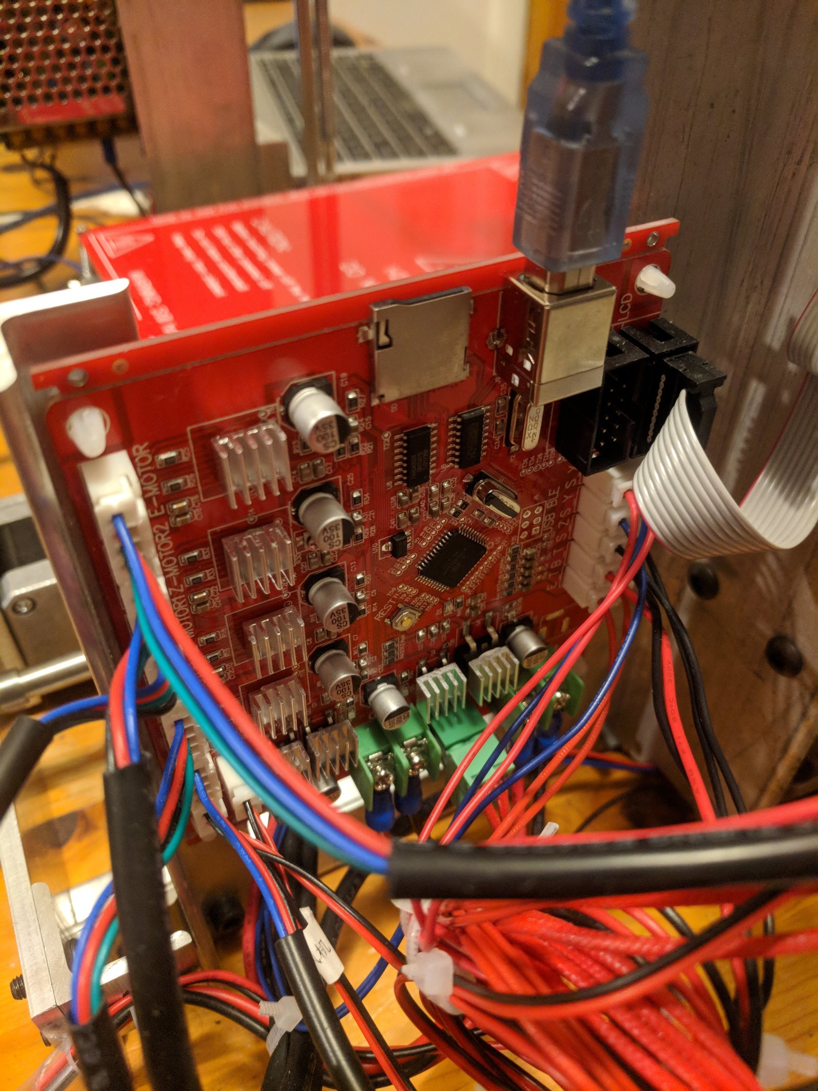

I’m trying to upload Marlin onto the controller board of my CTC i3 Pro B. It’s a cheap Chinese printer. As far as I can tell, it uses the same board as the Anet A8 (I will attach some pictures of the board). I’ve been referencing this tutorial on youtube to accomplish this:

Yes, the problem was that the bootloader was either corrupted or non-existent. I ended up ordering a USBasp and a 10-pin to 6-pin adapter and re-flashing the bootloader. It’s counter-intuitive to use the adapter, since the place on the board where the USBasp fits has 10 pins, but you do have to use the adapter for it to work. After that, everything worked just as it should.
