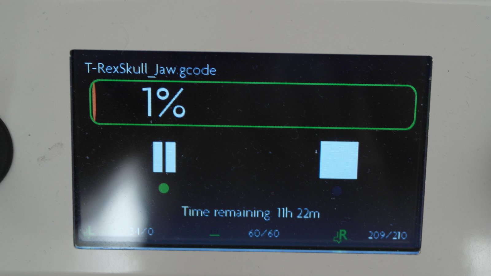

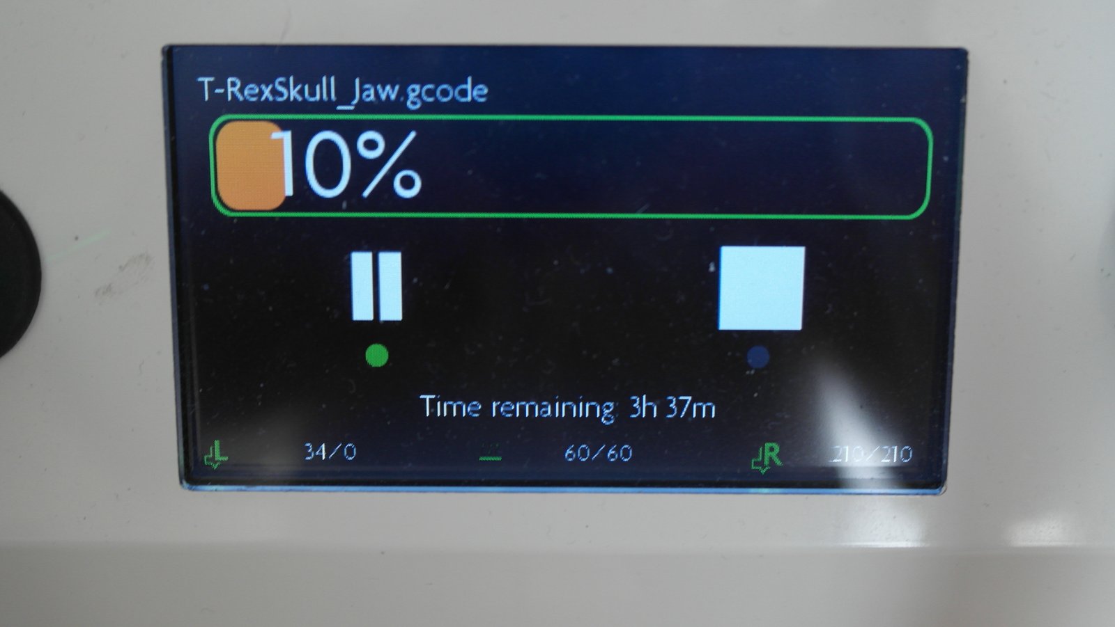

This maybe happens only Xeed which I have. A printing finish estimate time which simply 3D shows and Xeed shows is totally off. Not even close. Sometimes S3D shows 10 hours but actual printing take 15 hours or such. Usually Xeed takes long than what S3D shows, but it could be sometimes shorter. Also at the, beginning Xeed shows “calculating” at the screen of remaining time for about one hour or more. So I really don’t know how long it will take to print until I start printing.
