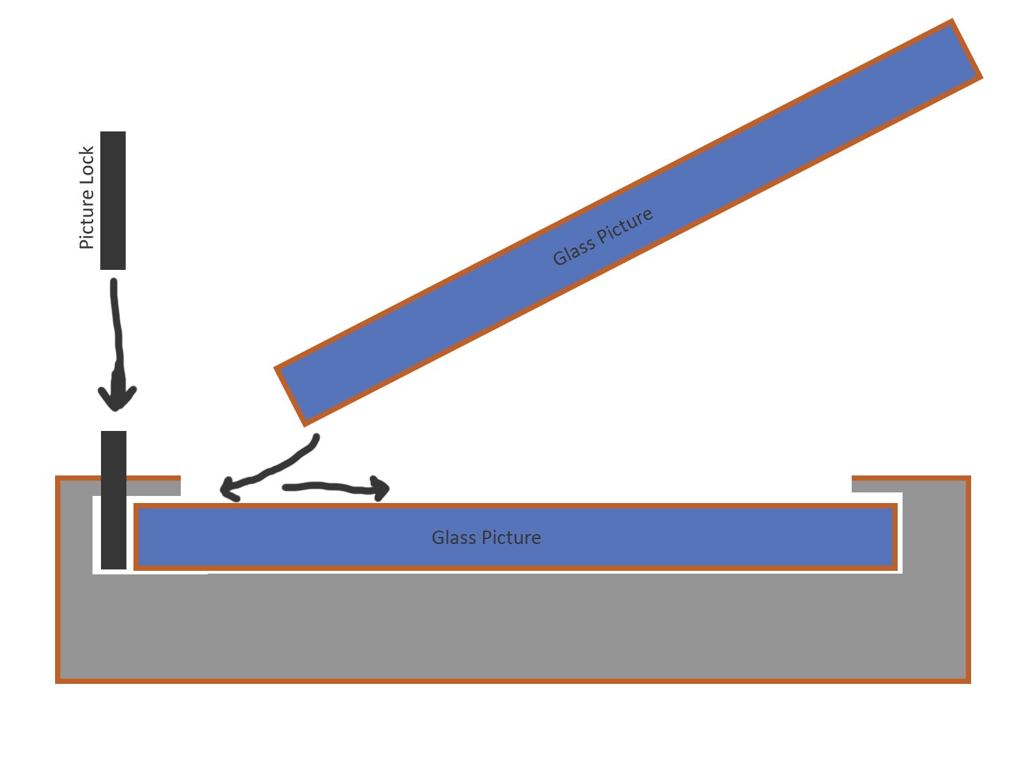

We have an L shaped sectional couch with a good sized ottoman. It is not practical to have a table and the ottoman at the same time. I’d like to 3-d print a “table top” that is also a picture frame. The idea is that the table top can hang on the wall when not in use. I’m attaching a couple ROUGH sketches of the idea.
I’d like the picture to be changeable. I’m using a service, https://fractureme.com/, to print the photo on glass.
I want it to slide over the top of the ottoman, and have a lip around the edge in case anything spills.

What you are describing does sound possible, and not even that hard to make nor design. The printed frame, depending on size will mostly be quite light as you shouldn’t have to make things to thick if the only abuse it will see is being used as a table top. I think that the printed glass will be much heavier than the rest of the thing (have you thought about using polycarbonate or plexi-glass instead?)
