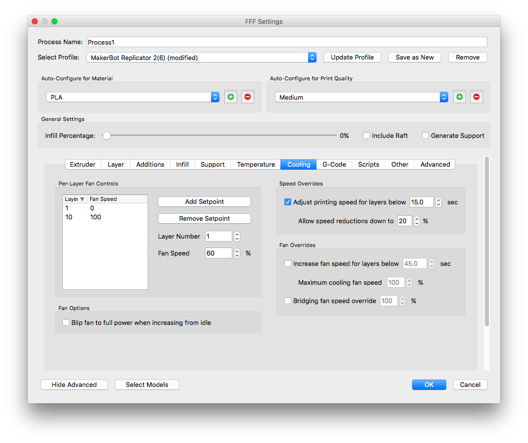

There are a bunch of option in S3D that just take over speed control, like minimum layer time.
You probably want to check these.

In @simplify3d, speeds settings are under Other and Cooling tabs in process settings (see attached).
It is sometimes useful to increase the speed overrides in order to avoid filament jams.
