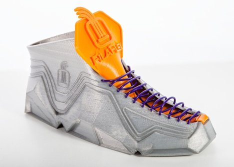

I have attached an image of what we a trying to print. Do you think if we used a 3D Printing pen the bond would be strong enough to walk in as if it was one print?
Thanks.
It would be the ONLY way to bond the parts strong enough. If done correctly it would be the strongest part of the shoe.
