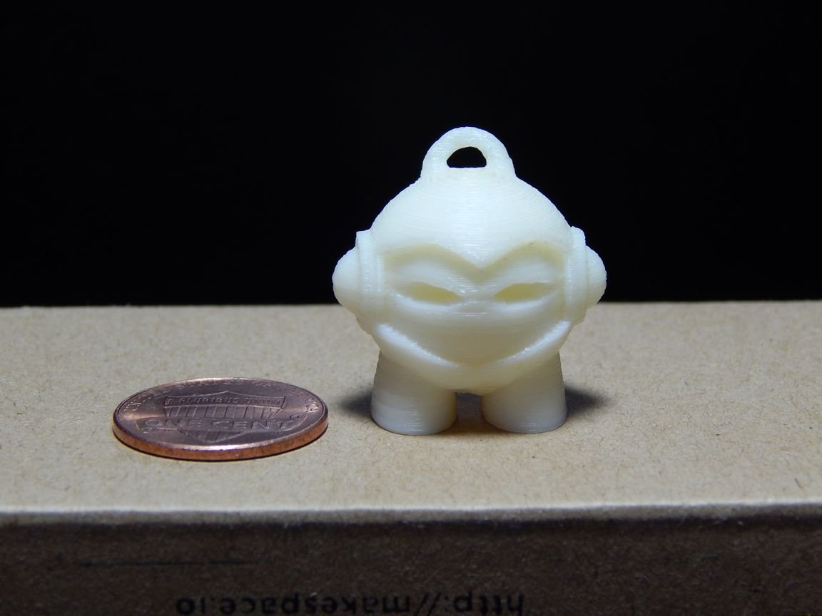

@Jozef also mentioned that DaVinci has the potential to be equal to the much more expensive printers but you may have to stick to the custom firmware. Slic3er + Reptier host can be the tools that could turn everything around. with your print.

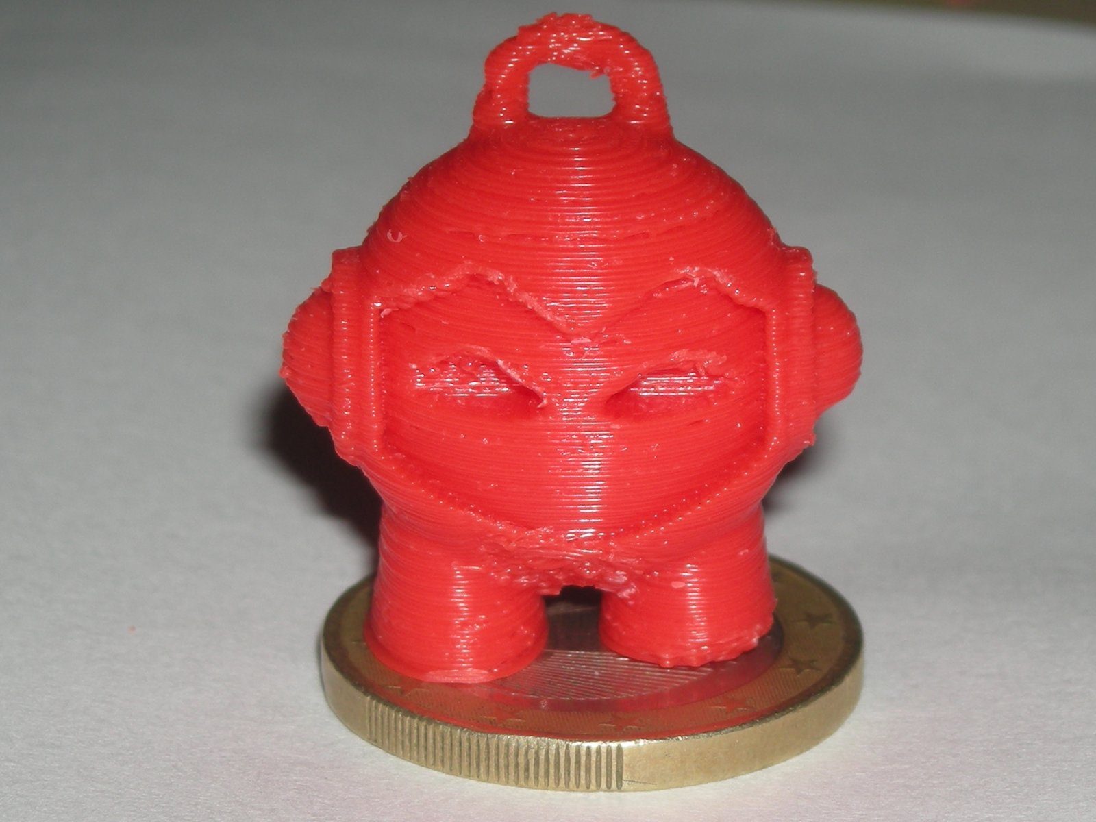

Here’s his print which is indeed quite an accomplishment!
@Andreas_15 If any other Da Vinci owners have anything to add that’d be a great source of help!
Nice community effort :slight_smile: Thanks for summing them up, Arnoldas!
Good pointers mine came out excellent just like your pic on my Davinci 1.0 A.i.o with your settings.
Cool stuff! Would you share a picture of your Marvin?

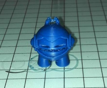

I printed a lot of this marvin but none came out good , if I use the xyz software the extruder ooze onto the print leaving dots of plastic that I have to remove when it finished printing (210° extruder and 90° plate + abs ), but if I use slic3r I can set the retraction and it doesn’t ooze , but still with 4 marvins at the 4 corners I can’t still have a good print cause the hole for the keyring doesn’t came good , in the pic is the best one till now
