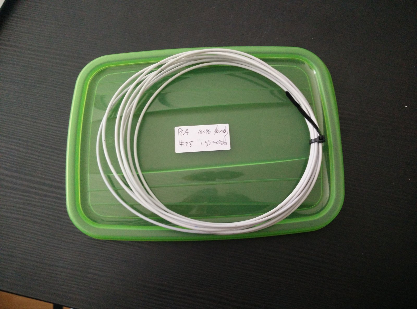

Sneak peek of fully recycled filament

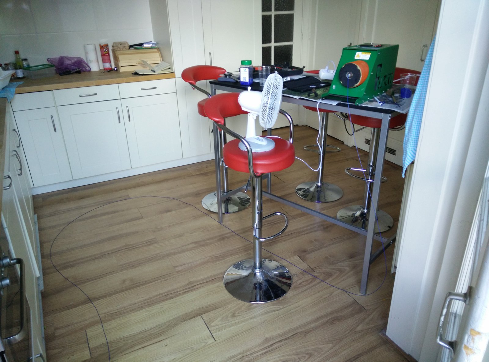

The most important thing for sure when setting up the extruder is that the filament experiences a constant pull when coming out of the extruder. In more professional setups the filament is spooled using a spooling system that measures the diameter of the filament and adjusts the pull in order to keep the diameter constant.
In a more simple setup however this is not feasible and we should look at how we can keep the pull as constant as possible. I tried to do this by placing the Filabot on a table and letting the filament drop to the ground. You can then let the filament curl op in circles on the ground. What worked for me though was pushing the filament gently to one side once it had hit the ground. After trying out many different setups I found that the one shown in the picture below worked really well for me. The nozzle of the Filabot is at 120cm from the ground and as you can see the Filabot is placed horizontally.

Power and distance of the fan
The final parameter to control is the cooling of the filament. This decreases the extent to which the filament is stretched out. So more cooling in general means a larger filament diameter. There is a limit however because you don’t want to blow the filament away too much as it comes out of the nozzle.
I used the most basic fan I could find at my local home depot (called Praxis here in A’dam ;)). The fan produced 30W power and I used it for PLA at half power. I placed it at 30-100cm from the Filabot and aimed at the filament 10-30 cm below the nozzle. The more recycled material I used in the input mix the closer I had to place the fan because the filament stretched more.
