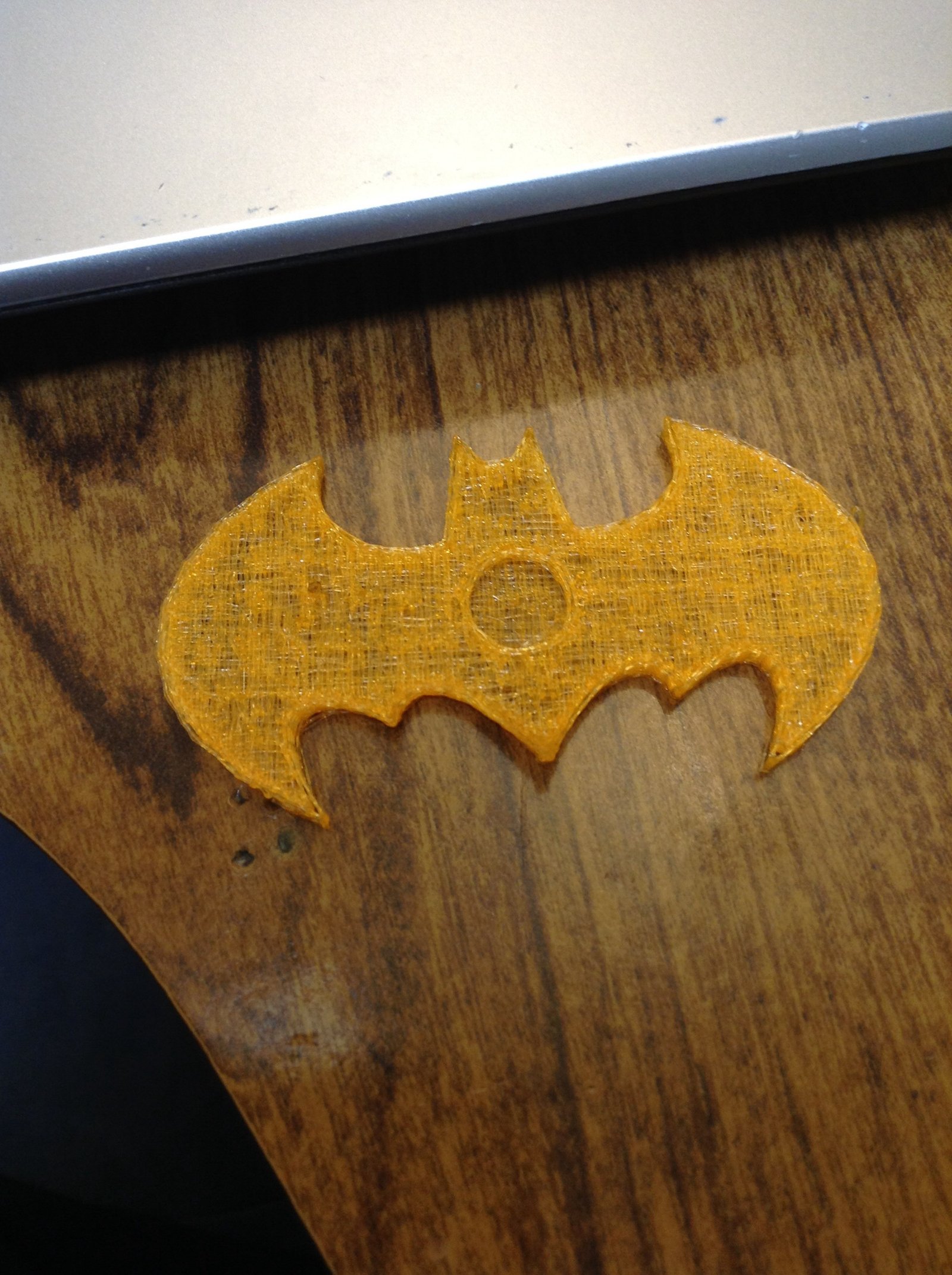

Hello Joel, my teacher had a rigidbot in a robotics class I took. He was very happy with it, and he has used it to create a ton of prototypes. I do not have first hand experience with it, but my teacher had great experiences with it. One thing to be aware of: it does not print very high quality. So it depends if you want to make prototypes or high quality sculptures. The picture below is a quick print from my teacher’s rigidbot.
3D Printed Art.

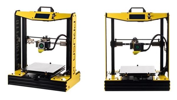

What exactly do you mean by “Adjustable Build Area”? Tell you about MY printer we hope to start our Kickstarter soon. Most machines have 1-+ extruders for printing different colors on the same part. This does not increase the speed in which multiple parts can be made. We have used our machines on high production runs since I have up to 3 extruders printing 3 parts at one time. Base with 1 extruder has an 18 x 18 (X/Y) heated build area. Adding 2nd extruder makes it 2- 9 x 18 machines, adding 3rd makes it 3 - 6 x 18 machines.
Since my machine is all components it is very easy to make it any size someone would want. With changing the frame rails can make it any dimension without changing the overall design or function of the machine.
Here is one we have in use at a manufacturing facility, it is 18 x 18 x 18 build area.

The RigidBot can print much better quality than that. I print daily at 100 microns. This looks like it just wasn’t printed well. Some settings need to be adjusted for sure.
