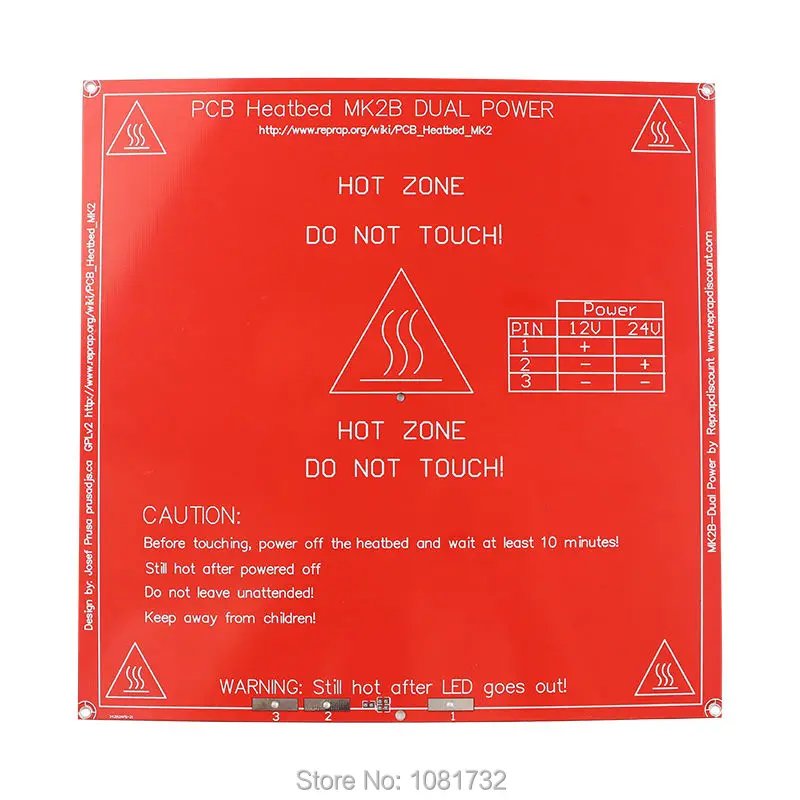

Please forget the PCB type ones they are slow and need a strong DC powesupply.

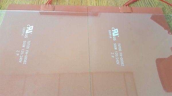

I did an experiment to see how even the heating would be with just two smaller rectangular heaters under glass. I started by first checking their resistances to make sure they are the same. These two pictured are ~114 ohms or 57 ohms depending on how you wire them. At 114 ohms they are different by 1 ohm. Not too shabby.
silicone_heater_glass_test
The silicone rubber heaters used in these experiments are stamped ‘Tutco’ but they actually come from a different but related heater manufacturer, Farnam.
Using a variac I fired them up with 60V. The temperatures on both sides are comparable. Regions across a single heater are a little different at first and those differences appear to be mirrored in the neighboring heater too. It doesn’t take log for the heat to even out across the surface. One notable difference is a ~6degF drop at the seam. These particular heaters seem to have a respectable distance from the heating element to the edge of the silicone rubber. I inquired with the manufacturer and I’m waiting on a reply to find out how close the heating element can be manufactured to the edge of the heater.
It would be informative to do this again using a thermal imager with a color screen.
I also wonder if different sized round heaters with a center cut-out would work. They could be concentric with one fitting inside of another. Starting from the middle, more or fewer heaters could be fired depending upon the working area.
I heard back from the silicone heater manufacturer concerning how close the resistive element can be from the edge of the silicone rubber heater. Typically they design the traces to set back from the edge .125”. Occasionally for 120V heaters, they have reduced the set back from the edge to .094” to enable a longer circuit length. That would result in a much smaller distance between outer-edge traces at the seam of two heaters. With a glass bed I imagine the temperature would be fairly even. If I can get ahold of two heaters with a small edge set back I’ll do a test.
