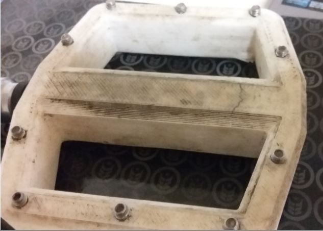

Hello, iam trying 3d print bicycle platform pedals with FDM technology
iam looking for best material with break resistance, strength
i printed first one with ABS, after 6 months of riding it survived some impacts from rocks and roots, but last week it cracked - see attached picture
but overally it wasnt so bad result, had some issues with warping (printed with 80% infill to reduce litlle bit) and had to do some extra drilling to be able fit axle and bearings
iam about to print another one with PETG (got hands on this filament, so want to try), but idk if i can expect better result, but i guess it will break even more easily
any suggestion what material should i consider trying 3rd ??? was thinking about Nylon 12 or PC, what do you think would be best ? (from these 4 materials, or something completely different ?)

PC is the best under stress.
Maybe theres an insert or other piece of hardware you could implement where the crack appeared and print the next pedal reinforced where it needs to be.
petg . form futura titan x . form futura carbonfil. hips. nylon all high impact
